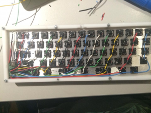

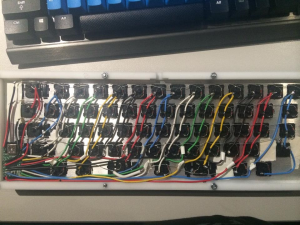

So I recently rewired my custom keyboard (the wires I was using previously were too thick) and now I'm running into some problems.
Initially I rewired the columns like this:
79325-0
Then re-did it to make it look like this:
79327-1
Here's what's been happening:
Initially when I did the first rewiring this is what happened:
When I press grv it says that I've pressed grv + tab
When I press 1 it says that I also press grv + tab
When I press 2 it say I pressed LCTRL (I placed the LCTRL where caps lock usually is
When I press 3 it says I pressed LShift
When I press 4 it say I pressed the LWIN key.
Then I rewired it (the second pic) and the same thing above happens except for when I pressed grv it says I pressed grv and when I pressed 1 it says I pressed tab only - everything else stayed the same. I then attempted to rewrite the firmware since I suck at reading the code and finding my mistakes and when I finished doing that, it improve a little bit.

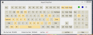

Here's a pic of the keys that registered after using the newer firmware:
79329-2
The majority of the keys are jumbled up and the only one working as intended are the Enter, semi colon, O and S keys. Everything else is either jumbled up or not working (interestingly, the GRV, 1, 2 and 4 keys no longer register as anything despite it registering with the older firmware). I am absolutely lost right now, since I have no access to a multimeter at the moment (I'm planning to get one soon) I cannot check the continuity of the columns and rows and check for shorts. Whilst I plan to get a multimeter for the hardware aspect if any of you could check through my modified code to find any silly mistakes that I've made (I think the way I wired up the matrix has confused me) I would be extremely grateful.
Here's the matrix of how I hooked it up to the teensy vs the real life picture of it(please note that the real life picture is mirrored to the paint version so the side where the teensy is the side of the ENTER key):
79331-3 79325-4

When you want to use PF4-PF7 as IO ports you have to disable JTAG function. Check datasheet and these codes.
https://github.com/tmk/tmk_keyboard/search?utf8=%E2%9C%93&q=JTD&type=Code
And add thse lines at matrix_init() to enable matrix debug print. See if your matrix works as what you expect.
Code: [Select]
debug_enable = true;
debug_matrix = true;
Offline Moralless

Hello, thank you for your help, it has improved its usability a great amount, but it still has a few problems. Since I am very very inexperienced with programming I could only understand some of what you said, with a quick google search I learnt what a JTAG function is but I don't know what you meant by the datasheet (I google'd jtag datasheet atmega32 and found this but it didn't have anything on the F ports.
 Also I looked at the link you posted and couldn't really understand what it did so I just chucked the code under keyboard/phantom/matrix.c and the 2 lines of code in your comment into the void matrix_init(void) in matrix.c:
Quote from: moralles
    MCUCR |= (1<<JTD);
    MCUCR |= (1<<JTD);
    // initialize row and col
    unselect_rows();
    init_cols();
    // initialize matrix state: all keys off
    for (uint8_t i=0; i < MATRIX_ROWS; i++) {
        matrix = 0;
        matrix_debouncing = 0;
79336-0
After I did this I compiled it again and installed it onto my teensy and I went on aquakeytester again. Row 2 (going by my matrix) was working as intended from the left control registering from the caps lock to the enter key registering as enter. Row 1 and Row 3 seemed to be switched as tab is registering as right shift, and right shift is registering as tab. However as you can see from the image, majority of the num row isn't being registered, the only Fn button that works is print screen and GRV/esc. Also when I start typing with my other keyboard (corsair k65) the majority of the keys on my custom don't register anymore until I unplug it and plug it back in.
« Last Edit: Fri, 10 October 2014, 08:21:39 by moralles »

Datasheet of ATMega32U4 has explanation of how to disable JTAG function. (26.5.1)
http://www.atmel.com/Images/doc7766.pdf
In the end you need those two lines in matrix_init(), you did right. Now you can use Port F as normal IO ports.
And TMK FAQ has an entry about this.
https://github.com/tmk/tmk_keyboard/wiki/FAQ#using-pf4-7-pins-of-usb-avr
I guess you have problems on your matrix wiring, matrix code or keymap code, perhaps all of them. At first you have to see how your matrix works you can see debug print of matrix array with 'hid_listen' command.
Check your Makefile has these two lines and which are not commented out.
Code: [Select]
CONSOLE_ENABLE = yes            # Console for debug
COMMAND_ENABLE = yes            # Commands for debug and configuration
And run PJRC's 'hid_listen' command on your Windows command prompt, you wil see current status of matrix array. This will be helpful to debug you matrix wiring and code. (PJRC is manufacturer of Teensy board. you can download the command there. https://www.pjrc.com/)
Code: [Select]
r/c 01234567
00: 00000000
01: 00000000
02: 00000000
03: 00000000
04: 00000000
05: 00000000
06: 00000000
07: 00000000
r/c 01234567
00: 00000000
01: 00000000
02: 00000000
03: 00000000
04: 00000100
05: 00000000
06: 00000000
07: 00000000
r/c 0123457
00: 00000000
01: 00000000
02: 00000000
03: 00000000
04: 00000000
05: 00000000
06: 00000000
07: 00000000
