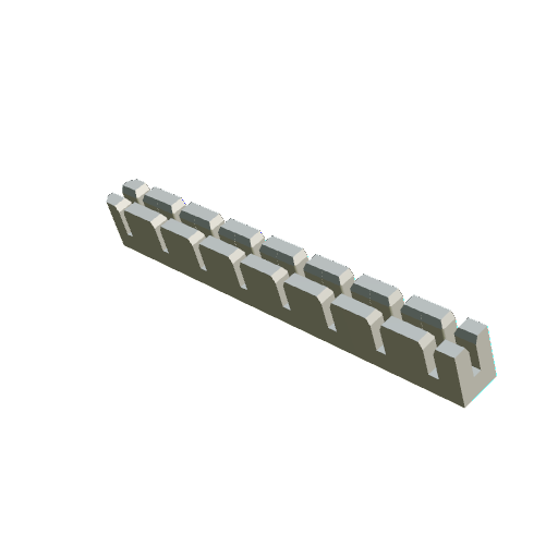

I'd start with getting the tolerances right.
Depending on whether the operator chooses to print the parts with the roughness outside of the model, inside or with average height on the boundary, slightly different dimensions is required for ideal fitting between stem and cap. Because of this, different hardness of materials, different roughness of the gripping surfaces, printing orientation and such,  differences between machines and processes, it is a good idea to test the stem tolerances first.
Klick the image to view it or here to download an .stl
The part above has stem fittings with the following dimensions, starting at the end with the extra chamfers:
0.95 x 1.15
1.00 x 1.20
1.05 x 1.25  <<< Measured stem size
1.10 x 1.30
1.15 x 1.35
1.20 x 1.40
1.25 x 1.45
1.30 x 1.50
(All dimensions in mm)
Edit: Below is an old image of a similar part I once made. It is just to give a better idea of what it might look like and how to use it:

My first attempt to print a fan duct/holder. The print could be actually usable if I would not make a mistake a make it by about a millimetre smaller :-D
Anyway, I wanted to ask about your experience with printing slopes. The bottom part has a small piece which is almost horizontal (slope angle almost 0°) but it turned out much better than the upper part. The upper part has the minimum slope of 20°. You can see a burned plastic in the picture of the upper part and irregular surface. Pictures of both top and bottom part were taken from an angle which shows the part the worst print quality. The parts were already cleaned up a bit.
There was a difference in the way the parts were printed.
The bottom part was printed as a solid without infill and bottom/top surface. The bottom part model did not have the "hole", i.e. it was not isomorphic with toroid. It was done so because FreeCad/OpenCascade does not support "thickness" action on more complicated shapes yet.  It was kind of like spiralize mode.
The top part was printed as solid with 20% infill and both bottom and top surfaces. Well the 20% infill almost does not make sense since the printed solid is almost always very thin to allow for any infill.
All the printing was done with 0.1 mm layer height; material was ABS. There was a static external fan blowing a bit at the part. The fan is needed. It was too near in the case of the top part print. That led to delamination (thanks Leslieann for pointing that out) which was repaired with acetone. Repaired clumsily; I spilled it over bigger area of the printed part ... which is why it is so shiny sometimes.
What is your smallest slope angle you can print reliably and at what layer height, material? Assume at least 2 cm wide slope. Any tips how to print small slopes well?
« Last Edit: Fri, 31 January 2014, 13:36:37 by vvp »

it looks like you have some polymer degradation there (the discoloring). that might explain why the upper part came out so sickly looking. have you measured your nozzle temps? i think what's happening here is that the nozzle is closer to the bulk of the upper part because of the low slope (it's just circling round and round for however long) and your nozzle is 'burning' the pla.
i went to a 3d printing "world expo" today. it was very depressing. i'm going to think about this a bit before i start drawing, but i suspect i will be trying to design an open source x86-based filament extrusion printer with specs suitable for geekhack-level production of parts. large build area, brute force will be the word of the day. this may start with some work on the ggppll such that it comes into being first.
thought will be applied before money, but there is quite a bit of talent on the board that is not NDA'd, and a standard commodity platform removes many of the dumb restrictions and adds a huge number of kernel options as well as a much faster bus than any of the embedded platforms i know of. i see this as a relatively long term project, but one that runs in stages. the first stage will be to move to the x86 platform (but i very likely will be powering the same motors and actual motion hardware). the second stage will be to design a new frame, then a new motive geometry, and so on and so forth.
i saw literally every trick in the book in the printers on the floor and none of them were enough to make something durable, reliable and consistent. one simply has to recognize the problems involved -- motion control, power control, mechanical repeatability w/rt material choices and previous, and apply basic principled engineering.

Yes, the low slope parts have thermally degraded plastic and also rough surface. The temperature should be ok. It was ABS. Does PLA work better for low slopes? It probably should since it does not have such a problem with contraction while it cools down.
I think that the problem is mostly in the slicer (I used Cura). It tried to print the 1.5mm thick wall of the low slope area by printing first the external and internal perimeters and then zing-zagging between the perimeters doing 100% infill. (The infill was set to only 25% but the wall is thick 1.5mm which is less than 2 times the shell thickness. Under 20° slope it looked like 4.3 mm wide area of 100% infill.) That does not look like a good strategy for sloped walls because:
  • the outer perimeter is not well fixed (there is not enough material there to hold it securely in place);
  • heat from the head creeps into lower layers making them prone to bend;
  • because of zing-zagging the whole top surface is melted at once;
  • then when head moves to other place the melted ABS will shrink a bit and curl outer perimeter into the part (above the last layer plane);
  • the next time the head goes over this area the parts of the curled plastic stick to the head and thermally degrade on it;
  • not only the plastic get burned by sticking to the head, but it is missing to support the next layer too.
Slicer should detect these situations and instead lay filament on these parts by extruding it only in parallel with the perimeters and with sufficient time for previous thread to cool before laying down the next one. The idea is to prevent having the whole top surface of the sloped wall melted at once and hence minimize curving of the outer perimeter which is not supported well from below).
The more I get involved into 3dPrinting the more I think the printer themselves are quite good (well, at least the old Rostock). That cannot be said about the slicers. They suck. All of them.
Looks like you want to do a new controller board too. Isn't SmoothieBoard quick enough? If not then BeagleBoard with some shield should do. Also there should not be a need for a lot of computing power on the controller board. Since a big part of the current 3dPritners are open loop (all the stepper control is open loop (temperature control is closed loop)) then you do not need to do much in the printer itself. They only need to know when to increment/decrement a stepper. Everything else can be done by the slicer which can run in a comfortable and powerful PC. Then you have a compression problem how to move the data from a slicer to a printer efficiently. We use G-codes currently. But maybe it would be better to use NURBS curves, or some other compression scheme.

re: that part of yours vvp, it looks thin enough that you should able to tell cura to shell it with a high number of layers (like 4-5) with 0% infill.. that may keep it rotating quickly enough to not burn anything up. this may also point to an issue with your head thermocouples..
i will say that i've had issues like this with the makerbot slicer and i usually hack up some workaround like a sacrificial tower or something. the algorithms are pretty broken, but i will say that they're no more broken than any other gcode compiler i've seen.
« Last Edit: Sun, 02 February 2014, 19:14:29 by mkawa »

Good point! Slic3r can have shell count specified and that may be enough (or I can add support there).

The idea with multiple perimeters in slic3r did not work. It still printed it too quickly so it did not have enough time to cool. Increasing air flow did help a bit. The part is not very nice but it is usable.

this one looks a ton better.
can you not lower your nozzle temps at all? also, this is a little counterintuitive, but try making the walls thicker. more plastic to sink the heat and the head's going to run a little cooler since it's pushing more plastic through.

It is definitely better. Moreover picture of this one was not taken after "shaving" off the worst irregularities (contrary to the previous one). Everything the same as the old print. The only difference is higher air flow when the 20° slopes were printed and smaller air flow during everything else. I believe thicker walls would help but only a bit. The leading edge on the low slope will still have weak support. The trailing edge should look much better. But this one is usable as it is. So I leave it out as it is till I do not need to redo it because of something else.
Low slope areas need a lot of cooling otherwise they bend (since the support from bottom is weak), stick to the head more and burn. On the other side well supported areas can delaminate if they are cooled a lot. Varying cooling is not good though. It is visible on the walls which are vertical.

yah, you can see the shrinkage patterns.
had i been printing this, i very likely would have printed it in two pieces. the bottom section built straight up as kind of a cardioid originating on the plate and then the elliptical bit from the flat bit up. brush a bit of acetone on the sections and press together and abs will join quite cleanly with an adequately strong bond for most purposes; flanges would make it easier to join as well.
if i am trying to print hard edges i usually fillet or chamfer them pretty gently now. ironically, when the printer first showed up i thought that arcs would be the most difficult bit of printing. naively, i had completely discounted inertia. now i'm deathly afraid of edges, since ringing can completely destroy a print, and neither the bot or the slicer deal with it very well.

mkava: The part is already in two pieces. The one shown lately is the top part only. But I could divide the top part to the duct section and fan holder section as you proposed for even better result. Good point. I believe this would help much more than thicker walls.
I have very good experience with connecting ABS parts with acetone too.
I also can confirm that part designer should try to avoid sharp corners. Especially then they should happen in the section of part which has low slopes. Sharp corners in the low slope area are unprintable with current slicers. Well if you re not willing to do everything very very slowly. I guess it could be printed if the corner itself is printed really very slowly.
I attached a picture of the failed bottom part of the duct which did have a sharp corner in the low slope area. Notice that the corner is collapsed. You can see the same part redesigned without the sharp corners in my old posts. After filleting the corners it turned out pretty well.
