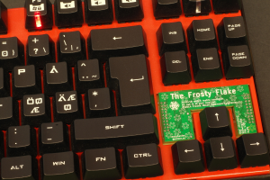

Replacement controller for various Costar keyboard models
As of 2020-09-01 I sold (almost) all of my remaining stock to 1upkeyboards. I have no current plans to produce any more. I have a couple of Black Petals and Tiger Lilies in my drawer, but other than those I'm all out. Check with 1up. I'm leaving the rest of the post for reference.
You may also want to pay bathroomepiphanies.com a visit!
The Frosty Flake - CM Storm Quick Fire Rapid
discontinued rev 20140521
125138-0
discontinued rev 20130602
30668-1

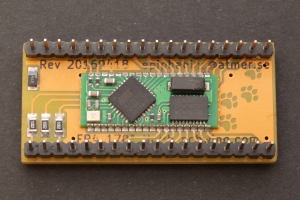

The Tiger Lily - Filco Majestouch/Rosewill full size
discontinued rev 20161114
The Tiger Lily is little more than a Black Petal with extra headers. The firmware for the Petal is used for the Lily as well.
154699-3
The Kitten Paw - Filco Majestouch full size (*also some early Rosewill boards)
discontinued rev 20160418
142289-4
30670-5

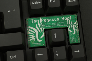

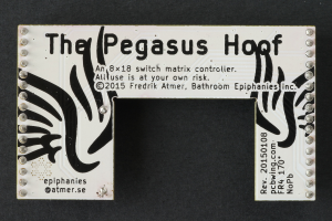

The Pegasus Hoof - Filco Majestouch tenkeyless
discontinued rev 20150108
131158-7
94386-8
discontinued rev 20131001
39752-9

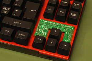

Cool Talk (Voice of Reason adaptation) - CM Storm Quick Fire Rapid
The Voice of Reason is a "superset" of the Frosty Flake. With a few pins removed it works perfectly for the CM Storm QFR. It has ISP and UART pins broken out to a separate header. Also comes equipped with a fuse and increased ESD protection. It is offered as an alternative for power users.
discontinued rev 20151102
140961-10

Last night I opened the Mini Microcontroller replacement board to see about attempting to hand solder it. I just laughed and laughed. There is no way I have even close to the skill required to solder that tiny thing using an iron. So, it really is good news to hear that you have your toaster up and running!

I messed it up royally, but finally I think everything came out good...
:thumb:
You're my only companion on this journey this far. You can't give up!! (Besides I asked if you really didn't want me to build it for you ;))
Do this
  • Scratch some solder mask off from the the  back side where the chips sit.
  • Add flux (the sticky stuff is good) to the center pad and place the chip.
  • Add solder to the iron and heat the pad on the back.
  • Solder will flow through the vias and pull the chip into place.
  • Check that the chip is aligned, all the pads on the chip are lined up with those on the PCB. Otherwise, heat, flux and luck is your friend.
  • Add flux all around.
  • Drag solder the remaining pads.
  • Add flux, use braid, more flux, more solder more braid, and so on until it looks good.
  • Solder all the 0402s like 0603s, only a lot more finicky...
  • Mount the headers.
  • Don't have an application to test the little bug in
  • Profit?...

Okay that makes sense. I won't give up! I was wondering why there were those holes beneath the chip pad. :)
Should be interesting regardless of the outcome! :thumb:

They are actually supposed to be there by design guide lines. They are meant to transfer heat away into the ground plane on the back. I made them a bit larger than the recommendation (which I found afterwards) I think . Many guide lines are aimed towards making re-flowing smooth and consistent. Too large holes could probably suck more solder than what is desired or something. Soldering from the back of course doesn't suffer from that, just add more (=

@bpiphany: is the Pegasus  as same as the HID liberation device?

It's for the same keyboard, but completely different =) Different micro controller and different design idea.
