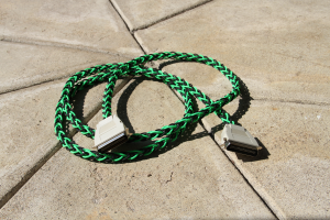

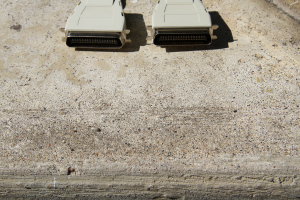

36953-0
This is the connector used.  The old Centronics 36 connector used on printer cables for years.  All I need to do here is add a couple coats of paint.  Picked up a can of Krylon Fusion satin black for plastic.  Here's to hoping it sticks
36955-1
36957-2
36959-3

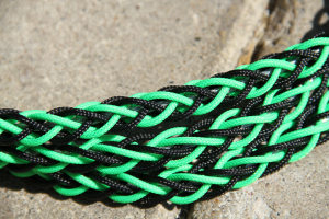

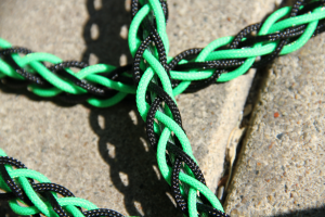

All current pics are uploaded for the cord.  The actual USB cable is inside the other 8 wires that are braided using the 8 strand round braid with alternating colors.  I also stripped the outer black insulation off the USB cable and left the wire and mylar wrapping around the actual USB wires.  The only thing I had to modify on the connectors was to remove the strain relief piece.  The hood actually fits tight enough it should be just fine the way it is.
And before anyone asks NO I will not make one of these cables for you.  This was a royal PITA.  Considering I had to figure out how to sleeve a 10 foot piece of 22 ga wire with 1/16" cable sleeving.  But I conquered and got er dunn.  I can however explain how I was able to sleeve a single 9' 20 ga wire with 1/16" cable sleeving fairly quickly without inching the wire through that sleeve the entire way.  If I would have done it that way I would still be trying to sleeve those wires.  A very nice tutorial on the braid can be found here.  It was a royal pain for the first half but once I got to the second half it started going a lot smoother and easier.  This piece is around 7 feet long.

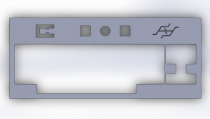

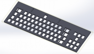

Here is a JPG of my top plate.
55552-5

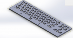

Here is a couple jpg's of my final design for the plate made up into an assembly I have not included drilled holes for where they are going to be bolted together as I am going to do that myself.
55655-6
55657-7
Space bar stabilizers will fit 8, 9, 9.75?, and 10unit space bar.

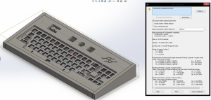

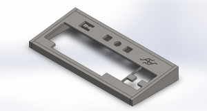

Here is an image of what I plan on doing with the top cover.
61029-8
And here is an image of the case with top cover.  Tomorrow I will get around to including the plates.  It actually turns out it is going to weigh significantly less than what I had thought but according to SolidWorks it is still about 10 pounds with just the sides and the top cover.  I have not added any chamfers yet but I am thinking of polishing the chamfers and having the rest brushed.
61106-9

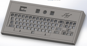

And this is a jpg of the final keyboard design.  I just need to fix the spacebar stabilizer locations as I think either they are to low or I just need to move the plate and everything else up a touch.
61133-10
Well I have fixed the spacebar stab issue.  Just had to move them up a touch.  This thing looks like it is going to be a bit lighter than I thought.  I might have to address that during the actual assembly process.

Have you considered how many pins of the connector you'll be using for the +12v power/ground lines?  You'll probably want to use a couple for each, since the voltage and current you'll be putting through those pins might be quite a bit higher than they were originally designed for! Splitting the flow over a couple pins (and then recombining after the connector) will eliminate most risk.
Also, 3/4" of stainless in just the top and middle, and more (maybe?) to come for the bottom?  This thing is going to double as a bludgeoning weapon!  I like that...
as far as power over these pins i don't think it is going to be an issue.  At most all I am going to be pushing is two 12" CCFL and two 4" CCFL's.  If you have seen the connector for the power switch that comes on the backplate for those it is absolutely SKIMPY.
Offline Neebio
  • Posts: 115
  • Dance Master
Re: Brushed Behemoth (name change due to projected weight)
« Reply #23 on: Fri, 27 September 2013, 15:16:51 »
Full edge lighting... nice ;)

Right. I should have noticed that. Is a PCI slot big enough for the centronics connector? I don't think I've ever seen them on a pc, I'm used to seeing them on the printer instead.
yep, believe it or not some people used to put them on HBAs. right next to freaking dip switches. god i hated the scsi chain unique id system.
Offline Melvang
  • Exquisite Lord of Bumfluff
  • Posts: 4410
  • Location: Waterloo, IA
  • Melvang's Desktop Customs
« Reply #26 on: Fri, 27 September 2013, 19:14:10 »
What is an hba?  Also can anyone confirm if a centronics connector will fit onto a pci slot?  If I have to take the wire clips off to install that is not a problem.
If it won't fit I think what I can do is remove the two bottom pci covers and then remove the strip between them and make one cover to cover the entire gap.  This would be where I can install it here.
Offline Melvang

This is the proposed layout.  If I can get confirmation of larger sized space bars from the Toxic set GB I will go as large of a space bar as I can.  SP does have molds up to 10x which is what I would love to shoot for.
37145-0
And here is the proposed idea for the case without top cover
37147-1
Edit.  Changing layout to a standard TKL layout ish.  See bottom of OP.

So this is what my proposed layout is going to be.  Details on the space bar may change.  But I was thinking of adding a couple pedals under my desk for control and alt instead of having them in the primary layer in my navigation cluster.  What do you guys think?  Keep in mind that I am a gamer 99% of the time for typing.  About the only other time I use modifiers is for the occasional copy paste.  Thoughts comments or suggestions?

Currently finalizing details on sizing and attachment methods for the plate to the rest of the case.  If someone would be able/willing to look over my plate design to double check for proper spacing and alignment that would be great.  Mostly I am looking for verification for the stab locations.  I know I don't have spacebar locations yet but I am only going to have one and it will be the biggest one I will be able to get my hands on.
Also I have updated the OP with a finalized layout minus spacebar size.

Added final top plate design pic to OP.  I will retain all source files until I am typing on this at which point I will release all files for open source.
The one exception is the Teensy breakout board.  Those files are already available.

Added JPG's to OP showing my plate design with second plate just for the capslock.  The purpose of this is to be able to swap the location from center to off center stem without needing to remove the entire lot of switches to change the plate.

Cpt, did you are the last image in the op with the mass properties in it?
