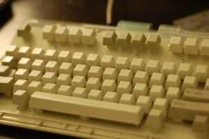

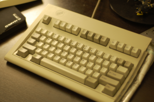

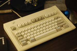

After fiddling around with the dremel tool, I went ahead with the cutting job.
More sanding and smoothing are in order but all in all I am satisfied.
I used a cutting wheel bit on mid-speed and slowly made my way in between the openings.
44064-0
I nicked it here and there playing with speed control but I'm not picky with aesthetics. Functionality and made-by-me is the motto of this project.
44066-1
I cut just to the right of the stand-off at top right corner to support the backplate.
44068-2
I didn't bother cutting the bottom right part of the board (rubber grip and folding leg). The right side ugliness will be covered by the top piece and the bottom will be a sturdy one piece.
Since I will be waiting on nuts and bolts, I am going to smooth out the case and find the right adhesive to put the top case together in the meantime.
I will need some kind of putty to fill the uneven parts. Time to look back at what Hasu did.

Offline anotherbaal
  • Posts: 20
Re: First Project: 70% Model M
« Reply #26 on: Wed, 20 November 2013, 22:46:19 »
I think this project is winding down to a conclusion.
Just finished curing epoxy putty which filled the gap between the two top shells. The result is pretty stellar and it holds up well for now.
This is only 1/10th strength of the regular JB Weld epoxy but I will monitor how well/long this PlasticWeld holds out.
45215-0
Messy under the shell. Added a bit more to give just a bit of extra support.
45217-1
The color is not too far off from the actual case in my opinion. I don't really see a reason to paint it. Or maybe I am just being lazy and giving excuses to myself.
45219-2
45221-3
The final product. Just needs some light sanding to remove bumps from the putty.
This has been a fun project and I definitely learned a lot. I see why people do the things they do on making-stuff-together.
Future plan for the M70 in the order of most likely to I-probably-wouldn't-but-just-an-idea:
1. Teensy to replace the controller and remap on the hardware level(Right now, AutoHotKey does the heavy lifting)
2. Possibly sand down and paint over the shell.
3. Cut the matrix sheets and reroute the matrix(similar to hasu's)
4. Once 3 is done, pry apart the top shell and sand down the seam more to make a tighter fit.
