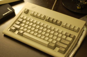

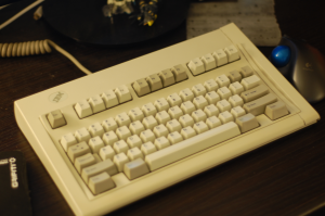

After fiddling around with the dremel tool, I went ahead with the cutting job.
More sanding and smoothing are in order but all in all I am satisfied.
I used a cutting wheel bit on mid-speed and slowly made my way in between the openings.
44064-0
I nicked it here and there playing with speed control but I'm not picky with aesthetics. Functionality and made-by-me is the motto of this project.
44066-1
I cut just to the right of the stand-off at top right corner to support the backplate.
44068-2
I didn't bother cutting the bottom right part of the board (rubber grip and folding leg). The right side ugliness will be covered by the top piece and the bottom will be a sturdy one piece.
Since I will be waiting on nuts and bolts, I am going to smooth out the case and find the right adhesive to put the top case together in the meantime.
I will need some kind of putty to fill the uneven parts. Time to look back at what Hasu did.

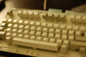

I got a call this morning from Fastenal about the nuts and bolts coming in. And I thought to myself: "I lazed over the weekend. I should finish this up."
So I did(almost...). Pictures are worth more than thousand keyboard strokes:
44845-0
Fast turn around(for Canada).
44847-1
Heeding fohat.digs advice, I used a closest thing I can find to a chisel blade(very sharp xacto blade), I started taking off the tabs.
I just used the blades(without the xacto knife body) to chisel under the tabs in circle.
44849-2
Stamp on the backplate. Seems weird because on the back of the shell, it says, 1391401, 01Sept91.
As you can see, they are not the most flat cuts around but using a little tip from Ripster's bolt-mod guide, they were super easy to manage.
44851-3
Springs were in good condition. Just a little dirty.

45211-0
Before curing
45213-1
After curing. Not much color change after.

45215-0
Messy under the shell. Added a bit more to give just a bit of extra support.
45217-1
The color is not too far off from the actual case in my opinion. I don't really see a reason to paint it. Or maybe I am just being lazy and giving excuses to myself.
45219-2
45221-3
The final product. Just needs some light sanding to remove bumps from the putty.
This has been a fun project and I definitely learned a lot. I see why people do the things they do on making-stuff-together.
