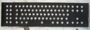

Just to let you all know i haven't been completely idle the last year, I offer you this:
new 1mm thick neoprene pad:
46504-0
new steel top plate (thanks the_beast):
46506-1
PCB design (the matrix anyway):

Is that plate flat? What does it use for a PCB?
Yep, flat - at the moment. The right tool for putting a curve in it is a slip roll. A local sheet metal shops should have one. A less elegant option would be to use a bending break. Harbor Freight has an 18" one for under $50. The PCB will be new. Matrix and controller will be together just like the original.
There is a PDF attachment under the pictures in the first post that shows the matrix - that's as far as I can get until a controller goes public. The first page is the bottom copper layer of the PCB; the second page is the top copper layer of the PCB; the third page overlays the two. This layout copies some of the design "features" of the original matrix that I don't completely understand, but must assume the designers put in there for good reason. There is no ground plane fill on the PCB, only a ground trace around the columns on the back. I can only guess that less would allow too much noise but more would kill the signal. Also, all row traces cross all column traces exactly one time (usually at right angle) but for the most part keep as far away from each other as possible. You can see that this requires adding "tails" to trace routing on the original XT PCB most notably on the bottom and left side.

the harbor freight brake is crap (naturally). slip rolls are getting somewhat rare, i've found. you will probably need the plate stamped before it gets rolled though right? i'm like 90% sure that IMS has a slip roll, and will do fairly short runs. for the stamping you need a die machined. that's kind of a pain.
I don't think it needs to be stamped at all. I'm locking the top to the bottom plate using bolts instead of tabs, so i don't need to turn the edges down. I'll use 10 bolts very near where the 10 tabs were, to it should maintain the feel.

are you planning on drilling out the bolt-holes? tricky to get the geometry right prior to slipping. stamping is the preferred solution, but for short runs a drill press will work fine.
Does this mean that you are pulling the plates into curvature by torquing down bolts, or will it stay flat?

The bolt holes on the top were laser cut with the barrel holes. The back plate will require a hand drill, but i plan on including a paper template and instructions on getting those holes drilled within allowed tolerance.
The top plate will be curved using a tool like this:

why not have the_beast's guy laser out the bolt holes then send it over to the slip roll shop? this would be basically plug and play, and his rates are extremely reasonable for 16ga 304
That is exactly what i did. This plate is 18 gauge CRS. i thought it would be easier to roll and take paint better, but stainless would be an option. I'm just trying to find a local shop that will roll it for me. South Florida is full of HVAC shops. I wish i had more time during the day to call them all.

The top plate went through a slip roller at Merlin Industries. Thanks David! It took all of about 1 minute and 50 seconds of that was setting up the machine.
I'm planning on using the DPH controller for this. The guys developing this controller want it to work in all of the IBM model F boards that use a 30 pin ribbon cable to connect - 122, KishSaver, UnSaver, and AT. So all i have to do is add a 30 pin connector and get HaaTa to include it as an option. To that end, the XLS file has the "default" key assignments.
I neglected to embed the font used in the PDF attached to the OP. It is supposed to look 8-bit retro like this.
my understanding is that cold-roll's machinability is due to the fact that it's yielded once. for strength you'd want to slip roll hot-roll sheet. this would effectively give you cold-roll, but it could also distort the lasering you'd doing prior to rolling.
stainless is non-ferritic and i thought i knew what that meant but just spent the last hour learning what it actually means, which is damned fascinating crystallization metallurgy. for what it's worth though, powder paint is basically a pigmented and potentially filled polyster substrate. the polyester can be metal filled, cut with another polymer, or what have you. however, the paint never bonds with the metal (unlike anodization, which is the formation of a pigmented oxide layer), so it doesn't really matter that much what metal you start with, as long as it is inert up to about 3-400F and can be abraded with a reasonable material (Si carbide usually) to increase surface area and promote granularization

Progress pictures.
74501-0
I was not able to bend down the leading and trailing edge on my custom top plate to create the tabs that normally keep Model F key assemblies together. The next two pictures show my method of keeping the top and bottom plates held tightly; binder clips. They are very low profile if you remove the "handles" (easy to take off and put back on). You can get a box of these for cheap at any office supply store. They probably will break about as often as Model M rivets, but would be a lot easier to replace.
74503-174505-2
The binder clips alone keep the plates very tight. There is no wobble in the barrel at all. I'll use two bolts (right side of caps lock and left side of of backslash) to align the plates east/west/north/south.
« Last Edit: Thu, 14 August 2014, 15:17:40 by wcass »
