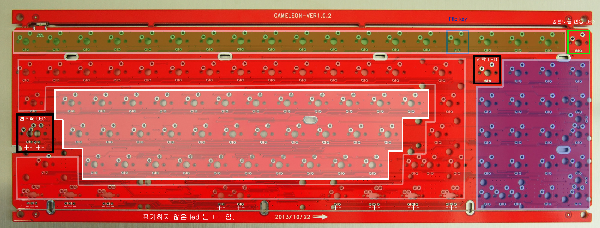

The Side LEDs are 3.5mm x 2.8mm in size (3528 or 1411 package size).  If you are changing the side LEDs, please note the orientation of the original LEDs before removing them: it's not symmetric!
All LED resistors appear to be 470 Ohm variety. Please note, this was true for Lightsaver V1.  Later versions might be different--please double-check.
PLEASE NOTE when installing LEDs, polarity is not indicated on the PCB, but it's the standard + on the right, - on the left, when looking at the PCB from the top (not from the bottom).  BUT, if you're doing a 1.5x modifier layout on the bottom row, note that the LEDs for the right-side Alt/GUI/Ctrl should be reversed in orientation to - / +.  If in doubt, check the bottom row LED orientation without soldering first with the board plugged in.

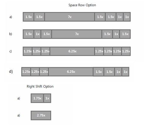

Layout options for Lightsaver V2 - more options for the bottom row:
(options a) and d) along with short 1.75x right Shift allow for the arrow cluster, G80-1800-style :
