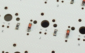

 I have to admit, I was pretty intimidated when I first saw the size of the resistors, but it actually was not as hard as I was anticipating.  Having the right tools makes a HUGE difference.
66522-0 66524-1
Diodes are on!
I thought the diodes would be easier to solder on because they were bigger, but being cylindrical makes them kind of annoying.  The first side of the diode was actually more difficult than the resistors.  The second side was easy.  I actually went back and retouched some of the initial solder joints on the first side after the second pad was soldered on.

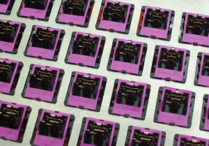

Switch Stickering
Nothing too special in this update.  This was a relatively short session, so I just put the switches on a universal TKL plate (my version of a lube station) and opened them all up and stickered them.
My only advice when modding switches is do all the switches at the same time for each step.  This reduces the amount of time you spend switching between tools and doing unproductive actions.  I find this really speeds up the whole process.
70330-17
Since this is going to be my own personal board, I made sure to use these awesome pink stickers.   :thumb:

I don't want people to get the wrong idea about this, so I am going to clarify a few things...
It is not that it is super difficult to solder these on, it is more that it is harder than you expect when looking at them.  Because of their size and the size of the surfaces you are soldering, it looks like it is going to be very easy.  I think the main reason it is difficult is because we have an expectation when we sit down to do it and that expectation is not what we experience.
These are actually very easy IF you step back and don't try to solve the problem head on.  Here are the tricks that I have learned when working with these that I will use on my next build.  With these tips you will realize that these are no harder than the resistors (maybe even easier).
Just a quick summary of how to do SMD soldering for people who are very new to this:
- Flux at least one pad
- Put a small amount of solder on your iron and touch it to the pad to transfer it
- Repeat for one side of all of your pads
- Re-flux all the pads you just added solder to
- Reflow the solder on the pad and slide diode onto the pad
- Repeat for all diodes to result in one pad soldered for each diode
- Flux the pad and exposed end of the diode for all the diodes (I use a flux pen)
- Heat the end of the diode and the pad at the same time and touch the solder to the triangle made by the end of the diode, the pad and the iron.  This solder joint is SUPER easy to do.
- Repeat for all of the second pads
When I started on these, I was too focused on creating the perfect solder joint on my first pass.  This proved to be very challenging and this is why I found this process so difficult.  It was not until I soldered the second pad on all the diodes that I realize my mistake.  I was too focused on trying to create a perfect solder joint on the first pass, but that turned out to be irrelevant.  All the first joint has to accomplish is to make sure the diode is in position and solidly stuck to the PCB.  Once it is in place it is super easy to do the second joint.  By the same principle, once the second joint was finished, the first joint was super easy to reflow and make perfect.
So the trick when working with these diodes is:
- Just get the diode to stick on the first pad and sit in the correct spot
- Solder the second pad on all the diodes
- Resolder all of the first pads to make them perfect
Had I known this trick, it would have taken me half the time to solder up the diodes on this board.  Hopefully this trick will save many people the frustration of working with these 'rollin' diodes...  :)  GL HF...
