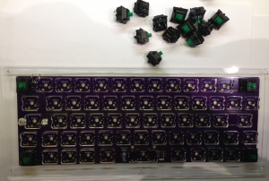

Here we are, getting read to start assembly.
94238-0

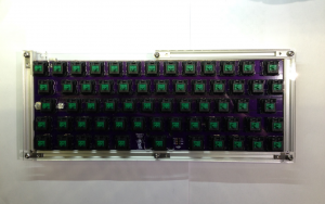

Moving along, MCU checked out, time to install some Greens.  That's 3mm acrylic.
94240-1

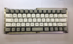

Switches installed, I ran out of the aluminum bits for the frame, so it's not quite done.
94242-2

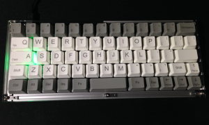

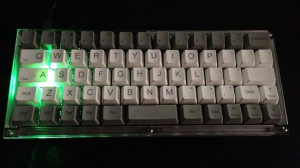

...and keycaps (WASD customs).  I might eventually go all blanks, but I thought I might need some hints to get started, especially with the bottom row, and the tab/Q caps/A.  Tab and caps are on the momentary function layer, as are the F-keys, home/end/pgup/pgdn, etc.
94244-3

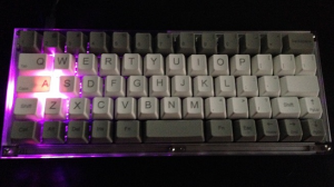

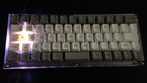

Here are some pretty colors with the indicator LED under the A/caps key:
94246-494248-594250-6

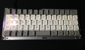

Slightly better lighting?
94252-794254-8
I should have taken some pictures next to the Pure, but I forgot, and my pictures are terrible anyway, but here it is next to the Race.
94256-9
Anyway, I'm pretty excited about it :D .

Looks good.  It has a very clean presentation.  I assume the Fn key toggles caps lock and enables tab.  If you don't mind me asking, where did you get the keycaps made and was it very expensive?

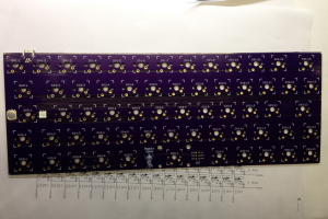

Nicely done!
Can you show off the bottom side and the microcontroller? Most people don't appreciate the effort to stick an ATmega in the middle of a switch matrix, but I do ;-)

Actually, it's rotated 45 degrees, and under QWAS.  I didn't take the cover off the acrylic on the bottom plate yet, so it's hard to get a photo through there without taking it off.  I can do that once I get the last of the frame pieces.
Here's the layout in Kicad
94262-0
So... full disclosure, this is the little sister to the full board, which had those 20 other keys.  I just cut off that section to make this one first.  I just haven't put the extended-edition one together yet.   The extended-edition one is just a little shorter than a TKL.

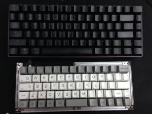

I finally got the last bits and pieces to put together the Big Sister version...
I've changed a couple of minor things - moving the Left-Alt into a more familiar position, extending the firmware to cover the numpad area, and alternate mappings for those keys.   The only thing I forget sometimes is that when I need to tab between fields on a webpage, I occasionally type 'q' then remember I have to Fn-Q to get Tab.  Other than that, I've been really happy with my weird layout.
Here's the "big" one next to the WASD Code:
And just for additional reference... the little one:

Have you got a KLE link for that? Not so easy to visualise from the PCB :P
I basically want to use standard keysets on a 40%.
Offline regack
  • Posts: 660
  • Location: Thessia
Re: 59% - or - not quite a 60% keyboard
« Reply #33 on: Wed, 06 January 2016, 06:16:19 »
Yes, sorry, I just put that up in an edit to my last post.  If I could bring myself to cut off another 1.25 from the width, it would fit into a Planck case - which would be great from an 'inexpensive cases available' point of view.  I don't know if I could live with the layout, however.  The thing is, I never thought about combining the Shift and Z like you have, even though I did that with Tab and Caps... I think I might be able to figure something out with this.  Thanks!
« Last Edit: Wed, 06 January 2016, 06:23:30 by regack »
Offline joey
  • Posts: 2298
« Reply #34 on: Wed, 06 January 2016, 06:39:26 »
I'm not sure how practical it would be.. maybe I can remap my 60% at some point to test it out.
Sounds like your Tab/Q key worked out fine?
