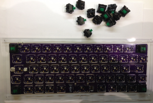

Here we are, getting read to start assembly.
94238-0

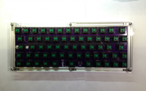

Moving along, MCU checked out, time to install some Greens.  That's 3mm acrylic.
94240-1
Switches installed, I ran out of the aluminum bits for the frame, so it's not quite done.

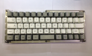

...and keycaps (WASD customs).  I might eventually go all blanks, but I thought I might need some hints to get started, especially with the bottom row, and the tab/Q caps/A.  Tab and caps are on the momentary function layer, as are the F-keys, home/end/pgup/pgdn, etc.
94244-3

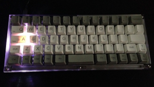

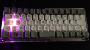

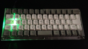

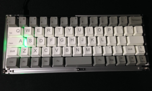

Here are some pretty colors with the indicator LED under the A/caps key:
94246-494248-594250-6

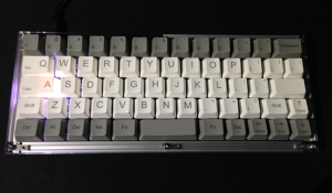

Slightly better lighting?
94252-794254-8

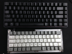

I should have taken some pictures next to the Pure, but I forgot, and my pictures are terrible anyway, but here it is next to the Race.
94256-9
Anyway, I'm pretty excited about it :D

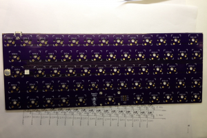

Here's the layout in Kicad
94262-0
So... full disclosure, this is the little sister to the full board, which had those 20 other keys.  I just cut off that section to make this one first.  I just haven't put the extended-edition one together yet.   The extended-edition one is just a little shorter than a TKL.

May I ask what that is below the capslock? It looks like micro dome switch?

There are two things there, on the outer edge of the board is the reset switch - it's actually a really low profile blister-like ALPS switch :D (SKRRABE010).  The other, over the atmega is some kind of 5050 RGB led, I can't find the packaging.
Actually, it's rotated 45 degrees, and under QWAS.  I didn't take the cover off the acrylic on the bottom plate yet, so it's hard to get a photo through there without taking it off.  I can do that once I get the last of the frame pieces.
Nice. That's roughly where I put it on the JD45. Can you share your part number for the USB? I've just built up the Planck PCB with one that's got through-hole mount pins but SMT signal pins, but I'm looking at alternatives, esp. ones with all TH pins so it's end-user solderable (and thus optional).
It's a nice solid through-hole part : Molex 54819-0519

Have you got a KLE link for that? Not so easy to visualise from the PCB :P
I basically want to use standard keysets on a 40%.

Yes, sorry, I just put that up in an edit to my last post.  If I could bring myself to cut off another 1.25 from the width, it would fit into a Planck case - which would be great from an 'inexpensive cases available' point of view.  I don't know if I could live with the layout, however.  The thing is, I never thought about combining the Shift and Z like you have, even though I did that with Tab and Caps... I think I might be able to figure something out with this.  Thanks!

I'm not sure how practical it would be.. maybe I can remap my 60% at some point to test it out.
Sounds like your Tab/Q key worked out fine?
Yes, Tab/Q is great, no problems there at all, except when rapidly switching between layouts, sometimes I forget and type a Q instead of a TAB.  I'm not sure if I can deal with Z/Shift or "/Enter
