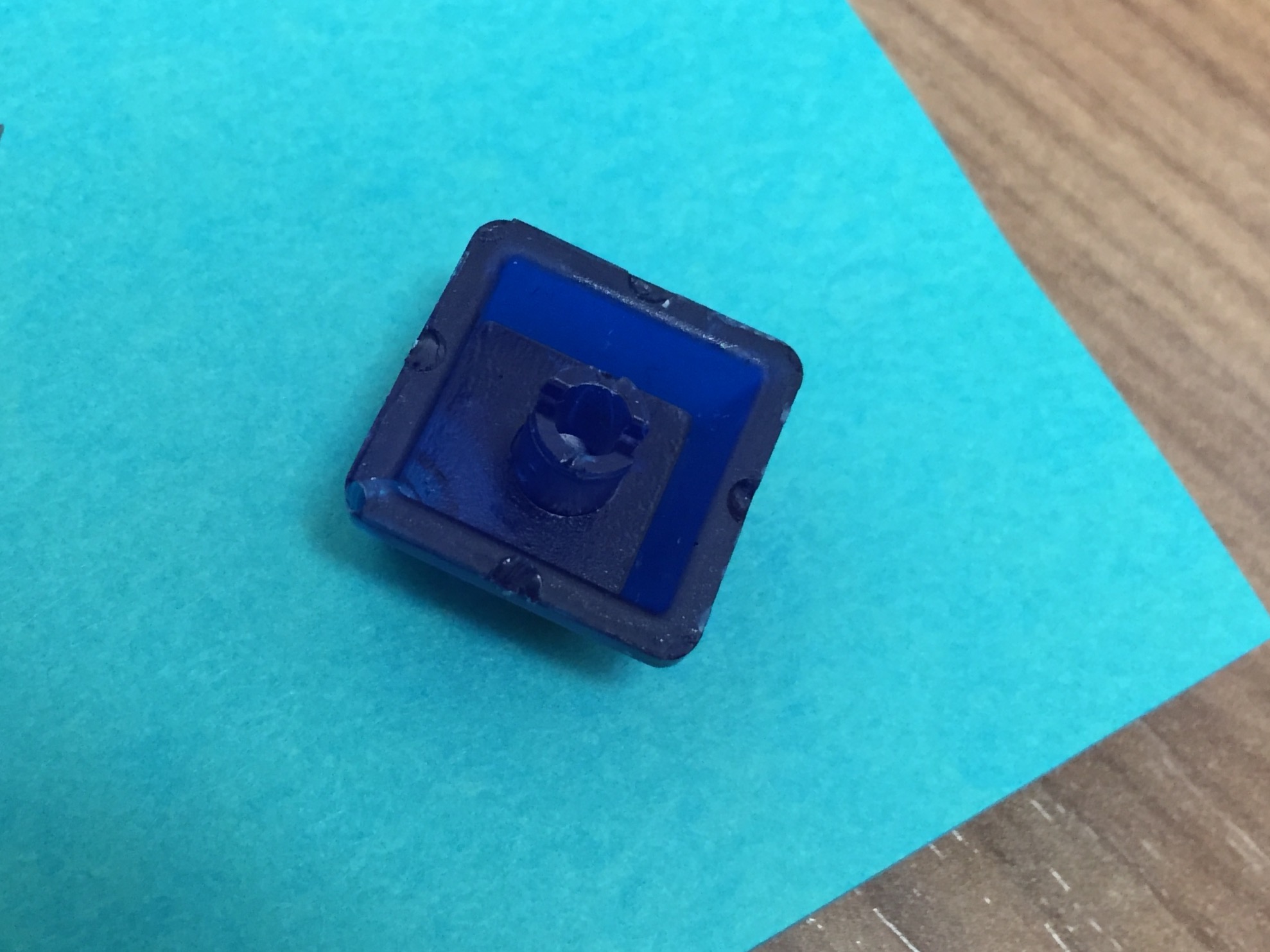

So I've been playing with the :~$ynth for a few days and having a lot of fun learning with it. I've never cast anything before so the process was entirely new to me. I read up on some of the maker threads here and went for it!
I know there are lots of bubbles and flaws in what I have so far, but I'm really amazed how this tool makes this craft so accessible to someone that's never done it before. I'll be trying some new things with it, getting better materials and tools.
Thanks Binge!
Thanks Binge!
Those caps look awesome!
Thanks Binge!
Very well done :) perfect example of its usage as a template and learning tool.
Thanks Binge!
Question about the initial silicone pour...are you putting anything underneath the synth, such as clay? Or just plugging the holes and pouring?
Thanks Binge!
Yes, I used a bit of play-doh around the bottom of the box and pressed the Synth onto it to prevent the silicone from flowing beneath it.

Offline fendent
  • Posts: 251
  • Location: Cackalack
Re: :~$ynth
« Reply #499 on: Mon, 22 August 2016, 13:18:59 »
Got my synth! Looks great, but the stem pieces does not fit into the base. :( Is this a manufacturing defect or am I missing something critical here?
« Last Edit: Mon, 22 August 2016, 13:23:27 by fendent »
