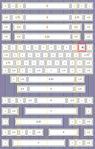

I had a picture of the bare board, but it's rather plain.  Skipping ahead, my not-particularly-elegant solution for controlling the RGB Lite-On LTST-C19HE1WT LEDs was born out of practicality more than anything.  The keyboard is running a variant of QMK Firmware which is, of course, a variant of Hasu's TMK firmware.  QMK has really good support for WS2812 LEDs for the underglow that people have been adding to their Plancks.  Well, WS2812s are just a WS2811 integrated into an LED, so I covered the entire back of the board in WS2811s to control my LEDs.
All I can say is that it took a lot of patience to solder all of that mess.  My only problem was that I used an ATMEGA32U2 so I could fit everything better.  QMK didn't really support anything other than the ATMEGA32U4, so I had to branch off and make more changes to work with the U2.  Anyway, it works, the lighting effects are fun.  I'll have to go back in and put in some kind of max brightness limit to keep it from going over the 500mw USB spec.  I saw it spike up to ~800mw at one point, but it works fine if I keep the brightness down.  In these photos it's hovering around 120-200mw and it looks great in person.
I built it for myself, so this is pretty much it for layout options.  You get something close-to-normal, or something really bizarre-o with impossible-to-find 0.75 width keycaps.  I built the crazy version, so...

http://www.keyboard-layout-editor.com/#/gists/cc590136479f132aded5b4cfb4ef0066
This what I was using as a guide, but it's not the best pic:
147489-0
