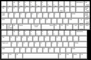

so i move around in projects alot as i really like to stay busy. but this time i really want to put in the time, do it right, and create a truly full featured well thought out board. open source from the start. i have the layout figured out at least from my perspective. but the PCB i'm going to need alittle help with. right now the best i can do is a PCB with Teency daughter board since i'm not knowledgable enough to wire an ATMega directly to the board which is what i'd prefer.
i want this to be open source from the start in the spirit of the community and of GH.
the idea for this board came from my enjoyment with compact keyboards but the frustration of function layers. perhaps i'm just lazy perhaps its just more efficient to have afew extra keys.
a standard 60% keyboard has 61 keys. which is ok but wasn't quite enough for me, an TKL has 87, which was more than i really use so there was wasted space. i like the size of my 60% but wanted more keys. what i came up with after abit of tinkering was a board with 70 keys, BUT was only 0.5u larger than a 60%. this is achieved by shortening many of the modifiers, breaking the space bar into 3 pieces and adding additional keys. all is explained in better detail in the below pictures.
the goal was a fully functional keyboard, compact but not to the point it would be overly difficult for anyone to just pick up and be able to use easily. this includes dedicated direction keys in the primary layer. the ability to have media keys dedicated but multi functional. all of this would be customize-able. so all the additional keys could be modified to the end users ultimate preference. made for Cherry MX / Alps / Matias switch compatibility because... options are great!
130492-0
i have started a github repository for this. it includes the .json files from keyboard layout editor which can be imported to both keyboard layout editor and swill's plate builder. included in this repository is a PCB schematic made in KiCAD . i would love this project to be picked up by the community.
https://github.com/se7en9057/67percent-optomized
I look forward to all of your thoughts, comments, and constructive criticisms. i have thick skin. and plan to persue this regardless of community involvement or enthusiasm. i hope you find it as interesting as am.
on another note i made this BEFORE finding out that it was very similar to the keycool keyboard.
this has no affiliation with ultrahack.org
i had no idea they existed until i googled "ultrahack" today... small world isn't it?
« Last Edit: Wed, 09 March 2016, 12:26:29 by mrbishop »

« Reply #1 on: Tue, 08 March 2016, 09:26:12 »
I had to look up the Keycool you were talking about since I wasn't familiar with it, but that split spacebar can make a big difference in how the keyboard can feel to you.  I happen to like this layout you've come up with.  I could see myself using something like this, but I might ditch the left side space bar, shrink the center function key and add even more 1.25s down there.
One thing I can tell you right away is that you're going to limit what keycaps and sets you can use, unless you have customs made.  DSA would work well, or R3 SA.  Just something to be aware of, don't let it discourage you.   Now, since you're already in the realm of needing odd caps, you could actually fit your project into a 60% case by removing .5 from the right hand side.  If you shrunk the Backspace (1.0), Pipe (1.0), Enter (1.75), RightShift (1.25) and knocked the two Spaces down to 2.0 it would all fit.  That might be too many compromises for you though, especially hitting that 1.0 backspace or 1.25 right shift.  I'm just playing with your layout now, you don't have to listen to me :D.
In the end, your layout looks like something that you've come up with to personally suit you, in which case by all means you should pursue it even if nobody else chimes in.   I would probably start with a hand-wired acrylic plate, just to see if you really do like it, all the while you could start working on a PCB with all of the features that you want.   You could always re-use the acrylic plate, or at that point have an aluminum/steel/brass/titanium/diamond-studded-platinum one cut.   :thumb:

Thanks so much regack. Yeah I like the slightly larger modifiers. So I may just keep them but to your point the mass market compatibility of allowing this to fit in a existing 60% case is interesting. Ill have to tinker with it abit.  I really wish I knew more about the atmega stuff because the teensy takes up so much room.
Thanks again for the words of encouragement

« Reply #8 on: Tue, 08 March 2016, 12:10:56 »
after looking at the layout and examining more of my typing style i realize i only strike the space bar with my right hand so in theory i could just ditch the left one. but i really really like a larger back space key. the middle function key is abit of a strain for my hand so the right shift could end up being a function key. this is all based around my hands etc etc. but to your point. some of the keys may not nessairly need to be there or could move around abit. sadly tho the larger backspace key for me anyway would have to stay. god i love rage deleting text. that key will be a MX Blue or white Matias for sure ;) and the delete key too haha.
Rev 2
130548-0
« Last Edit: Tue, 08 March 2016, 12:14:20 by mrbishop »
Projects
Offline regack
  • Posts: 660
  • Location: Thessia
Re: project UltraHack - 67% keyboard
« Reply #9 on: Tue, 08 March 2016, 13:53:00 »
I hit the space exclusively with my right thumb as well... just under the N, a little closer to M.  I centered the switch there, but used a 2.75.  I probably could have made it smaller.  The other thumb lands just under the V, so I put my Fn key there.
Now I want a 'Space' key that has front printed 'the final frontier' on it

« Reply #15 on: Tue, 08 March 2016, 21:11:06 »
I'll be honest because you said you have thick skin. The layout is aesthetically jarring, especially that bottom row. It's looking better on your later revisions, but it scares me a little bit. The extra keys would be nice to have, especially dedicated arrow keys. The keycap & case compatibility concerns have already been raised.
And finally, if you're going to move around all those keys, the least you can do is put Backspace where it properly belongs (in the \| position).

« Reply #16 on: Tue, 08 March 2016, 21:34:10 »
i'll agree the lack of symetry is somewhat irritating to the eye. but the more i thing about it and try to figure out what keys i dont even use the makes more and more sense to have the reduced size space and added keys on the bottom row.
i find the larger backspace key easier to find when touch typing and above the \| is where i like it :P however it would be simple for someone to move that key.
i think in the end this will be a specialty keyboard more catered to my likeing. would be awesome to have some fans however this is my personal quest for a 60% size keyboard that has more function for me. dedicated media keys and direction keys are key for me so thats kinda of where i started.
60% board Pluss arrow keys, pluss media keys... then i started trimming the fat. slimming keys and moving stuff around.
but yes i have thick skin. i do like the lay out more or less. i'm considering bringing back the extended second left spacebar but rather than space it would be a massive FN key. for symmetry sake.
as always i love to hear ideas and criticisms. so i will thank you for yours and take it into consideration.
