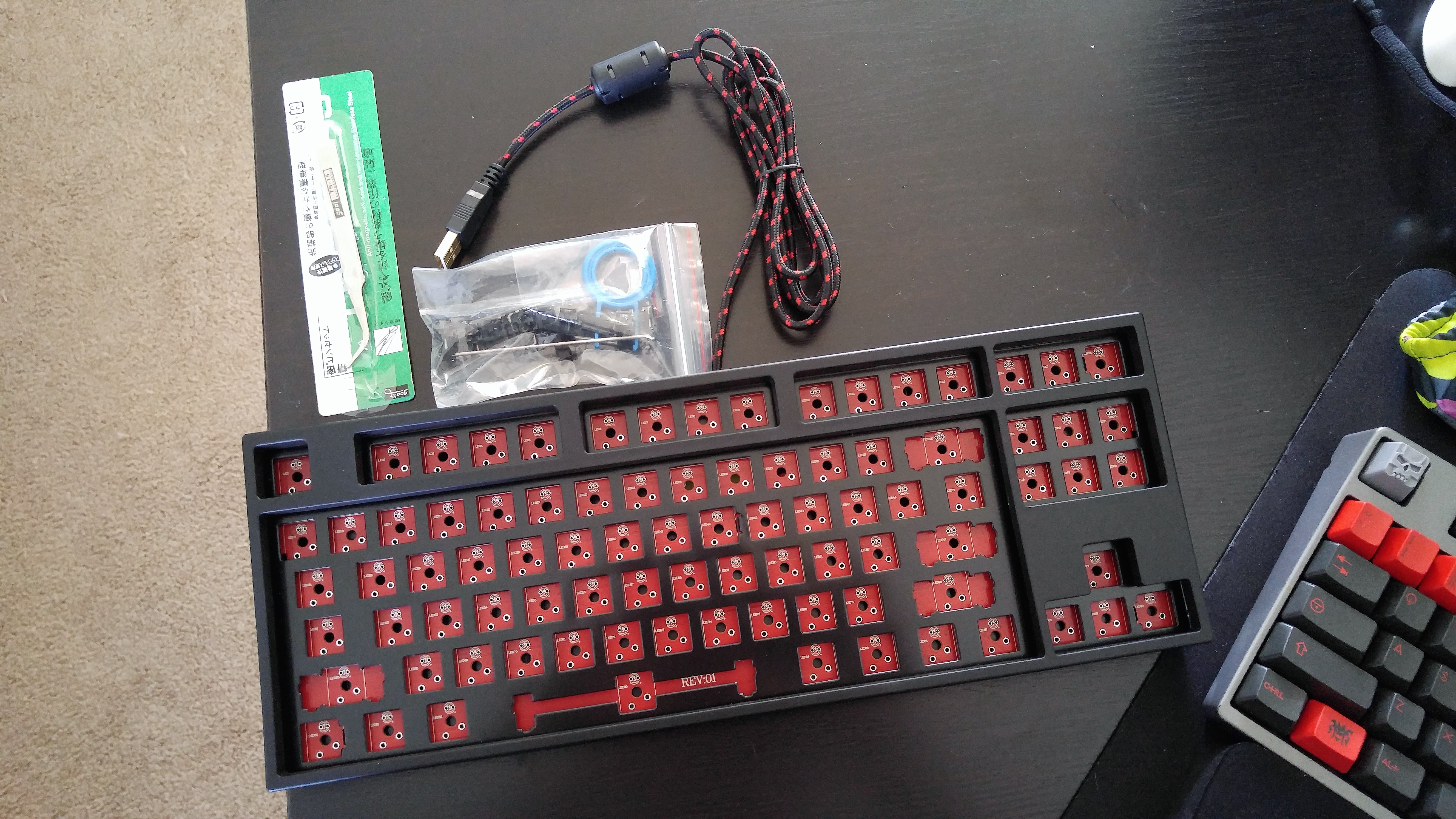

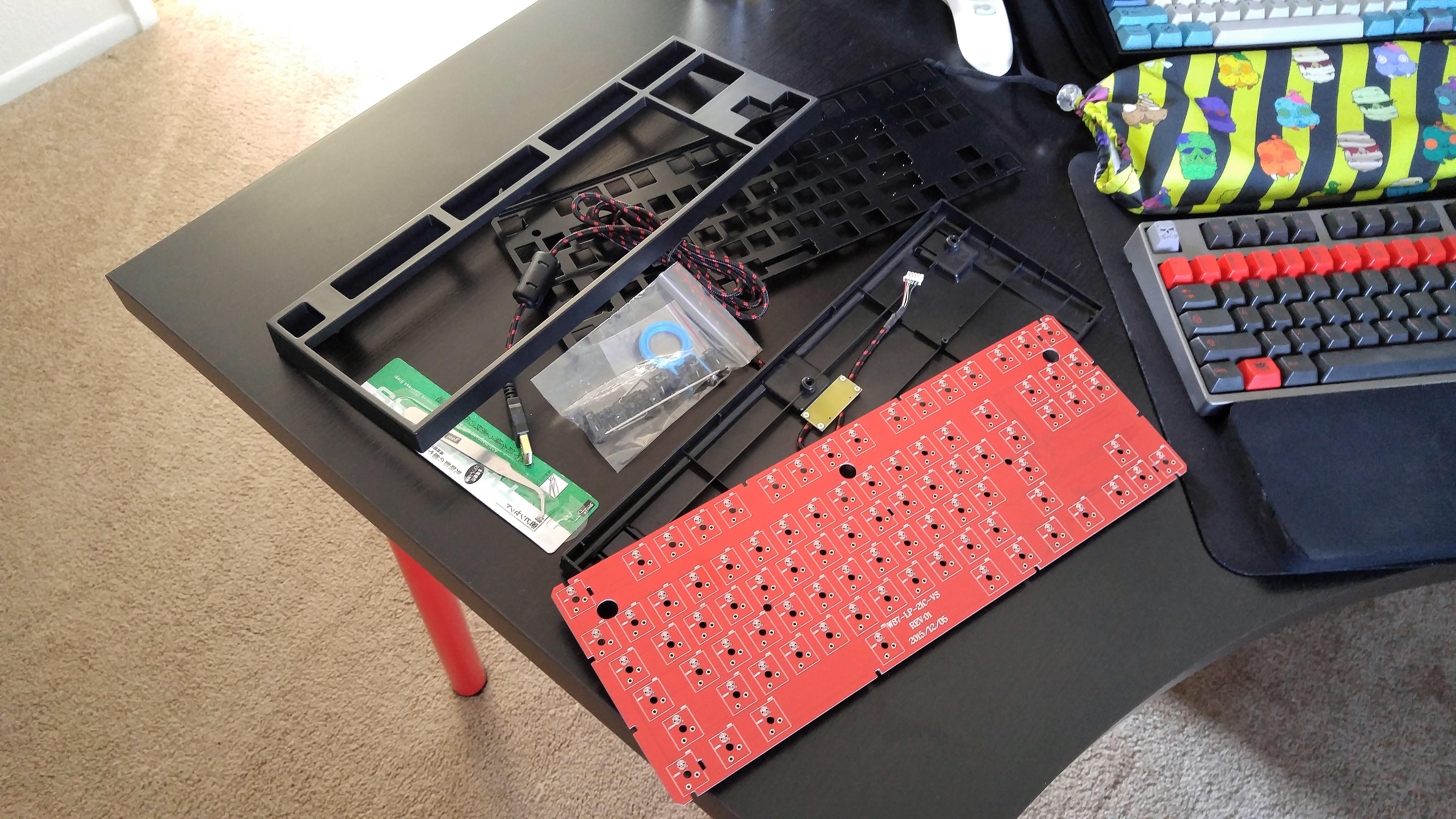

I have recently been given the opportunity to build/work on a couple "Korean Kustom" boards for other members and really got the itch to build my own.  I scoured the internet looking for a kit I could afford when I came across a tiny hidden kit on Aliexpress.  It was hidden away under a Satan GH60 pcb as a drop down option in the order form Link to kit here.  I went for it.  That kit was $67 shipped and included a case, powdercoated steel plate, pcb (with led support), plate mount stabilizers, a braided cable, and a set of tweezers.  Not too shabby.  Total delivery time was under 2 weeks and the board showed up today in perfect condition.  It basically looks like a QFR clone with the fixed cable of a Filco.  The weight is nice with the steel plate and the quality of the top and bottom plastic is much better than expected.  One interesting note on the pcb is that the leds don't use individual resistors, they are all traced directly to a controller.  I am not sure what the wattage range is, but will give the white leds I have a go.  The pcb that I received is a rev.1, and looks completely different than the one in the photos.
131945-0
131947-1
131949-2
The build will be using Cherry mx clears: lubed, 60g gold spring, with abostudio clear tops and red stickers.  I will be using 1.8mm white leds.  Even though the plate is powdercoated, I plan on sanding it down and refinishing it a high gloss blood red.

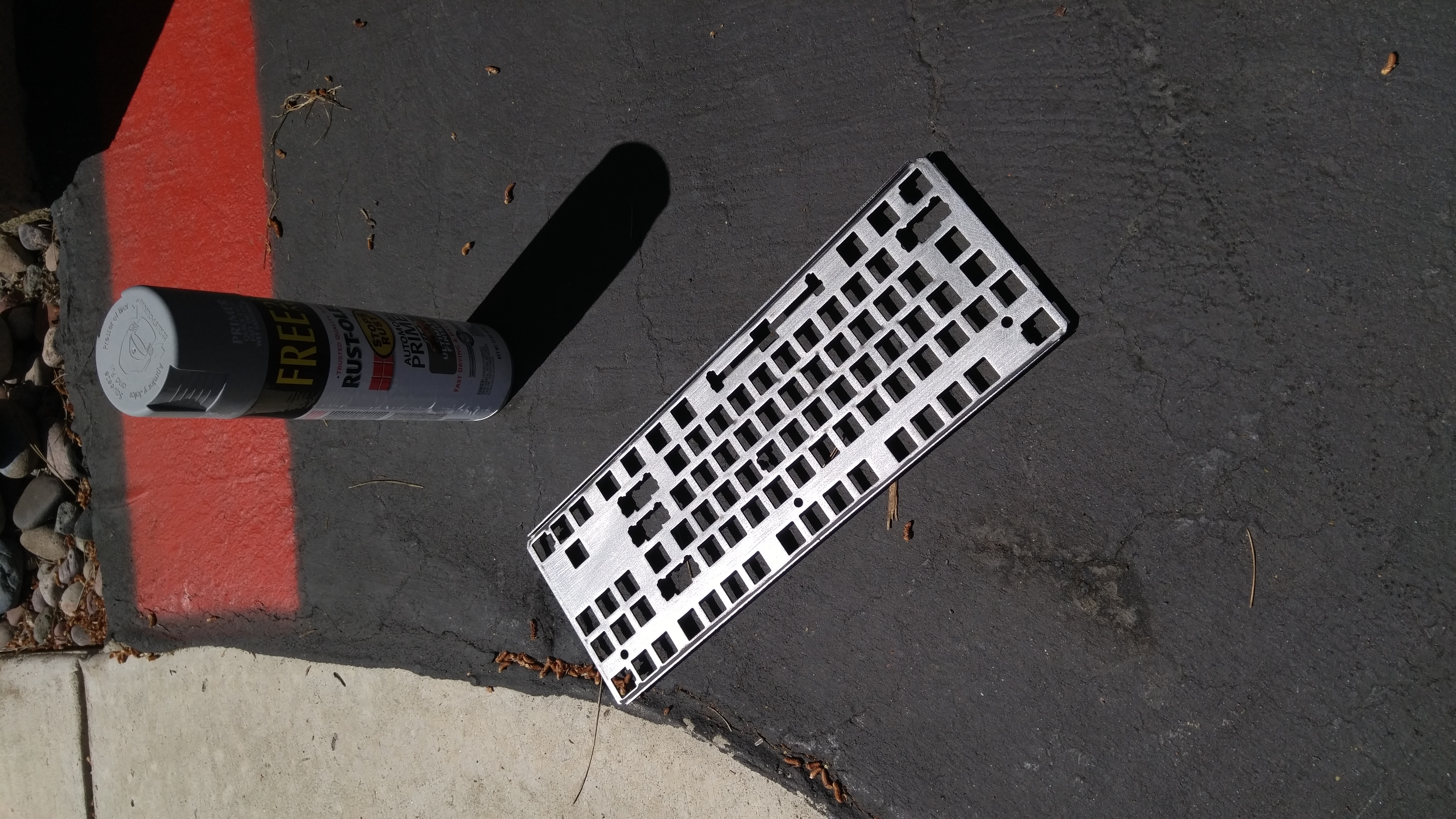

Making quick work of the plate  :thumb:
All sanded down to 500g and rubbed down with IPA:

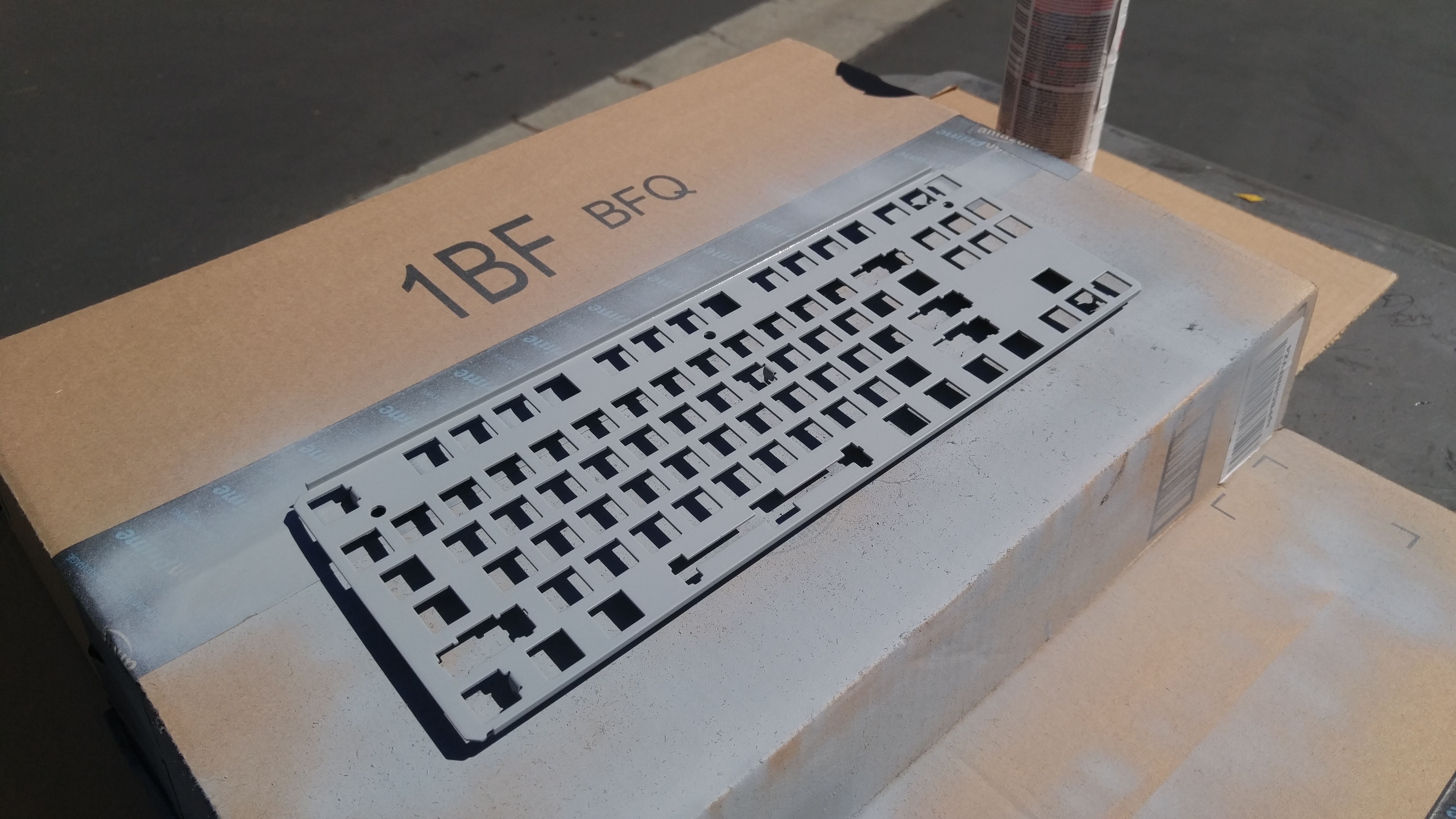

131955-3
Primed and ready for paint:

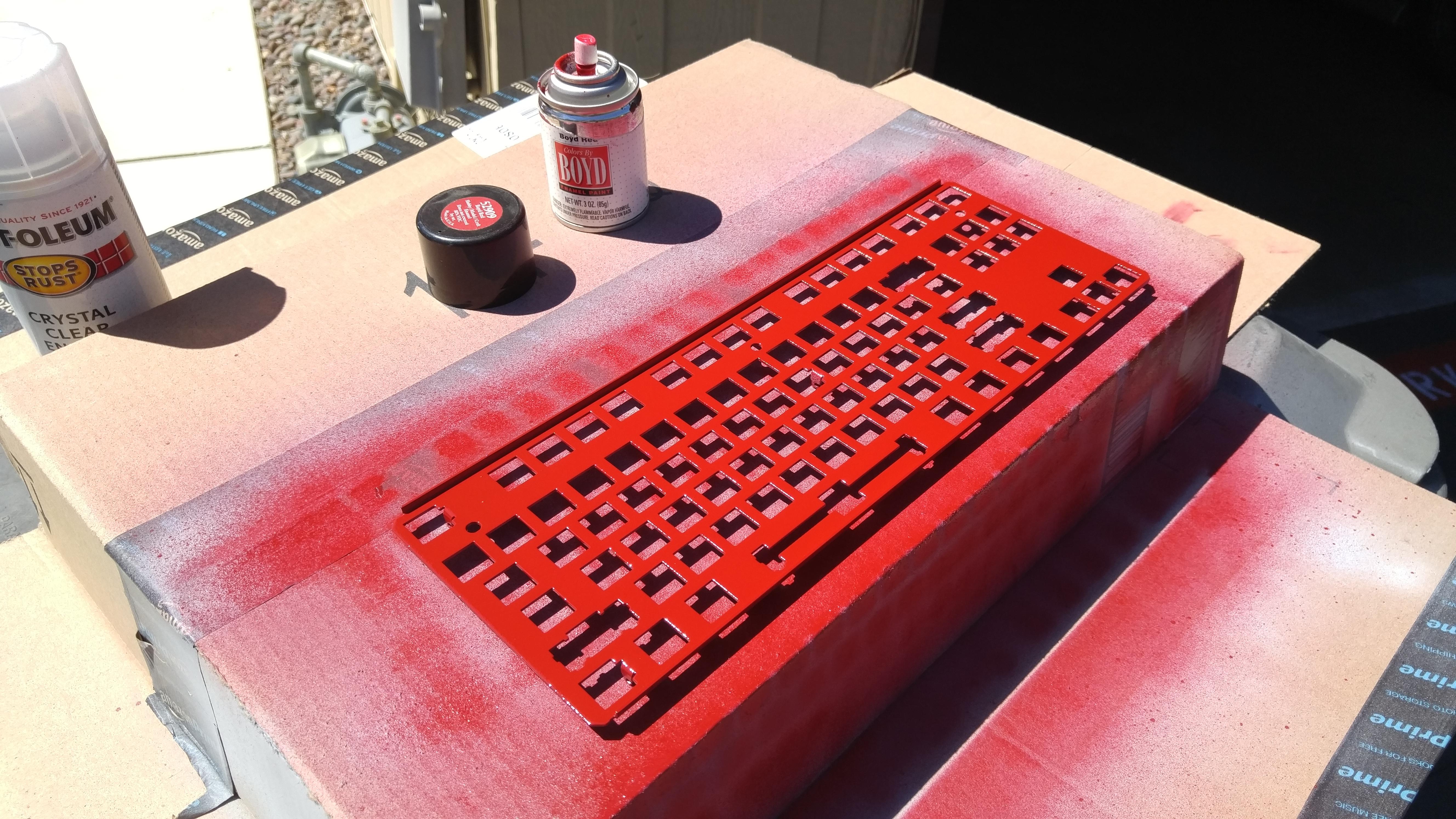

Update 3/24/16
Testors "Boyd Red"
132075-5

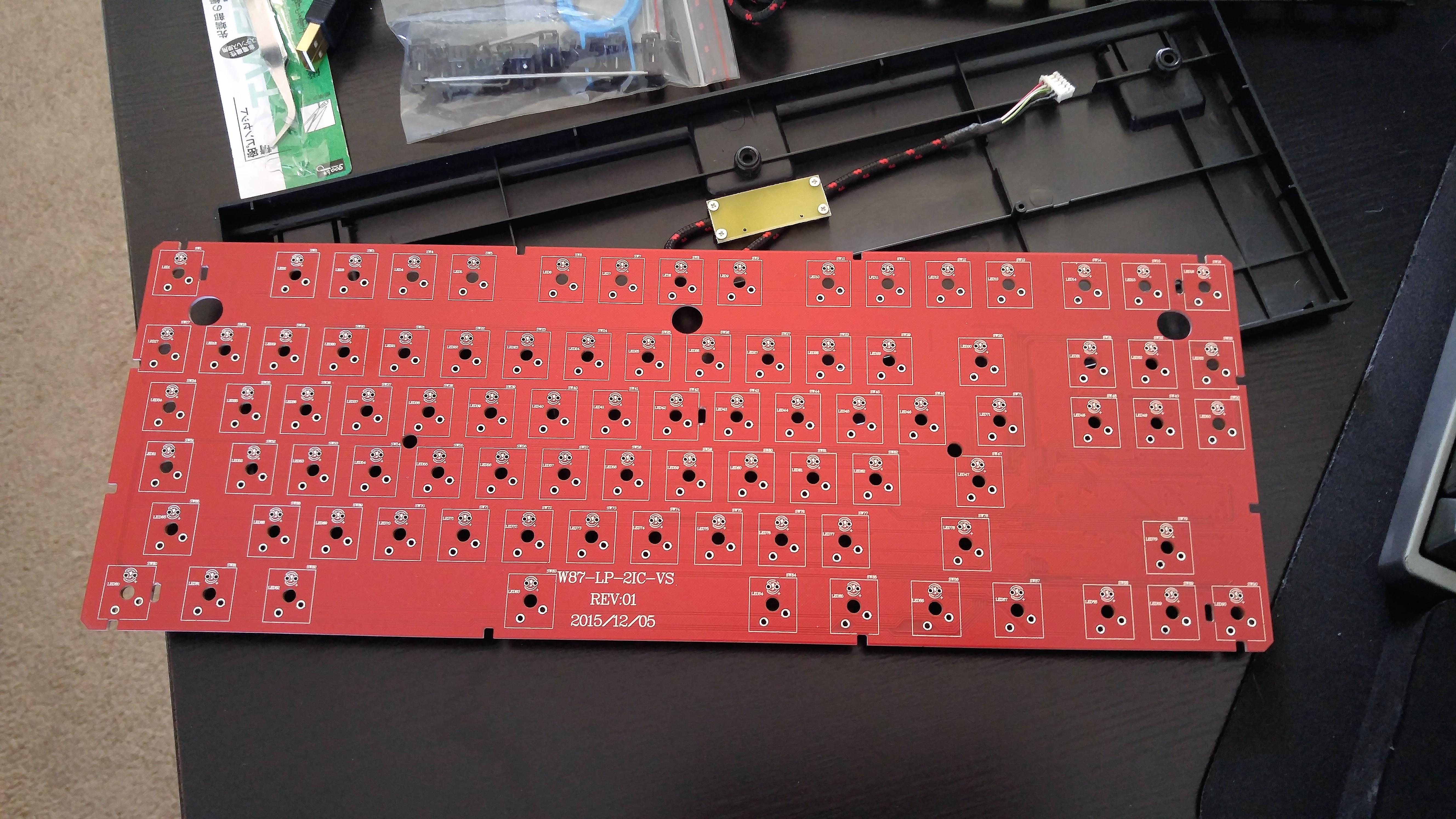

Dumb question, does the PCB support underside SMD RGB or 1206 LED?

Nope, only through hole with standard with 2.28mm leg spacing (this is standard for most common 1.8mm, 2x3x4mm, and 3mm leds).  I am still unsure what wattage it supports as I don't get to put my own resistors on it.  Also, I have absolutely no idea about controls for the leds as there is no manual or any thing I can find.
Should be fun  :thumb:

Could we get more pics on how that USB cable connects?

« Reply #33 on: Tue, 05 April 2016, 11:37:31 »
What MCU does it use?
Here is the controller for the board:
133447-0
This is the one for the leds:
133449-1
Offline MOZ
  • KING OF THE NEWBIES
  • Posts: 3977
  • Location: Jo'burg
  • Busy making stuff
Re: (Build log) Badwrench builds a "Chinese Custom"
« Reply #34 on: Tue, 05 April 2016, 12:22:59 »
Hmm,
MCU - VISION VS11K06A
LED Driver - VISION VS12L02A
Only other board I see using similar electronics is MAXTILL TRON:
https://m.coolenjoy.net/bbs/boardc.php?id=review&no=30886&board=review
http://www.comway.co.kr/bbs/board.php?bo_table=maxtill&wr_id=33&sca=%ED%82%A4%EB%B3%B4%EB%93%9C

Perfect.  That Maxtill shows the keys needed to change the led functions.  When I first assembled it, the right windows key didn't show up in the keyboard tester which is consistent with a Fn key.  Once I get my last remaining parts in the mail (I accidentally clipped the guides on the stabilizers to get a little more clearance, and that is not recommended), I will reassemble and see if those functions work.  Also, looking at the pictures, they have the same stupid wide stabilizer spacing on the space bar, so I am hopeful mine is the same.
