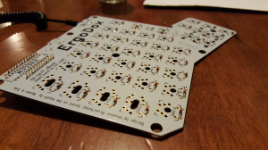

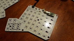

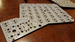

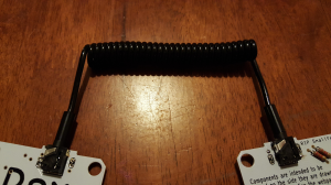

electronics. pretty basic. nothing really fancy here with the exception that i made the USB mini connector by hand soldering the connector i bought from Digikey (pain in the butt let me tell you)
133905-0
133907-1
133909-2
133911-3

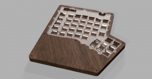

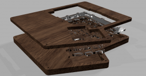

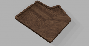

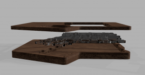

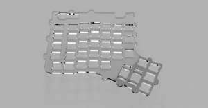

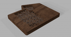

case design is abit different than the standard layered case. 3 pieces instead of 5 with the acrylic mid plate hidden inside the wooden outer frame. optimized for CNC machining.
i'm waiting on the customers final decision but this is the basic design so far.
133913-4
133915-5
133917-6
133919-7
133921-8
133923-9

prototype progress
forgive the cracked material. laminate board is horrible to work with especially the really cheap stuff. but its great for prototyping ;D
