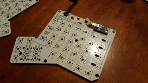

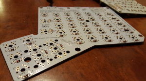

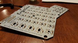

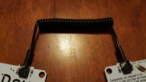

electronics. pretty basic. nothing really fancy here with the exception that i made the USB mini connector by hand soldering the connector i bought from Digikey (pain in the butt let me tell you)

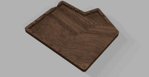

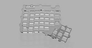

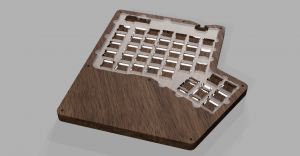

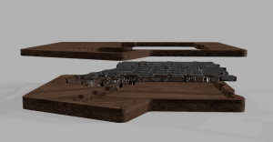

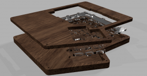

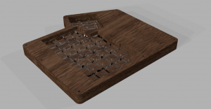

case design is abit different than the standard layered case. 3 pieces instead of 5 with the acrylic mid plate hidden inside the wooden outer frame. optimized for CNC machining.
i'm waiting on the customers final decision but this is the basic design so far.
