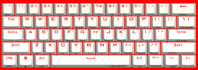

> Do you know what the embedded layout will look like on the 60%?
Yes, see this photo. Again, this is as specified, I won't be able to test it until the new boards arrive. This layout was designed by me with some slight modifications by the manufacturer. It is not programmable at the moment - we're working on that.
150348-0
> has anyone tried DSA caps on them to see if they will be fine in the stabilizers?
I don't know, but, SA works just fine so I'm going to guess that DSA works just fine as well. Signature Plastics use the same spacing for all of their designs IIRC.

"Car race"?

« Reply #120 on: Wed, 12 October 2016, 11:30:16 »
"Car race"?
Lights up keys expected to be used in car racing games. Likewise "FPS", "LOL", "COD", etc.

I think I will end up buying one of these boards.  Which one will depend on you XMIT, as I'm counting on you to give your opinion on which version is more silent (50g ABS vs. 70g Bamboo) once you receive the prototypes.
That picture of the 60% with all those lightning modes for various games really hurts my soul.  It just makes me want to scream "Kids get off my lawn keyboard!"
It is what it is I guess..
