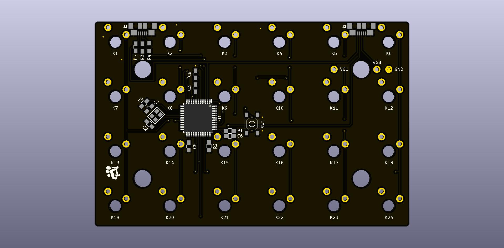

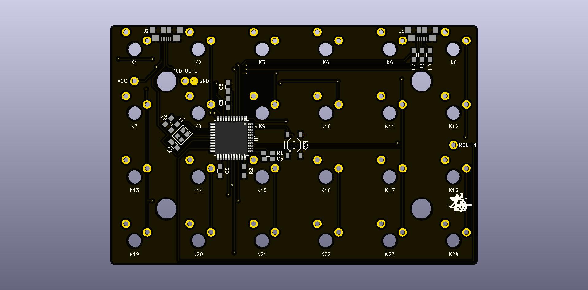

So I started learning KiCad, reading the schematic of the let's split, identifying the pin assignment.
Then again I realize the with a pro micro on board,
it will increase the case thickness or an extra milling will need to be done.
So I have to use SMT component. I studied the schematic of the pro micro, and I took reference from GH60 schematic and other guides.
I ended up with this:

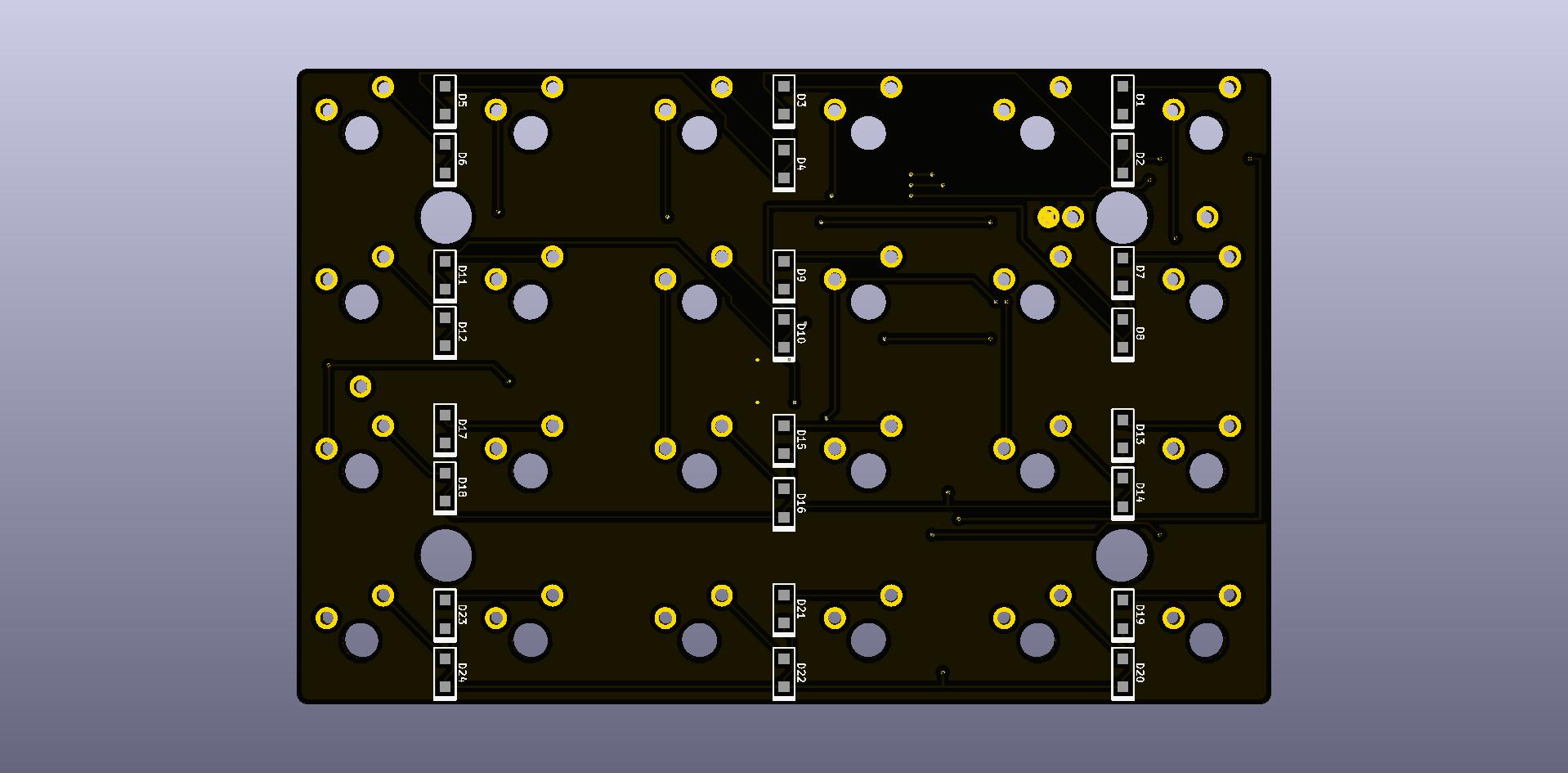

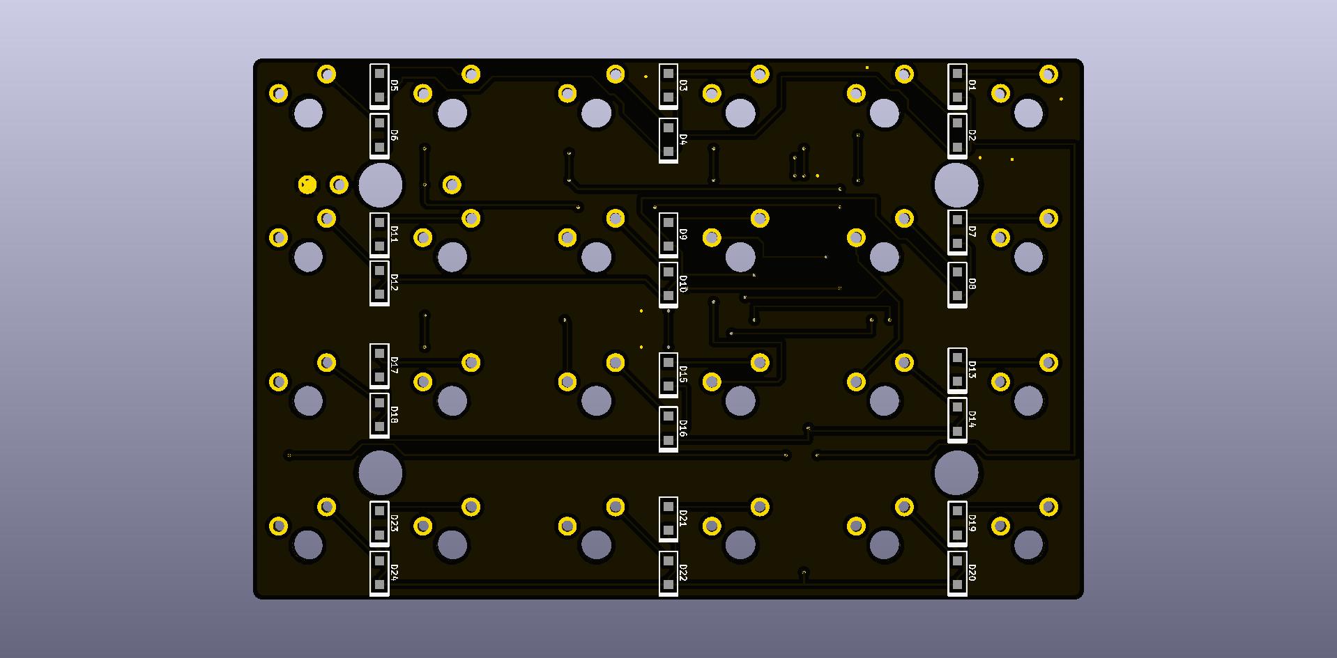

Left and Right (case side):
174233-0174235-1
Left and Right (plate side):
174239-2174237-3
I put the diodes on the plate side because it's a bit difficult to route them when they are at the same side with other components.
By the way the words printed on the PCB is Japanese word '梅Ume 酒Shu', meaning is plum liqueur. Simply because my wife loves it very much :)
Now the pcb is not reversible like the Let's Split V2, which means the ports connecting two boards are fixed, which is at the inner side of the board, and it only takes cherry/clone as the cherry+alps compatible foot will take up too much space for circuit route tracking.
The connection between 2 PCB will be microusb, because it has by far the smallest footprint in my limited knowledge, I am actually seeking suggestion of a better and smaller connection.

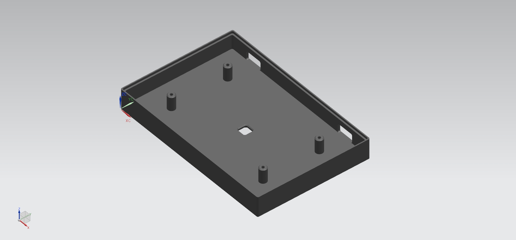

Case:
174241-4
The opening at the bottom is prepared for the resest switch, and the 2 openings at the side are for the Micro USB.

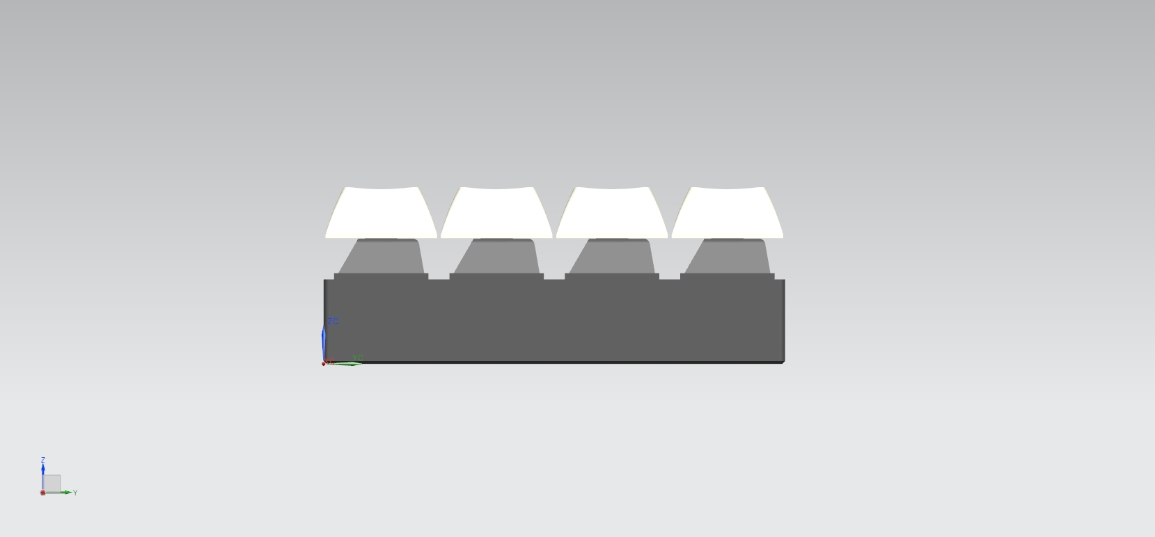

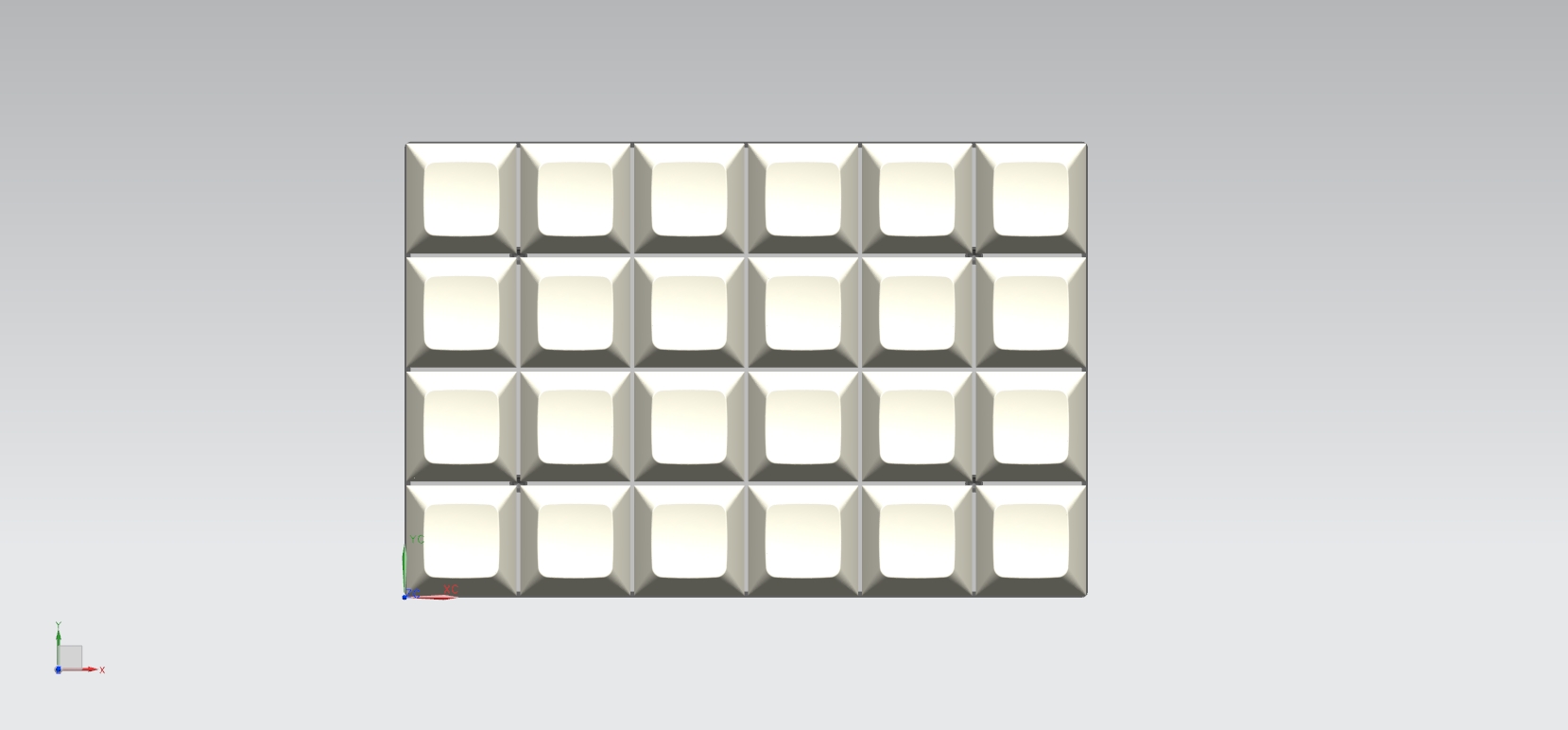

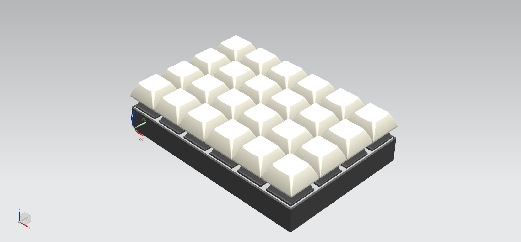

Assemble with DSA keycaps:
174243-5
174245-6
174247-7
The switches and the keycaps are not entirely accurate, I just made them for the sake of getting a rough idea how the final product will look like.

Looking for advice:
1) The pcb design. It will be really great if someone experienced can evaluate/check my pcb, I have almost zero experience designing a PCB.
2) Prototyping of case and the PCB. I lived in Singapore, I do not know who to approach for the prototype fabrication, if anyone from here can show me the direction towards fabricating the prototype, or anyone here can quote me for the prototyping, it will be really helpful.
