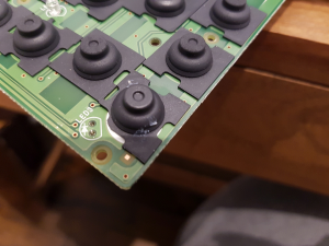

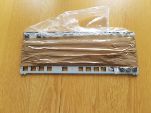

OK guys, so here it is.
As I mentioned before, I had to move a bit each of the bottom row housings (you can find drawing above in one of my posts).
I had to butcher one of my Novatouch keyboards to get its sliders and some housings, but this is the price if you don't want to use JTK or other third party sliders.
I started from preparing the patient:)
192186-0
192188-1
192190-2

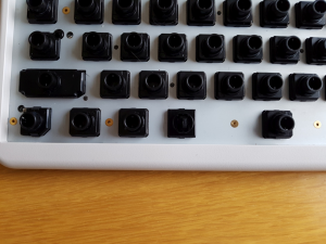

I wanted to cover rest of the plate. Being a modder, you do that all the time:)
I used sharpie to highlight how deep I need to go - around 2mm on each housing hole.
192192-3

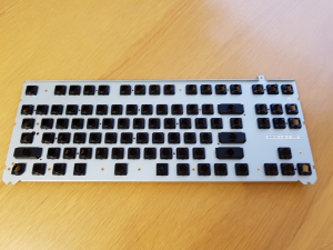

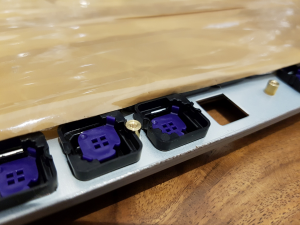

As we all know, bottom left CTRL needs some modding too - being 90 degree turned on Realforce, there is a full corner there - I have to file it off and use Novatouch housing for it as that original one in that corner is weird.
192194-4

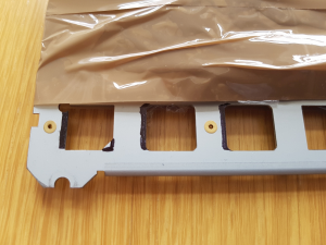

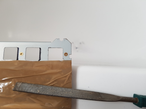

..and some action - using small file I started to get make all those holes bigger...
Later on I took out my trusty dremel and used it to get rid of most of the unwanted metal... small file was to finish it off.
192196-5
It took about an hour or so to do all holes. I did all main ones plus those two spacebar stabilisers holes, as mx space bar has different positions on those, compared to topre (as you all know).
Those housings that were near case "mounting stems" had to be modded a bit too - I used round file to make their sides more opened.
192198-6
..and this why - you can see how nicely it goes next to the case mounting stem.
192200-7

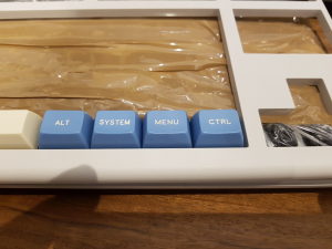

Now trying out with actual sliders and caps...
192202-8
...that space bar needs to go a bit more on the side - going back under the file:)

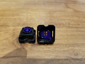

Topre Realforce stabiliser housing needs to be modded a bit too - drilled holes for stabs on sides. I only did one of them, then decided that as I already butchered NT, why not to take its housings!
192208-11

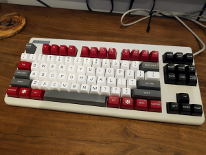

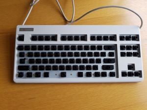

Here it is! Realforce keyboard with standard bottom row !!! ;D
Looks like first in the world with full standard row.
Everything is possible guys - grab your dremel and file and do it yourself!  :D
192210-12

Keeping this thread as my modding one, just wanted to show my latest purchase and wee project.
Bought a RF R2, then modded with Novatouch sliders. Used KRytox 205g0 for stabs' wiring and Tribosys 3203 for modifiers' sliders and housings.
Then put on GMK Space Cadet.

Well, I did mod R1 before to use MX caps - that one needed more work on it to use it (you can see my mod at the top of this thread - a bit of filling on the plate to get it done).
R2 is a lot more simple - I just used Novatouch sliders - problem with Topre is that spacebar stabs need to be swapped with the Novatouch housings - plus the wire.
So wo I did is I used all from Novatouch. Housings are fine, for all switches apart from spacebar stabs. R2's standard bottom row helps to simply swap them.

Yeah, basically to fully mod it and have best solution is to grab a Novatouch and butcher it.
There are 3rd party 3d printed solutinos for those spacebar stabilisers but they are not ideal, I had them and they broke after few uses.
That is why so many people do mod Topre boards but keep original spacebars as is, topre slider, stabs and actual cap.
So far best solution is to get NT and use its sliders and spacebar bits. Topre original housings for all caps apart from spacebar are fine.
What I also do is I always add rings (latest Deskeys are amazing), it helps if you want to have silent version. Without is also fine, but if you want a nice lovely thock, add some slim rings.
