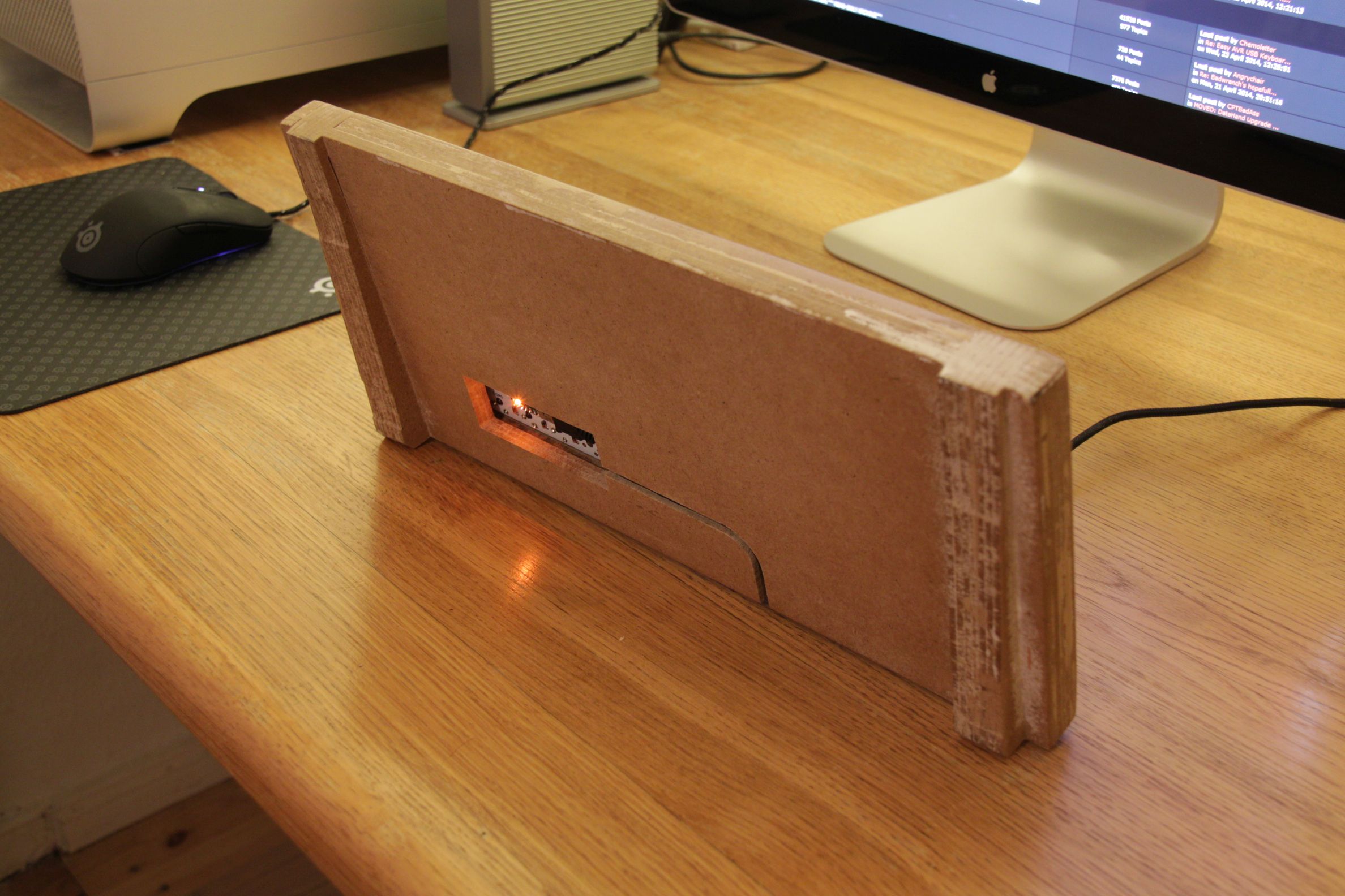

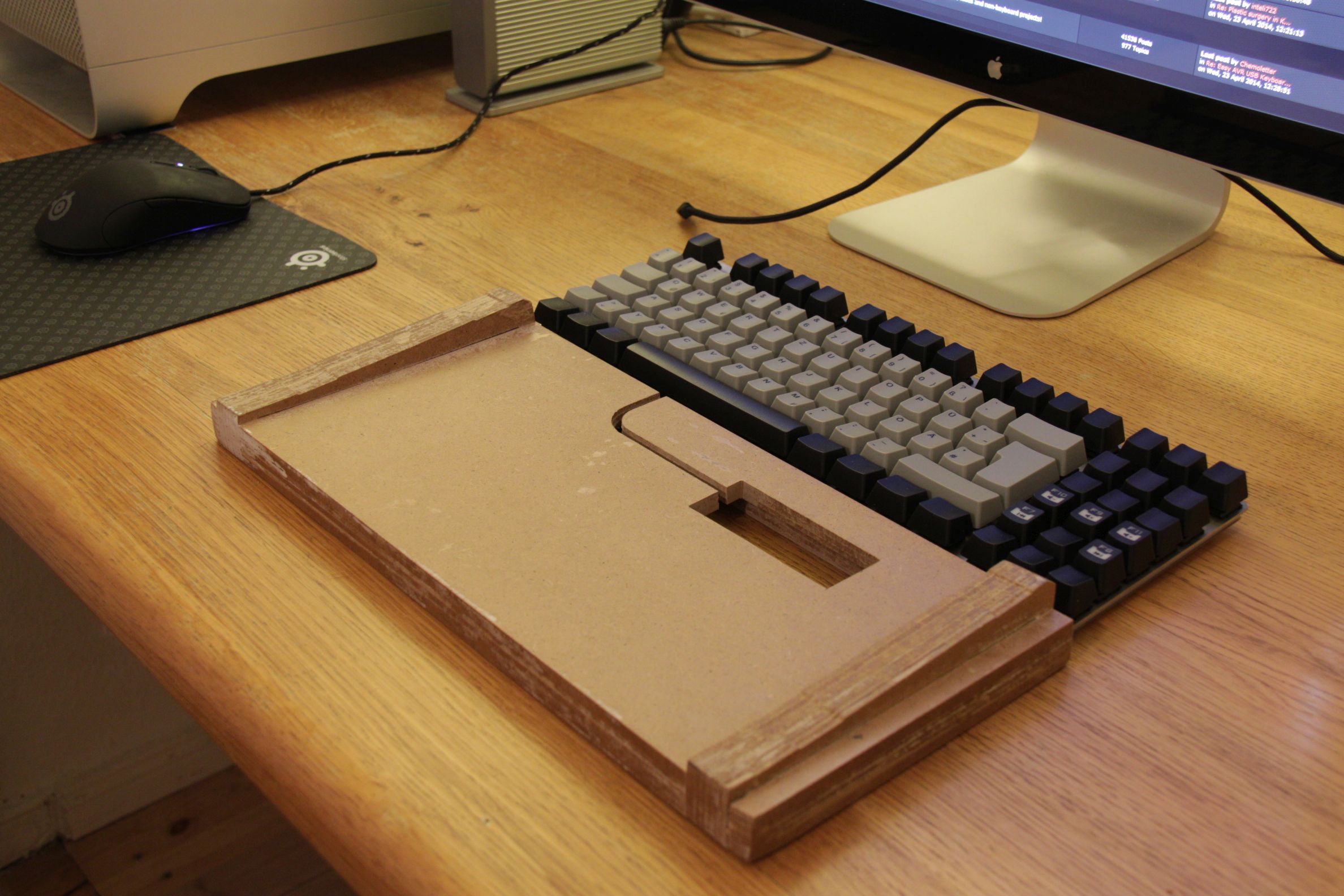

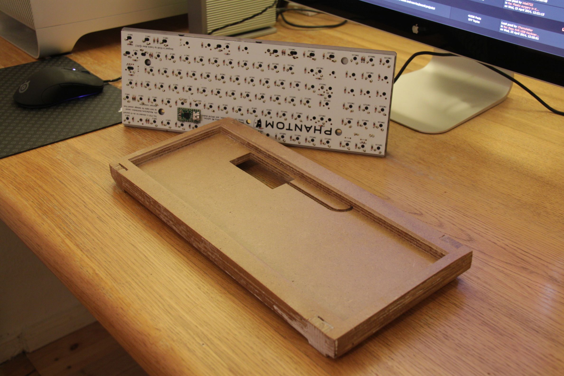

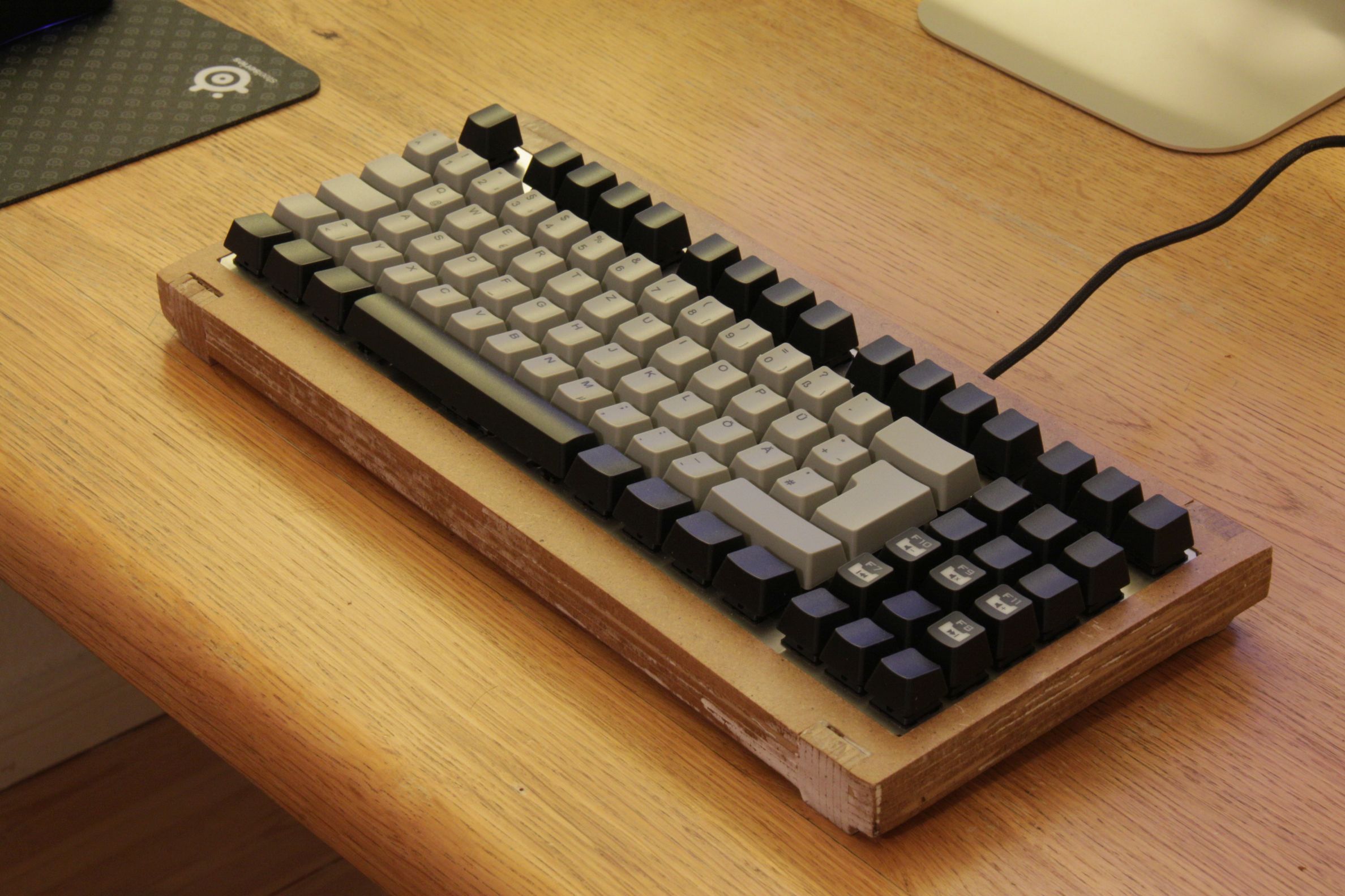

hi folks,
as a noob with keyboards and having watched all the starcraft II casts for a night i stumbled upon whitefiredragon's youtube video about building a custom keyboard using the phantom pcb. three months later, having signed up to geekhack.org, having bought a soldering kit and everything else, having spent countless hours searching for parts like stabilisers in germany ( and not having found them here ), i've completed my (first) custom board. it is a phantom ISO 1.25x german keyboard with blue switches and cherry stabs ( thanks to whiskytango for providing my board with stabs - would be uncomfortable without them )
some of you may have seen this:
http://geekhack.org/index.php?topic=56161.msg1270713#msg1270713
so this was my idea of a case for my phantom. it should be accessible all the time without screws etc. in my original case-post the case was to be lasered. at my place they wanted to charge 100€ just for the lasering and i said "no way". so i went to my university where they'd do it for 25€. too bad that their lasercutter was broken at the time. so i decided to mill it which was a bad idea with this material. as you can see the edges are pretty uneven which i tried to compensate for by sanding quite a lot ( you should have seen it when it came out of the milling machine... ). the result is rough to the eye but very smooth to the touch in deed. all parts are glued together with "ponal holzleim". the end result was spray coated unprofessionally ( see the white stains ) with matte clear spray coating.
but besides that i have to say that i totally LOVE the case, it is heavy like a brick and sturdy as hell. it's a tank seriously. and it has this rough underground style to it. ( well the next one will be lasered for sure and will look and fit better at the end )
i wanted to thank you all for your support, your suggestions and your help. this is an awesome community!!!

awesome handwork man!
how about the weight?
Offline Chemoletter
  • Posts: 48
Re: my finished phantom keyboard with case. have a look!
« Reply #4 on: Fri, 25 April 2014, 05:48:54 »
heavy for a wooden case i think. the recipe is 80g glue, 1,15kg of wood and roughly about 250g of enamel. that makes 1,48kg/2,2 lbs for the case. ( there are some rubber strips that i'm going to apply when i can spare some time. so add another 10g maybe ). the next case i'm going to build will be either the same material but lasercut - so no underground looks but nice burnmarks - or some kind of steel/wooden combination. but that is to be figured out designwise so it makes sense. ( and i will have to take a thorough look into my wallet for that )

You did liked the PCB?
I assembled one last week and to be totally honest I didn't liked at all the MK PCB. There are a few missing titles (the caps lock led/resistor, maybe because of the white background) and the quality of the plated holes was kinda poor.
The most annoying detail, IMHO, is the limited options for the diodes. Actually the only option you do have is to solder or not the diodes.
« Reply #10 on: Fri, 25 April 2014, 12:47:24 »
stabs on backspace, enter and right shift are now working perfectly. spacebar stab needed a gentle scraping with a knife and runs smoothly now too. for some reason my F12 key does not respond on aqua. i'll resolder it to make sure. anybody know a remapping program that supports german layouts? ( ö,ä,ü an so on)
Read what I said when I responded to you in my thread.  The layout is supported, the only thing missing is the internationalization of the GUI.  For that I would need volunteers that are native speakers.

those caps!! where did you buy those - i want them  :eek:
btw your case is  beautiful. i guess it's light, portability=good thing.
dsa retro set. classifieds
It's just some cardboard. I used it like that for almost a year to game with, etc. It worked quite well, all things considered.
Keycaps are DSA retro and DSA meebcaps. I prefer the meebcaps to clacks and they are the only custom keycaps I've considered getting.
It's not very portable though. The cardboard will fall off.
