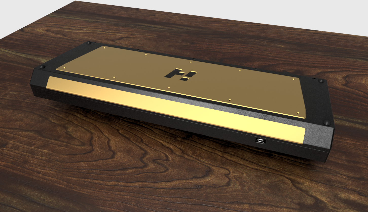

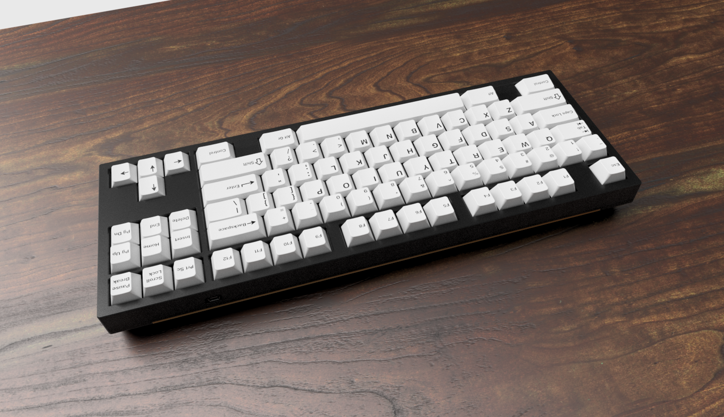

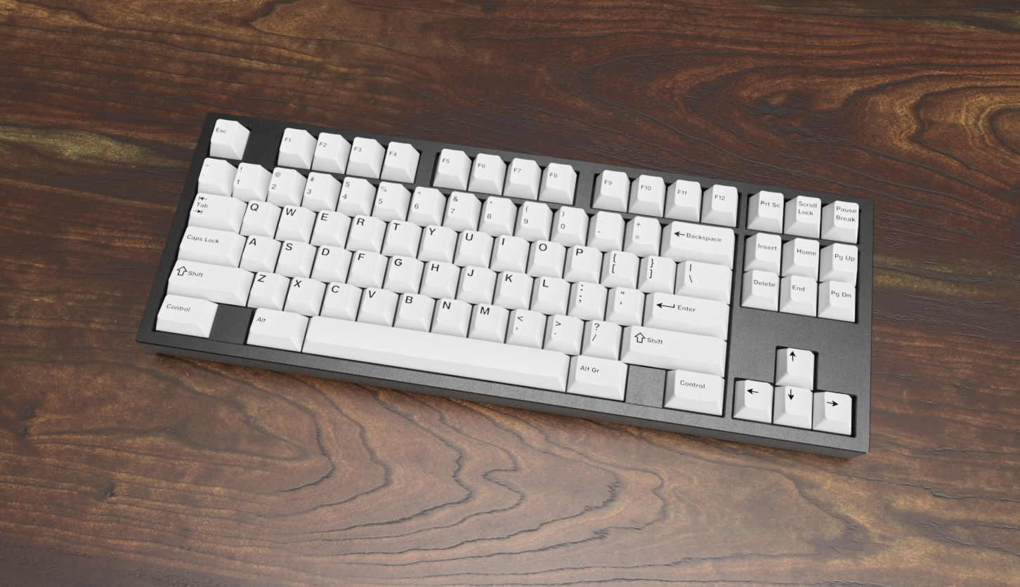

unnamed: a simple tenkeyless designed by im hide
This design is a product of my distaste for flamboyant angles and edgy design, favoring simple angles and subdued looks. Drawing inspiration from multiple sources, unnamed was born to satisfy my wants and needs in a keyboard.
The goal of this interest check is to see whether or not people even share my views on case design, and to receive constructive feedback to put into future designs. A secondary goal would be to attract the interest of prospective vendors for a bit of guidance running a group buy, else I'll be running this one on my own as a small quantity.

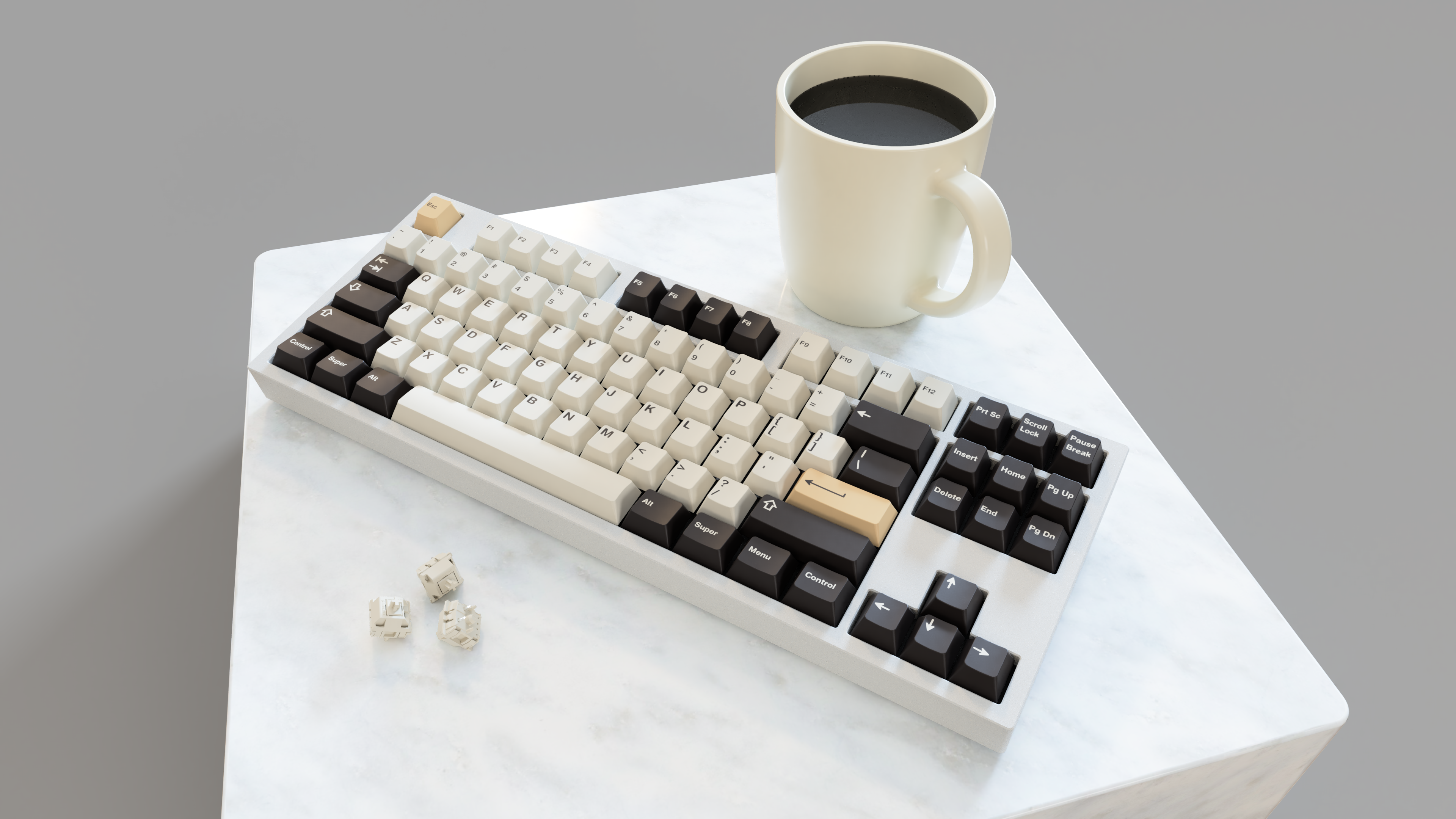

GMK Cafe on e-white
info

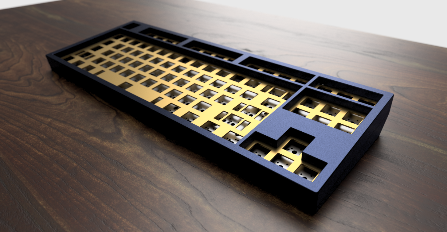

  • 7 degree typing angle
  • Top mount
  • Tenkeyless or WKL layout
  • 6063 Aluminum case
  • Matte Brass weight
  • Matte Brass or polycarbonate plate
  • $450 USD + paypal fee + shipping (Only an estimate as of now, pricing subject to manufacturer quote, and I definitely want to make this as affordable as possible)
  • Kit will include: Case, Plate, PCB, and Hex keys for assembly
  • PCB: Likely the h87a from hineybush

       More to come! Leave keycap suggestions in a reply for a render and I'll add them to a queue.

  • 8/27 | Finished the universal plate layout (Now supports WKL and ISO!) as well as the WKL top. Now on to making summore renders since the old model used a stainless weight.
  • 8/28 | Bottom fascia redesign is done. Only thing left to do is renders, and then order prototype at the end of September.
  • 10/11 | Colors are finalized (Black and White, I figure it's only symbolic to do that since it's my first launch) 40 Units will be available. Black brass hardware similar to Polaris is the goal (Black and gold would be too expensive to pull off so I went with black) Prototype will be ordered sometime in the coming days.

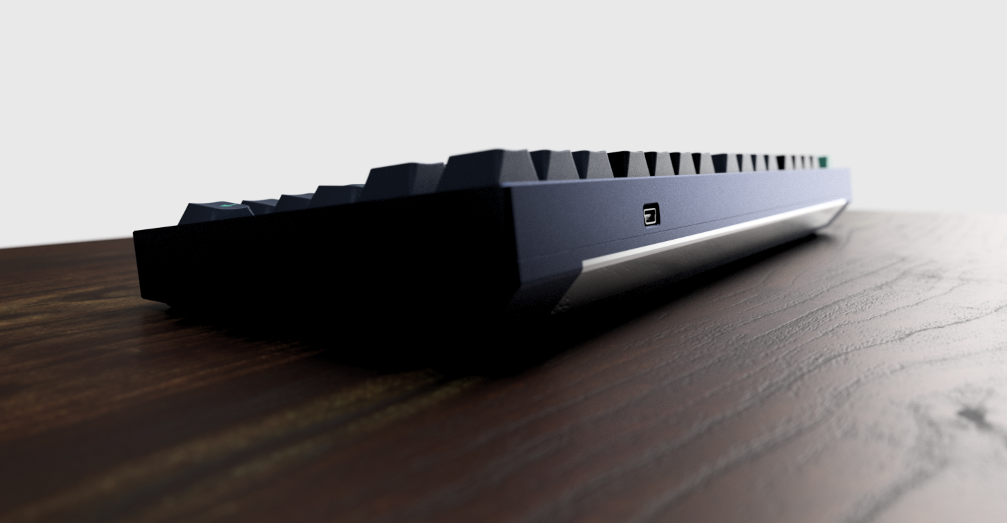

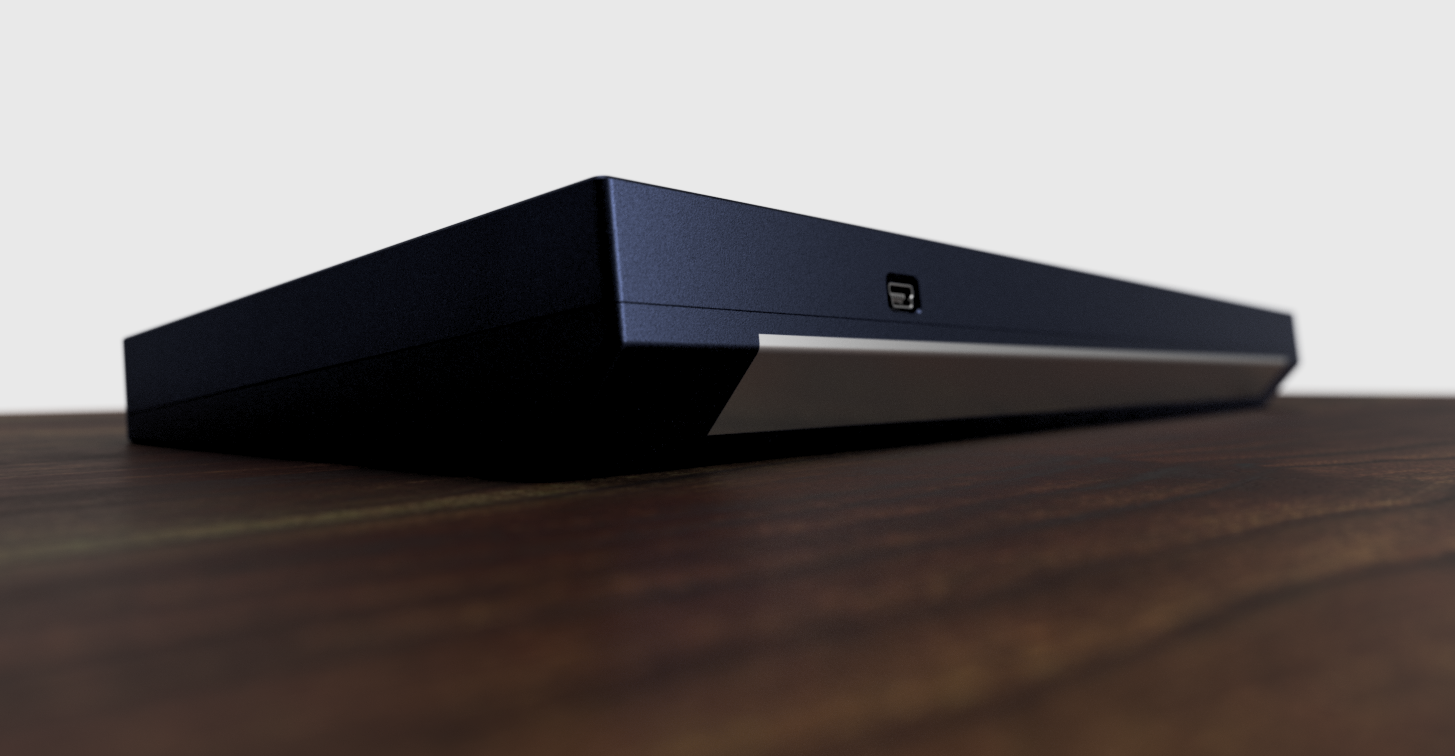

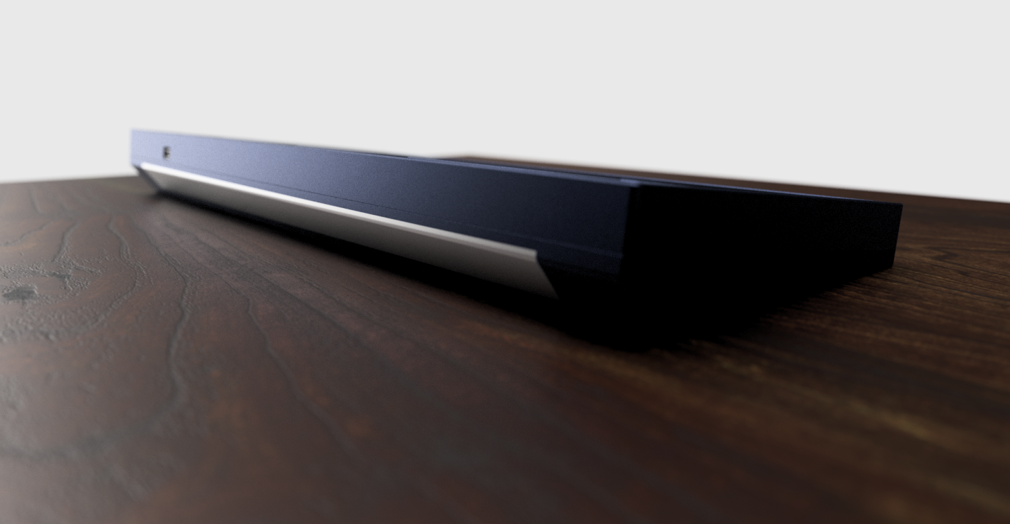

OP: “Hey guys let me know what you think of this case design.”
Also OP, to himself: Let’s add some shadow and increase the black level so that nobody can clearly make out what the side profile looks like.
Cool story bro.
« Last Edit: Mon, 19 August 2019, 03:05:08 by nguyenhimself »
Offline im_hide
  • Posts: 38
  • Location: St Louis, MO
  • dont think
Re: [IC] unnamed | a simple TKL
« Reply #5 on: Mon, 19 August 2019, 03:05:25 »

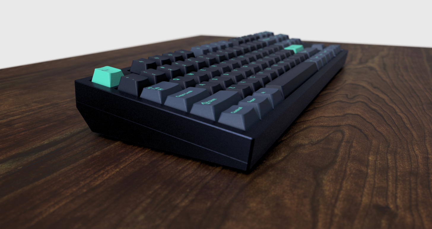

Also OP, thinking to himself: Let’s add some shadow and increase the black level so that nobody can clearly make out what the side profile looks like.
Cool story bro.

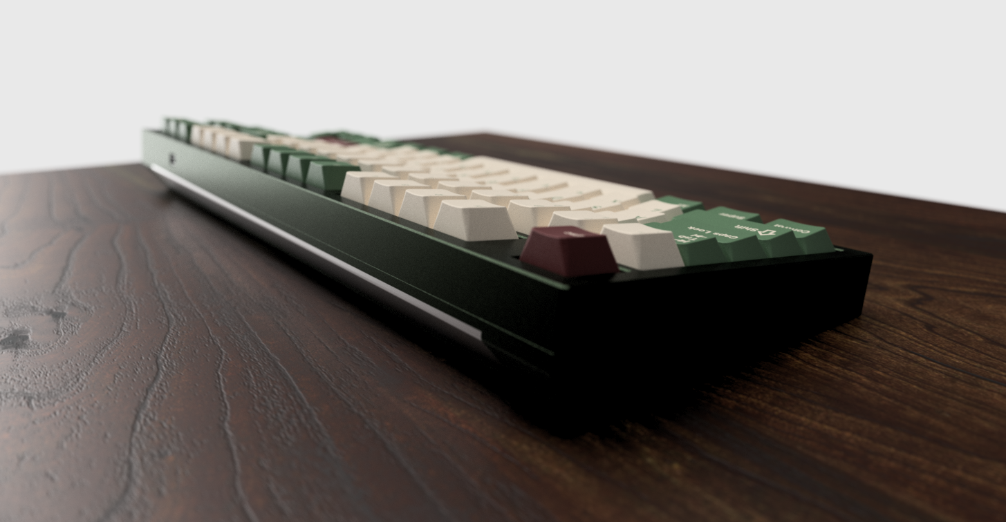

noted, although there is a render with a very visible side profile.
edit: added another brighter side render with GMK Hammerhead which should very easily convey the profile.
« Last Edit: Mon, 19 August 2019, 03:19:04 by im_hide »

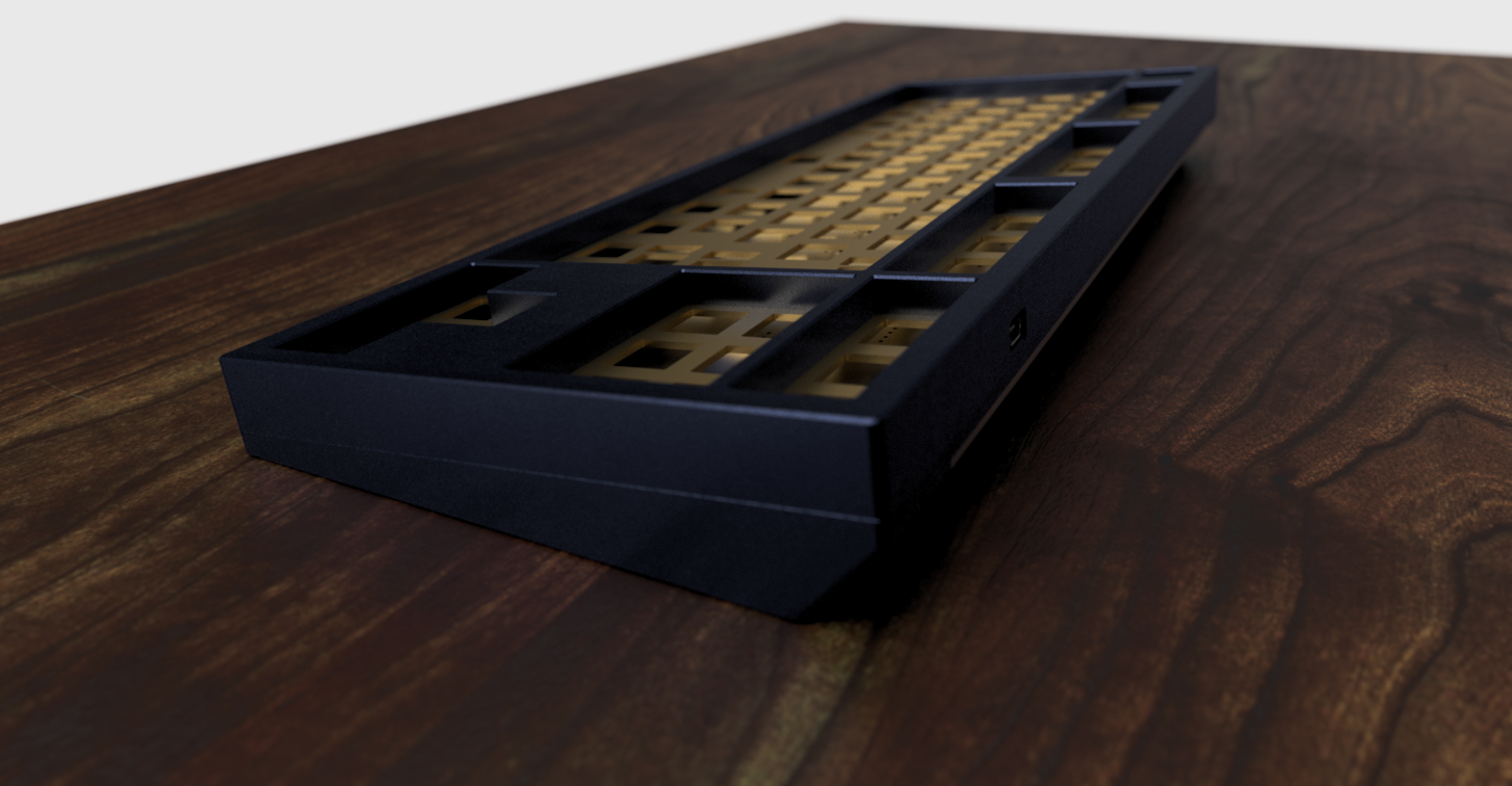

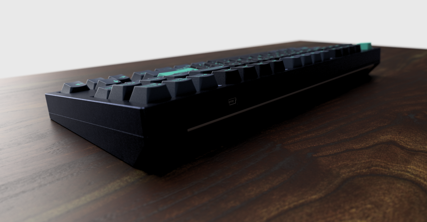

I like the idea and have some suggestions:
- Option for WKL layout. It's not just for the cool look, it's actually a must for Cherry OG keycaps user (myself included)
- Side profile looks chunky and actually quite impractical. It's the same issue with boards like the TX87/84 series as they don't have gripping points on the side.

Colour me interested if the plate / board supports ISO. I have a WASD v2, would like something similar but in premium materials so this would be right up my alley.

I don't think polycarbonate is feasible with the weight design of this version. However, that doesn't mean I'm opposed to doing a polycarb version. This case was desgined with the strength of aluminum in mind, but with a moderate redesign of the weight it would definitely be possible to make a polycarb version. I might consider doing a separate run for it in the future.

Aluminum might be a good substitute for stainless if I'm looking to cut back on price a bit. I don't have much interest in running a brass plate with this design since it's mostly faded mixed with neutral colors. Another plate material I'd like to run is FR4 (Fiberglass) potentially mimicking the plate material selection of Polaris, less brass. As for the other design changes you mentioned, most of them are extremely subjective, but not without warrant. In my opinion mixing the neutral colors of silver and black with a color such as dark forest green or navy doesn't clash, and in fact I think some diversity is needed in materials. Asking some of my friends which design they preferred (full stainless vs mixed carbon and stainless) they almost unanimously preferred the carbon fiber bottom. I think what I have now strikes a good balance between the two. I also think there are other features of unnamed that set it apart from Jane and, to be frank, yuktsi just did it right and there's no point trying to improve on it.

WKL is definitely something I understood is a functional thing and not just aesthetic. I definitely want to give people the option of a WKL layout if they so desire. As for the side profile, I'd have to disagree. Just because most modern keyboards have massive undercuts to make moving easier, that doesn't mean it's impossible or even noticeably more difficult to move a keyboard without them. On top of that, the 35 degree angle in the back makes it easier with a little bit of practice than say a U80-A. All that's really required is a bit of technique.

Will support ISO. AFAIK the h87a supports ISO as well.

This is basically the Jane V2. Your weight is like identical.
Just checked Nathan Kim's video to make sure I wasn't crazy but mine is actually a weight that slots into the case like this
and the carbon fiber piece serves to hide the screw holes from the bottom of the case that hold the weight in.

I gotta say this just looks way too similar to a Jane v2. The backweight, despite differing mounting/size, is still aesthetically nearly identical to the Jane back weight. The bottom plate is also damn near the same, even with the cut out corners for bump-ons. Might wanna take this one back to the drawing board.
Offline im_hide
  • Posts: 38
  • dont think
« Reply #23 on: Mon, 19 August 2019, 10:31:24 »
The weight is really functional to the design because of how I like to angle the backs of my cases. However I've already discussed with Dixie and we've come to the consensus that both the weight and bottom plate together are just way out of line. I've scrapped the carbon piece and am revising the design to more fit the case.

I might like this if I could actually see the case design. Also, the plain and flat bottom with two screw holes leaves a lot to be desired. It's just kinda meh.
Some standard bump on sized holes on the bottom for easy replacement with the 3m type that just about every tkl uses would be a better option.

I agree with the statement above regarding the side profile having something to grip - the "wedge" without a ledge to grab onto isn't too nice in my opinion. For the weight - I personally like the look of sandblasted brass (possibly clear coated to prevent tarnishing) compared to shiny finishes like PVD or stainless. Also, the price stated may be a bit high in the current market - the recent kbd8x at $300 is similar as a basic top mount tkl. With your simplified design, a cheaper price point would be appealing as it doesn't look like it would be overly complex to machine.
Offline im_hide
  • Posts: 38
  • dont think
« Reply #26 on: Mon, 19 August 2019, 11:12:22 »
I agree, will update pricing.

Left or Centered usb ?

PCB: TBD (case is currently designed around the h87a, so I'd like to speak with hiney about getting some manufactured for this)

Some renders of what I've been working on:
I've been toying with the idea of an inverted logo kind of like kyuu or kira boards, where instead of the weight being the logo insert, the bottom of the case is the "insert" and a brass fascia is used to provide the contrast.
Let me know your thoughts!

« Reply #49 on: Thu, 29 August 2019, 03:15:03 »
Looks good! I'm a fan of the logo too, I like the inverted look, although the screw holes on the bottom are a little in your face; would it be possible to attach from the inside? I assume that's what most customs do to achieve a cleaner look
