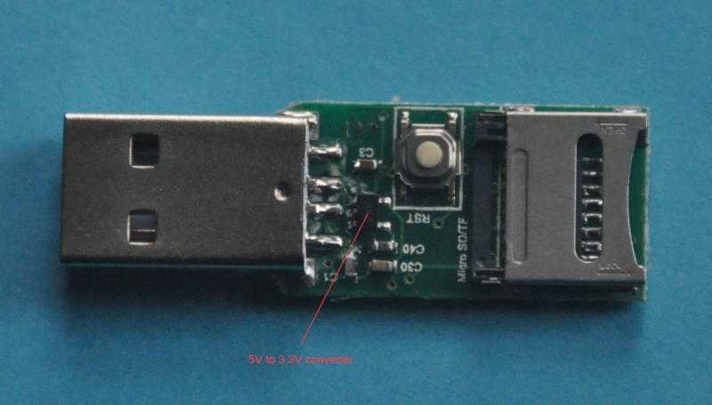

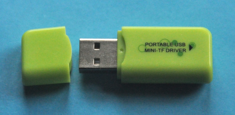

Built myself a neat converter today :-)
A while back I spotted some console hack dongles on sale for only $10, that have ATmega32U4 chips in them. I bought two, but unfortunately one was DOA. Oh well. The other one works fine. There's a schematic for it.
12216-0
It started off looking like this inside...

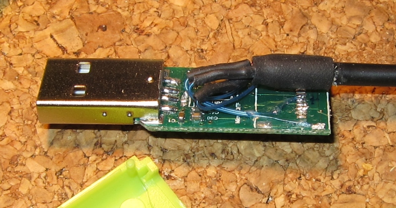

12218-1
Then I...
Removed the card socket.
Removed the 3.3V regulator and replaced it with a bit of wire, so that everything was running at 5V.
Soldered some thin single core wire to two pins on the chip for data and clock, and two SD card socket pads for power and ground.
Used hot glue to (hopefully) keep them from coming loose.
Cut the trailing socket from a PS/2-USB adapter (a crappy Belkin that kept reconnecting).
Put some heatshrink on near the end of it to stop it pulling out of the case.
Joined it up to the single core wires, with heatshrink on each connection.
Filed a hole in the case for the cable exit.

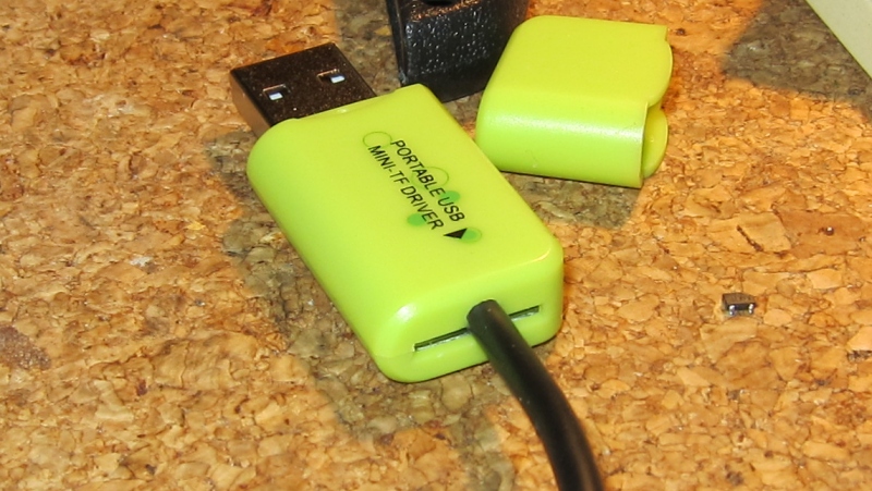

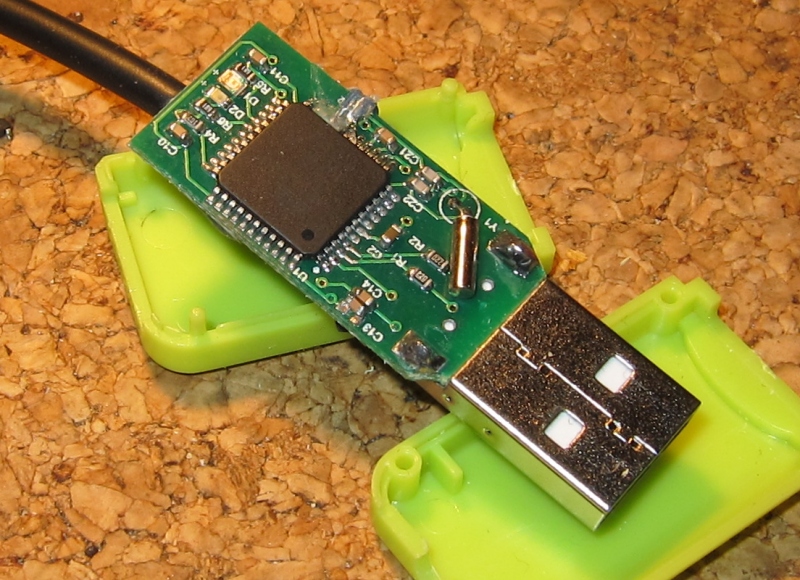

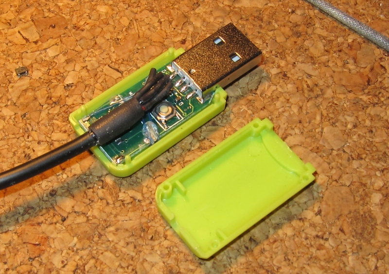

12220-2
12222-3
12224-4
12226-5

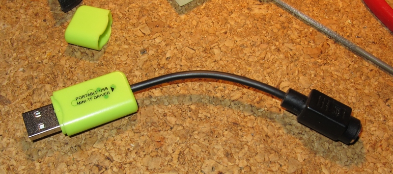

And ended up with this...
12228-6
« Last Edit: Tue, 22 January 2013, 06:53:46 by Soarer »

SWEET! Nice package to keep your converter in!
Since it uses Atmel's stuff to program it, is it compatible with the Teensy programming utility if you reflash the Bootloader?
« Last Edit: Sat, 03 March 2012, 13:12:16 by SmallFry »

« Reply #314 on: Sat, 03 March 2012, 13:23:01 »
Thanks! Still one thing left to do... drill a hole in the case so I can reset it for flashing without taking it apart. Just pondering on exactly how I'll do it - thinking about gluing a flat piece of plastic onto the reset switch, so that it fills the gap between the switch and the case. Hmm. Anyway, the spot to drill is neatly marked by the cross of the 'T' in 'portable' :-D

How much does the case flex in that spot?  You might not need a hole, just fill the gap with a chunk of plastic and squeeze it to actuate the button.

Quote from: SmallFry;534039
Sorry, missed your edit... No, it's not compatible with the Teensy utility, and you can't load the Teensy bootloader onto it (or anything else for that matter, since you can't get the Teensy bootloader off a Teensy!). Atmel Flip works fine though, the 'problem' is just that the bootloader takes up more space than the Teensy one.

Quote from: alaricljs;534047
Hardly any flex, surprisingly, but it might _just_ work... with a very firm squeeze!
The other alternative is to figure out how to reboot to the loader from firmware, and then trigger it from a key combo, or by sending it some rawhid on the config interface.

It should work fine on any 32U4, as long as you can get it in there! The dongle I adapted has the Atmel bootloader on it, and that works OK.
I might be able to trim my code down to 16KB, but I'm not sure if I could get it down to 12KB to leave room for the bigass Atmel bootloader :-(
And of course, I'm not sure I can keep it under 16KB as I add new features.
The other issue is RAM - the 16U4 might only have enough for basic functionality (i.e. no layers or macros).
