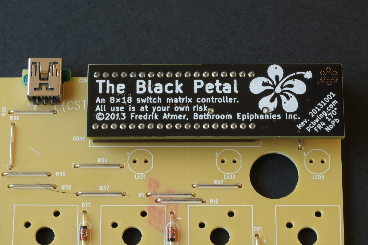

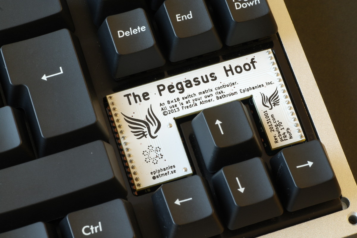

Offline bpiphany
  • Posts: 1033
  • Location: Stockholm, Sweden
Re: Replacement controllers - Filco, QuickFire, Rosewill, (others?)
« Reply #130 on: Thu, 17 October 2013, 15:50:24 »
Oh how much fun to see the speculations =D
* jdcarpe  gasp*
Is it real?  :eek:
It's definitely physically sitting on my kitchen table.. It's not for real yet though. I didn't have time left to try to build one yesterday. I was building some of these Filco TKL replacement controller
39666-0
And just now I have successfully adopted my firmware and tested that I got everything correct.
I was also building some of these for the Rosewill
39668-1
but I don't have time to work on the firmware tonight, so they remain untested this far. I have high hopes for tomorrow though =)
The tiny one is planned to be a general controller board for DIY projects. Having everything assembled from factory (if the prototype works out). It has one ATmega32u2 and three 74hc138, that gives 24 mutually exclusively selectable outputs and 15 general IO pins (including RX/TX MISO/MOSI/SCLK and 3 of them with PWM for LEDs). I need to gather some courage to try to build one tomorrow. And sleep, coffee, and a loupe... The header rows are on a 0.3" spacing, and the hole thing is 1.2" long. With bent headers it will be kinda like a wide SOIC package.
« Last Edit: Thu, 17 October 2013, 16:01:37 by bpiphany »

Just finished coding the Black Petal as well. Everything seems ok. It was a bit finicky to test as I only have the stripped PCB from one.
I added the new controllers to the classifieds thread http://geekhack.org/index.php?topic=46700
