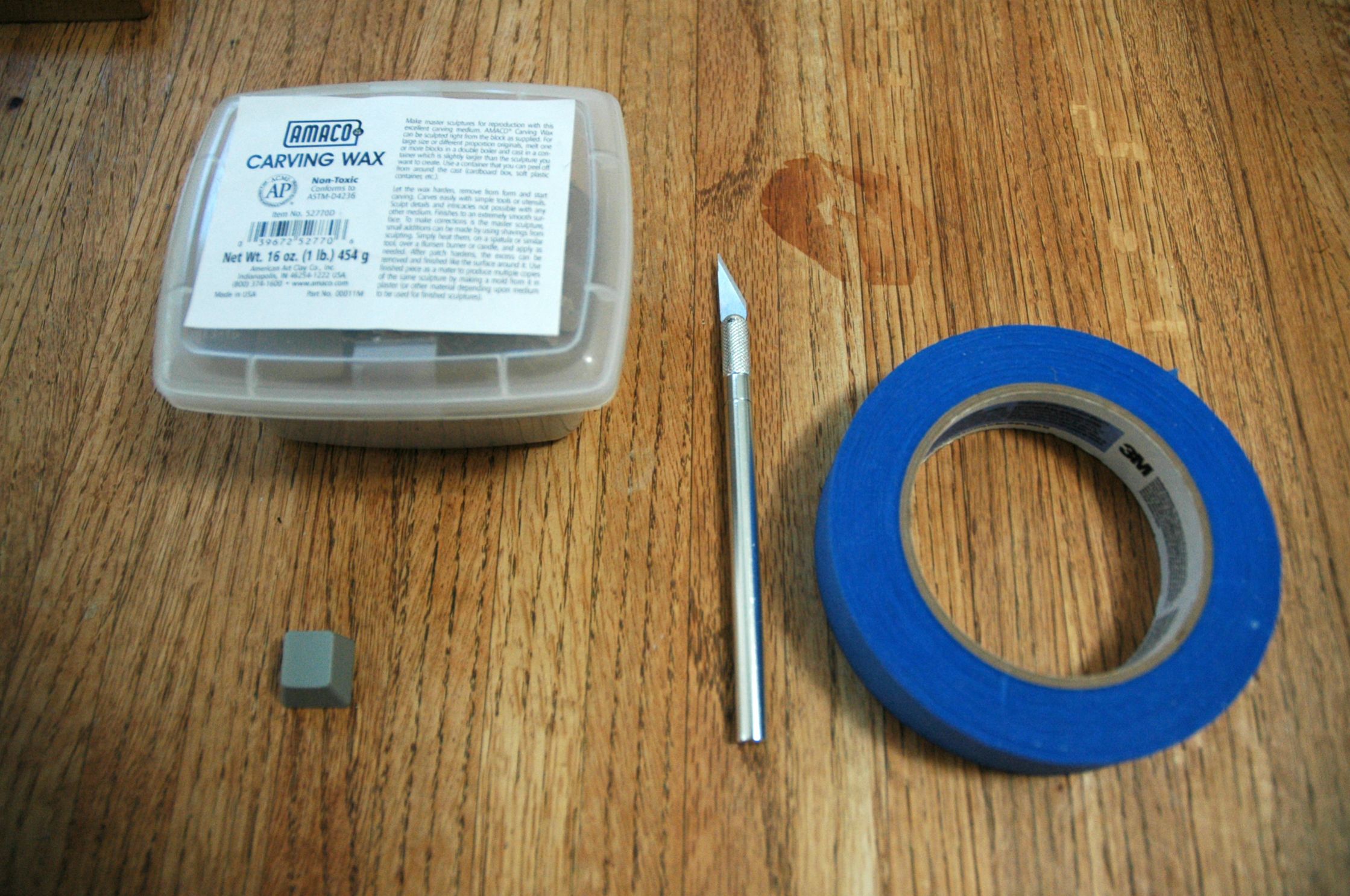

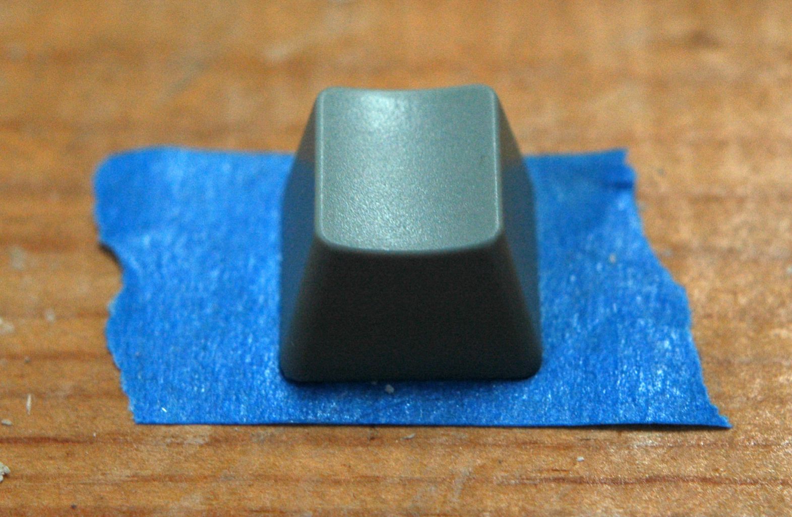

To begin, you'll need a volunteer key cap, masking tape, a razor blade, and some carving wax or some other carving medium (you could probably use some Crayons if you wanted).  For my key cap, I used one from the WASD sample kit.
16031-0

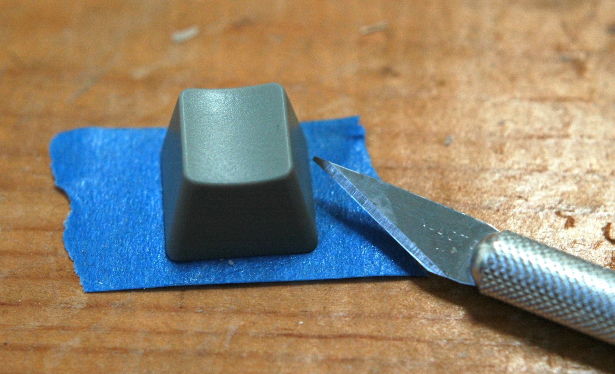

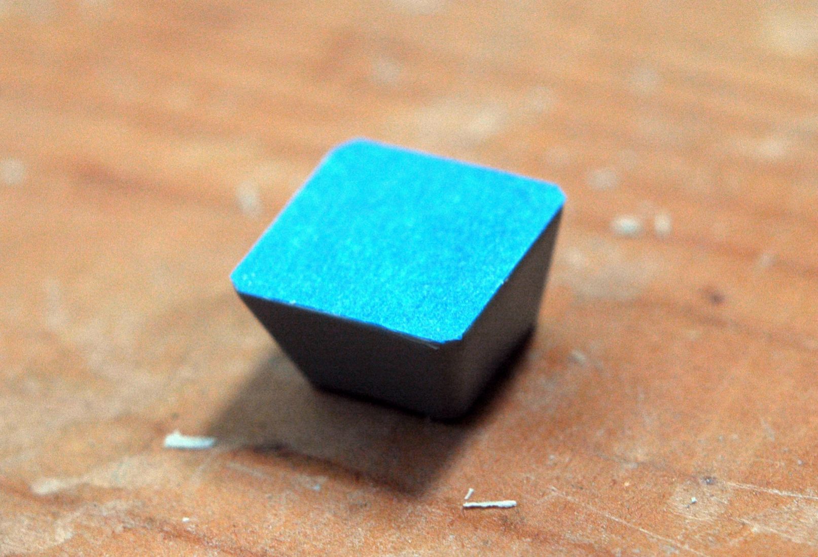

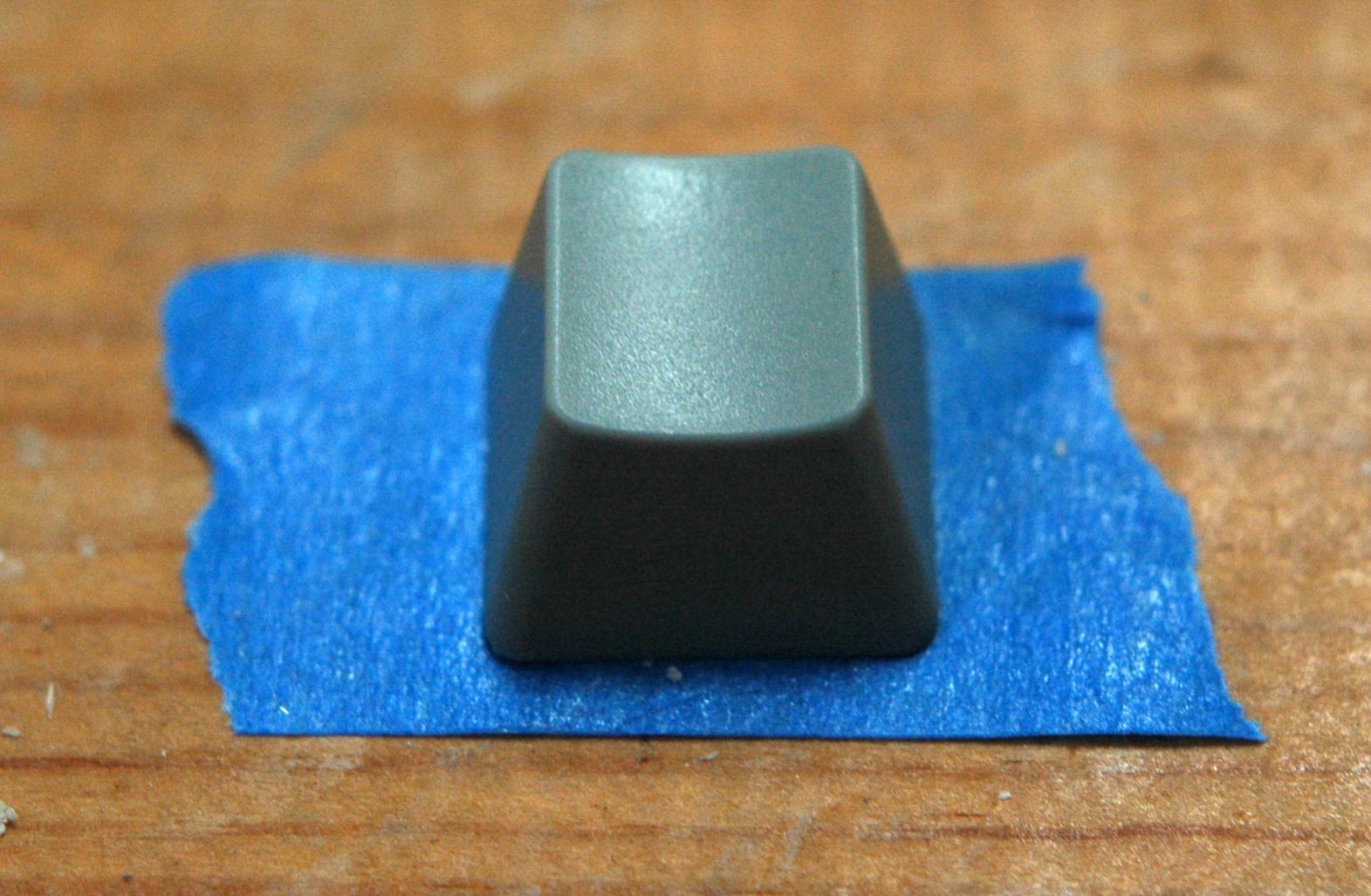

Set the cap on the masking tape.  Try to make it as flat as possible.  Then cut the tape flush with the key cap.
16033-1
16035-2
If you did it correctly, the base should look like this.

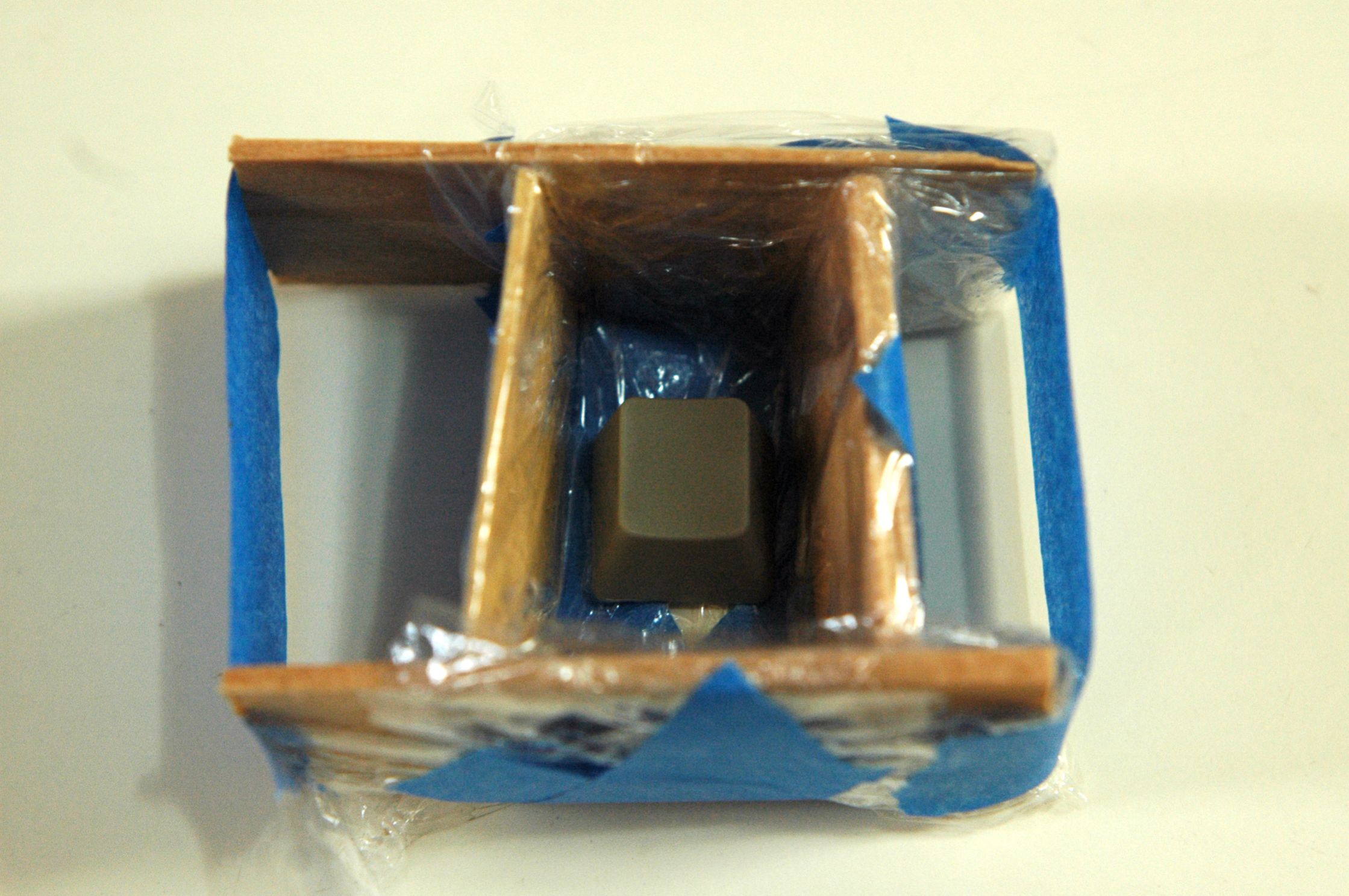

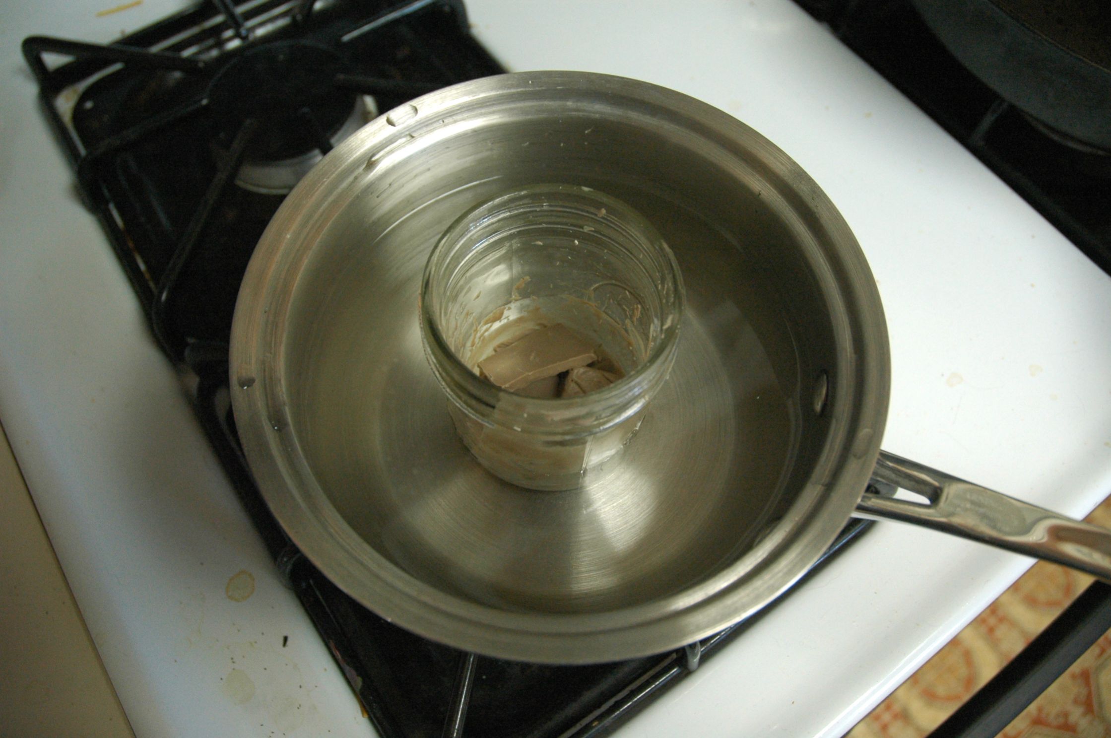

Next, you need to melt the wax.  Use some sort of double boiler method to melt the wax.  I did mine by using a canning jar in a sauce pan.  Medium to medium high heat should do it.  You may need to use something to stir it to make sure it's properly melted.
16039-4

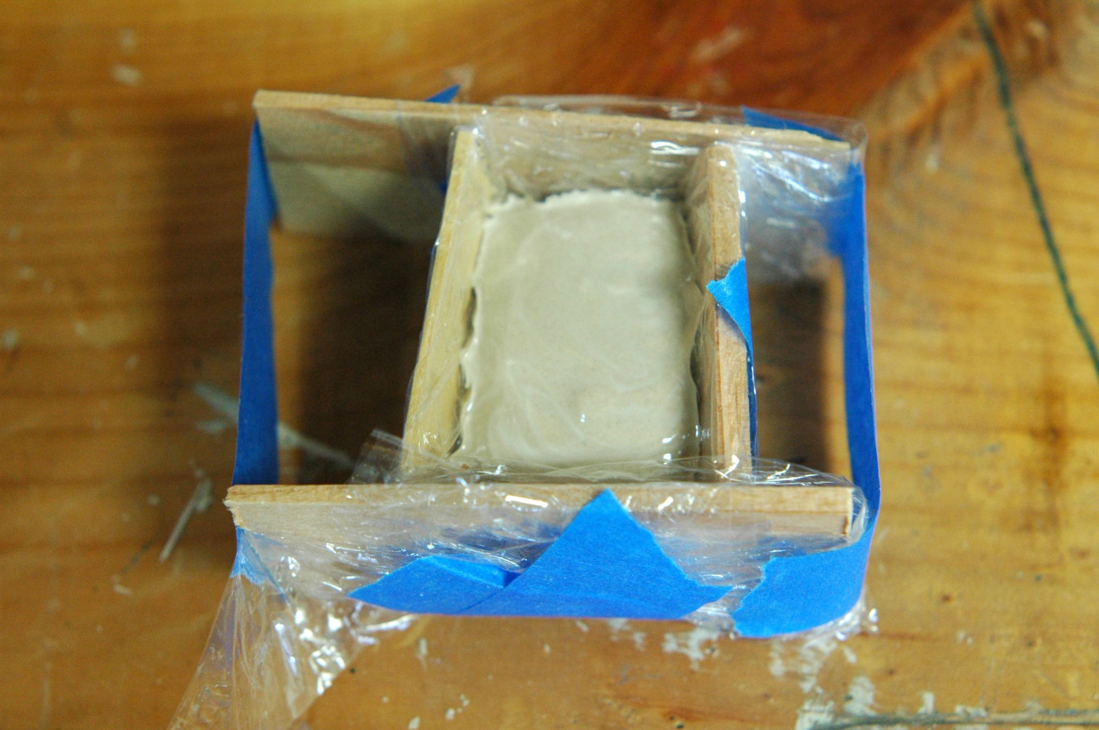

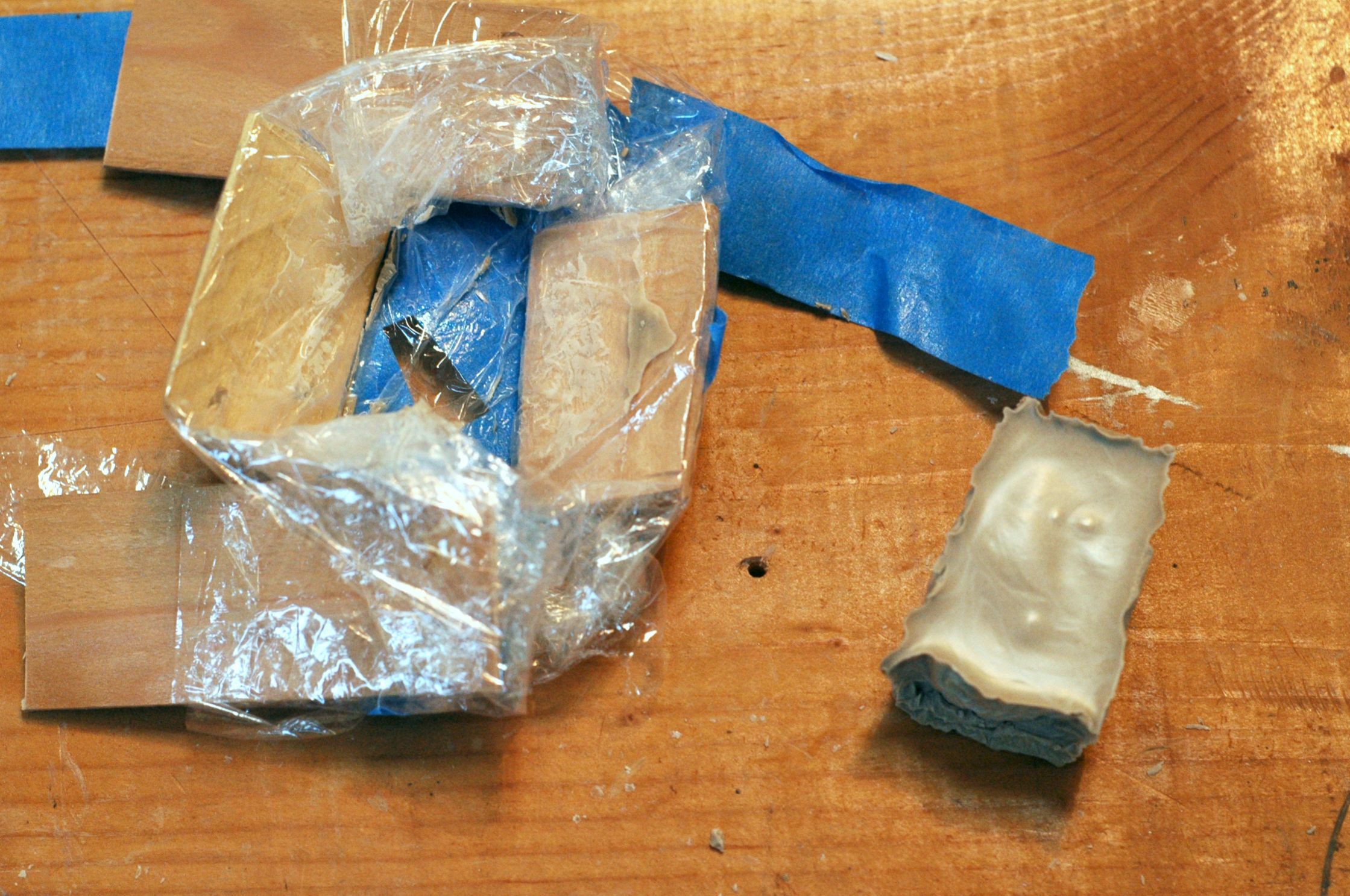

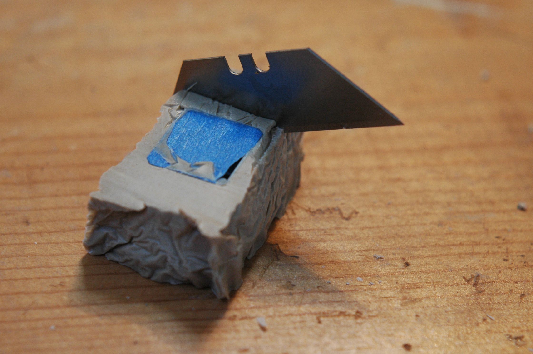

This was my first go at a wax mold. It's a wooden shim lined with saran wrap and taped together.  Just carefully place the key cap in face down.
Later I used a cardboard mold lined with saran wrap that was a little easier and seemed to work better.
16041-5

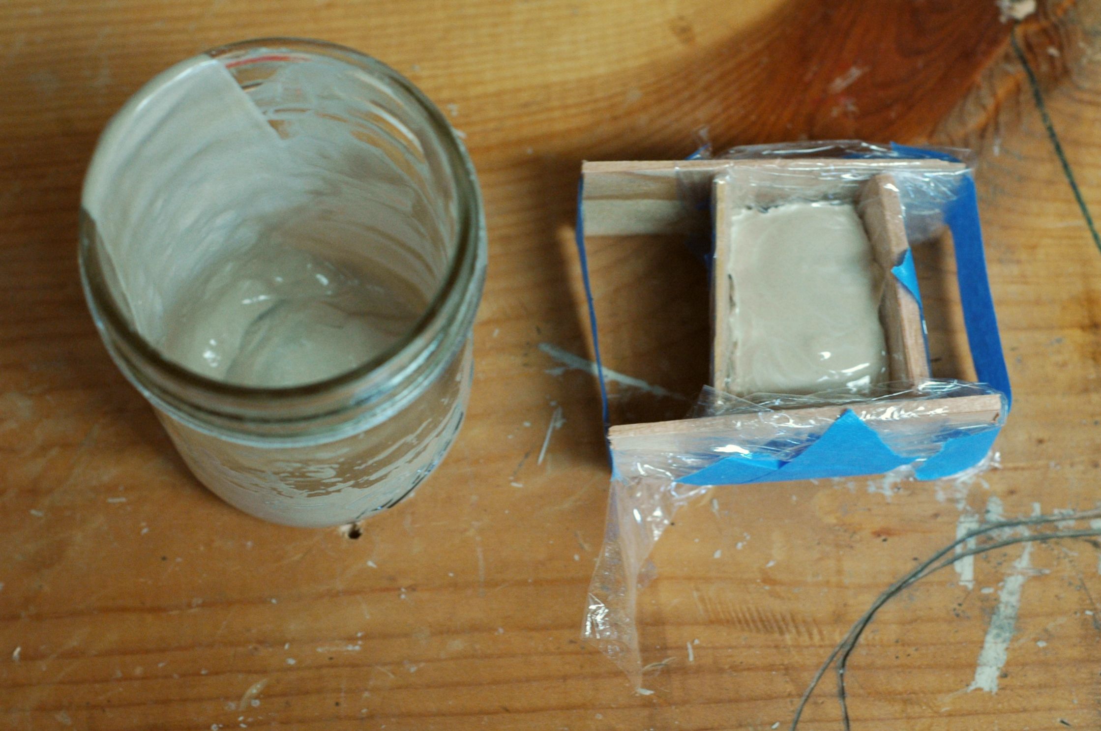

When the wax is melted, slowly pour it over the key cap.  Following that, let the wax sit for a little bit to cool down, but make sure not to wait too long.
16043-6
16045-7

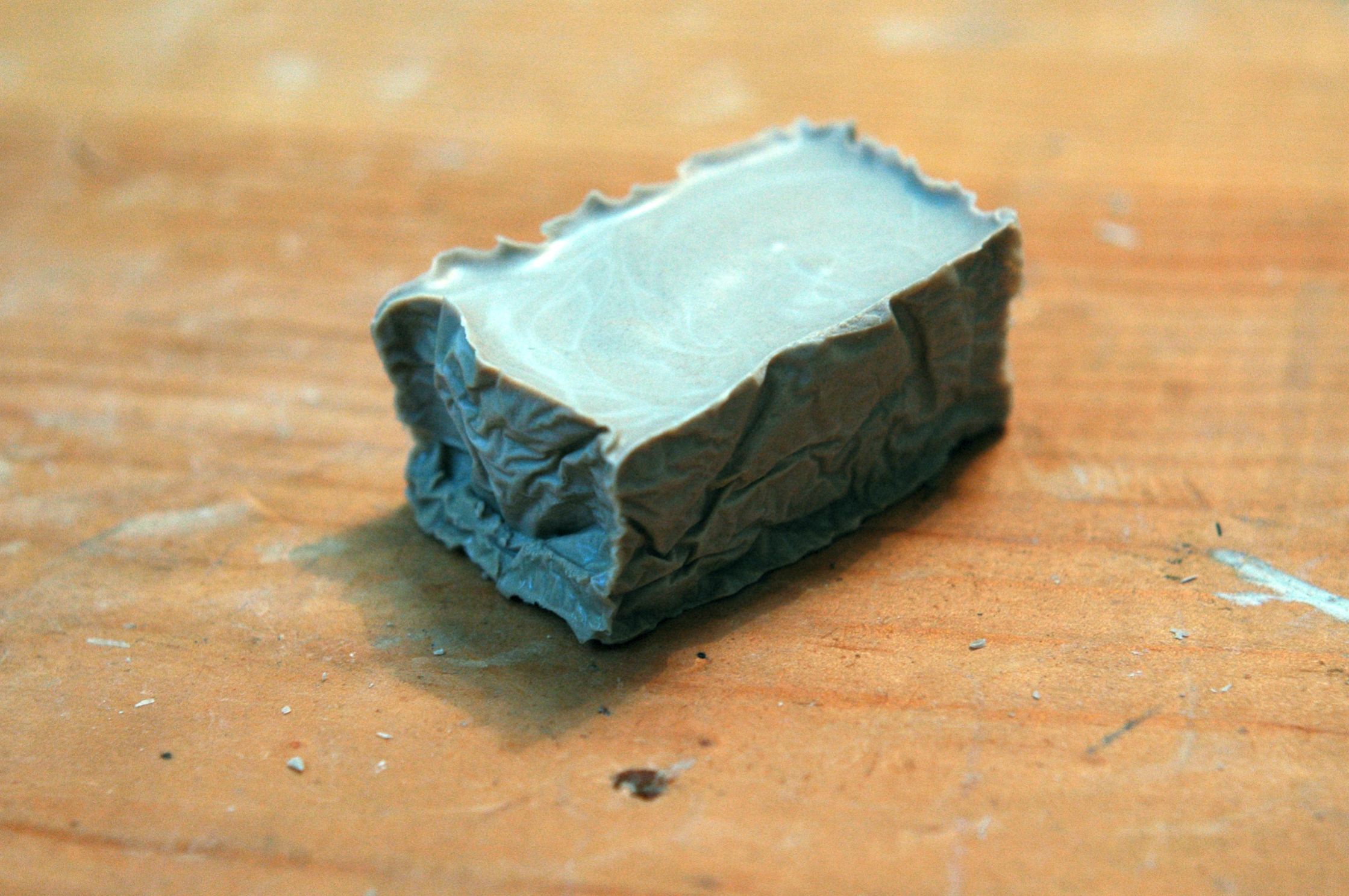

Open up your mold and let it loose.  If you did it correctly, the wax should look something like this.

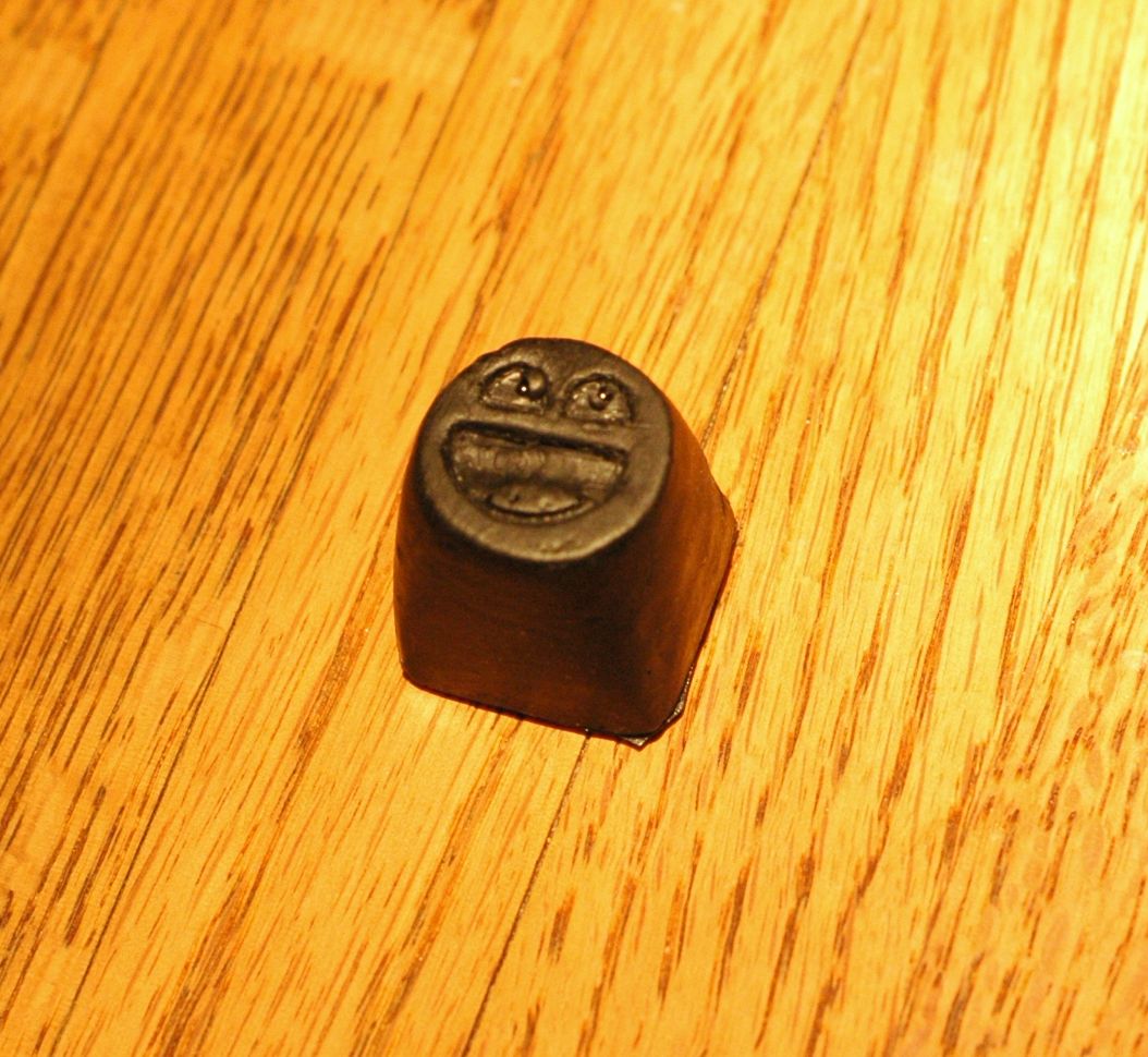

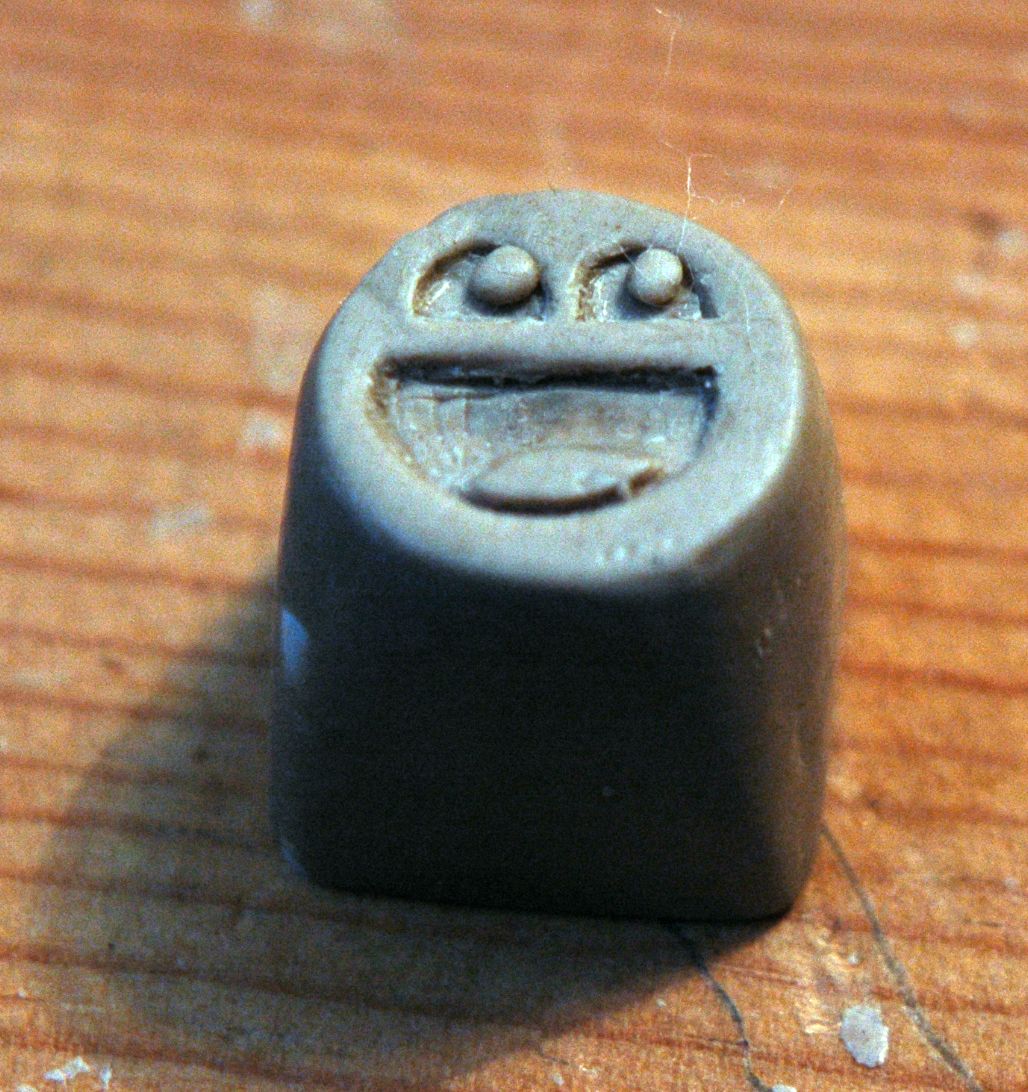

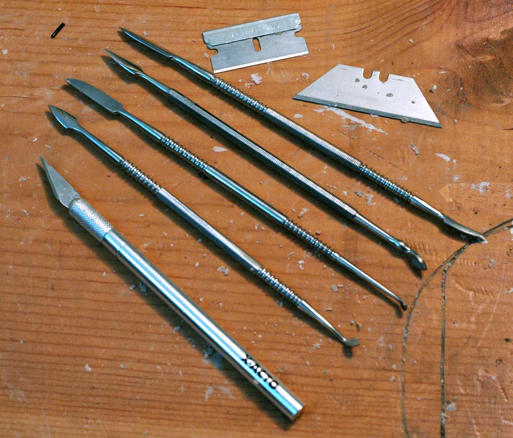

Here are the tools I used to then carve the key cap.
16053-11
Here's the finished product.  I'm not the most skilled artists, so I wanted to start with something a little easier to carve.
There are some problems with this cap that I didn't notice at first go.  First, it's way too tall and looks silly.  I had about 1/8" more room to carve down that I just didn't think about.  Second, I didn't follow my advice and left the sides a little too thick.  Third, I carved it sideways.  I forgot to check which side was the front of the cap and carved it 90 degrees off.  I corrected that last problem by rotating half the mold 90 degrees, but the other two weren't noticed until the mold was already made.

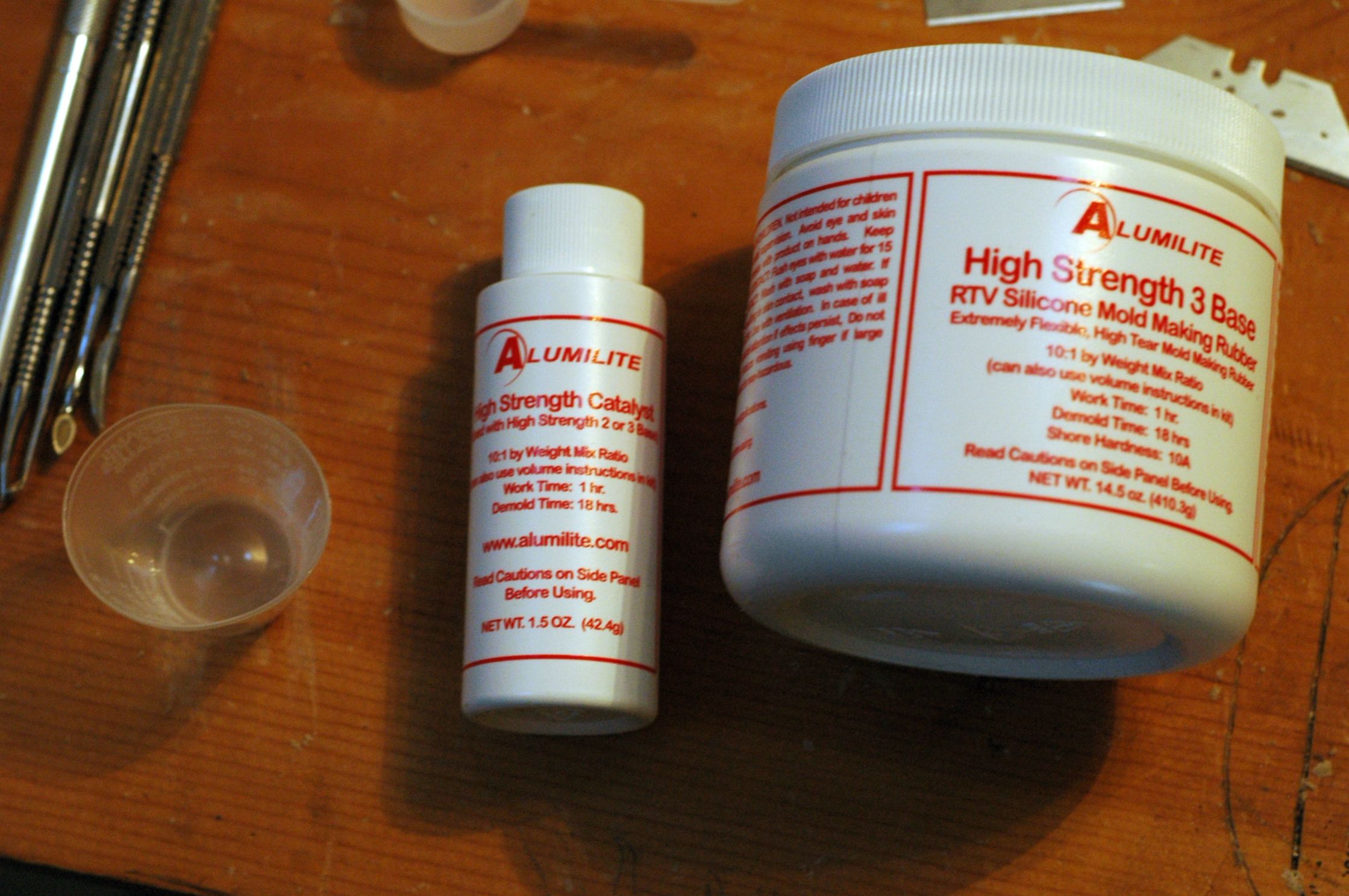

For the molding supplies, I bought some Alumilite stuff from Hobby Lobby.  If you use their 40% off coupon they always have, it's not too expensive.  I think I bought the wrong molding silicon though and got a softer mold than I would like.

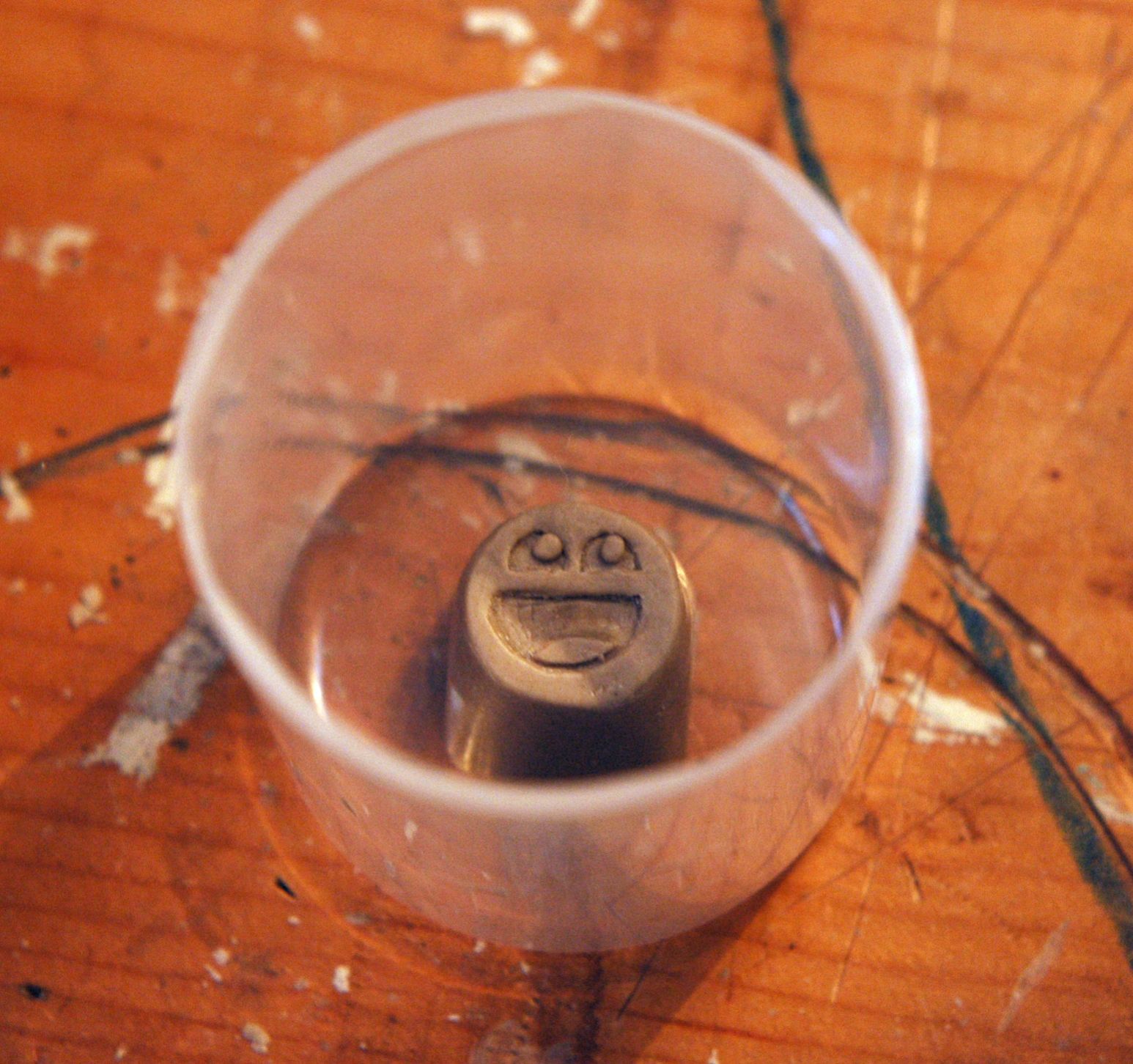

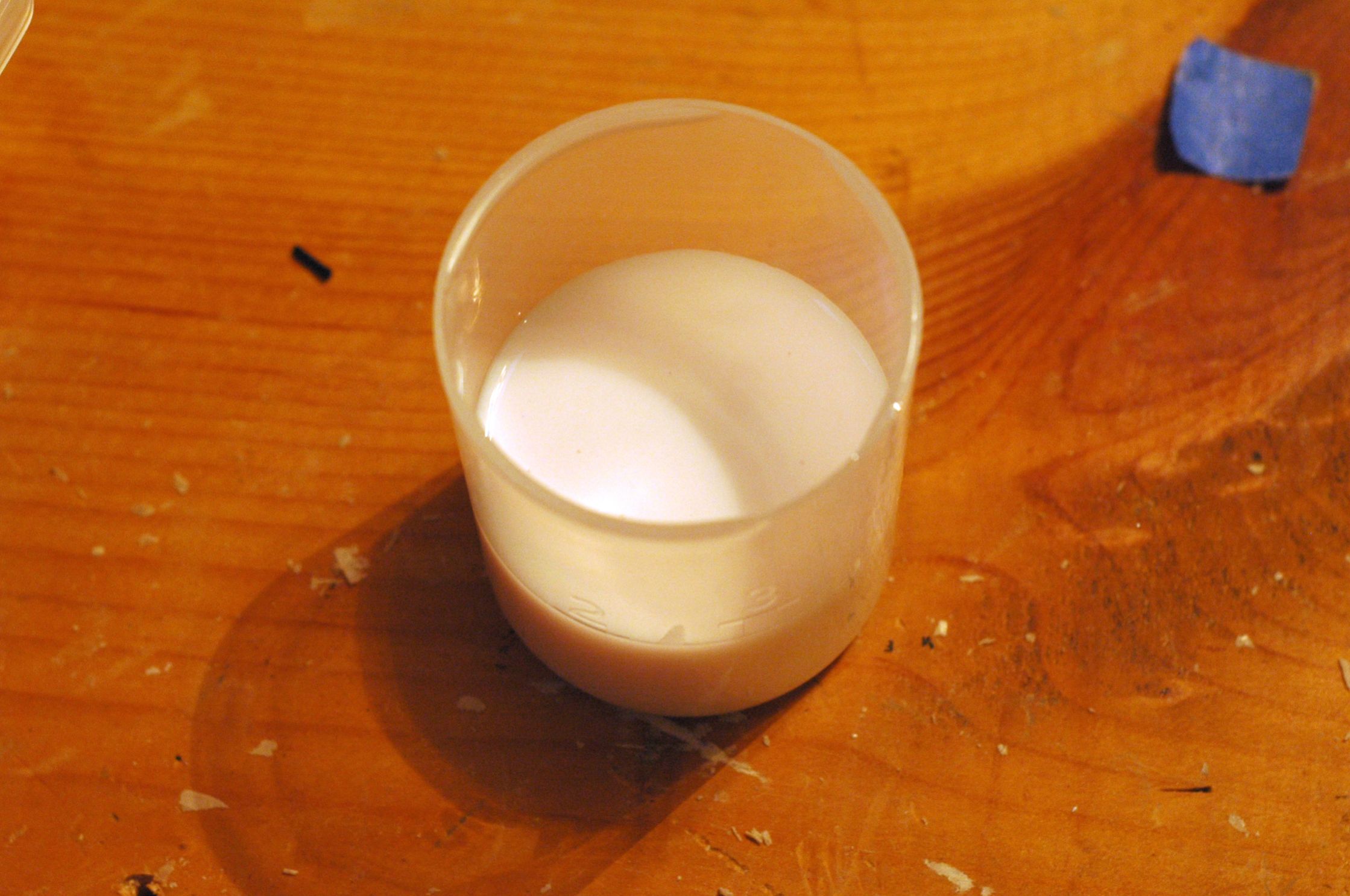

Mix your silicon with the reacting agent and pour it onto your keycap.  Wait overnight before pulling it out.  Since your mold is a two part mold, know that the mold making process is at least a two day job.
16061-15

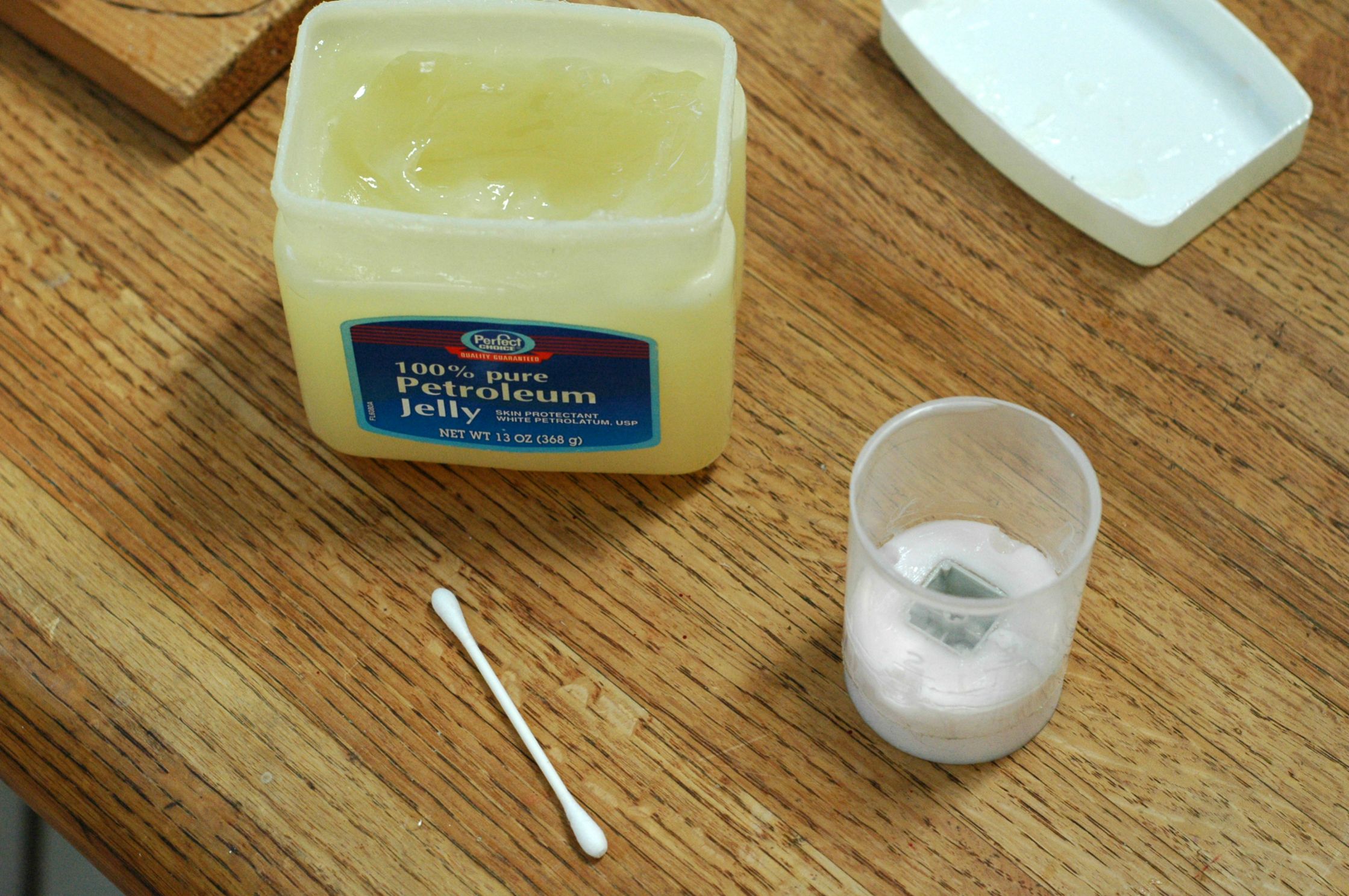

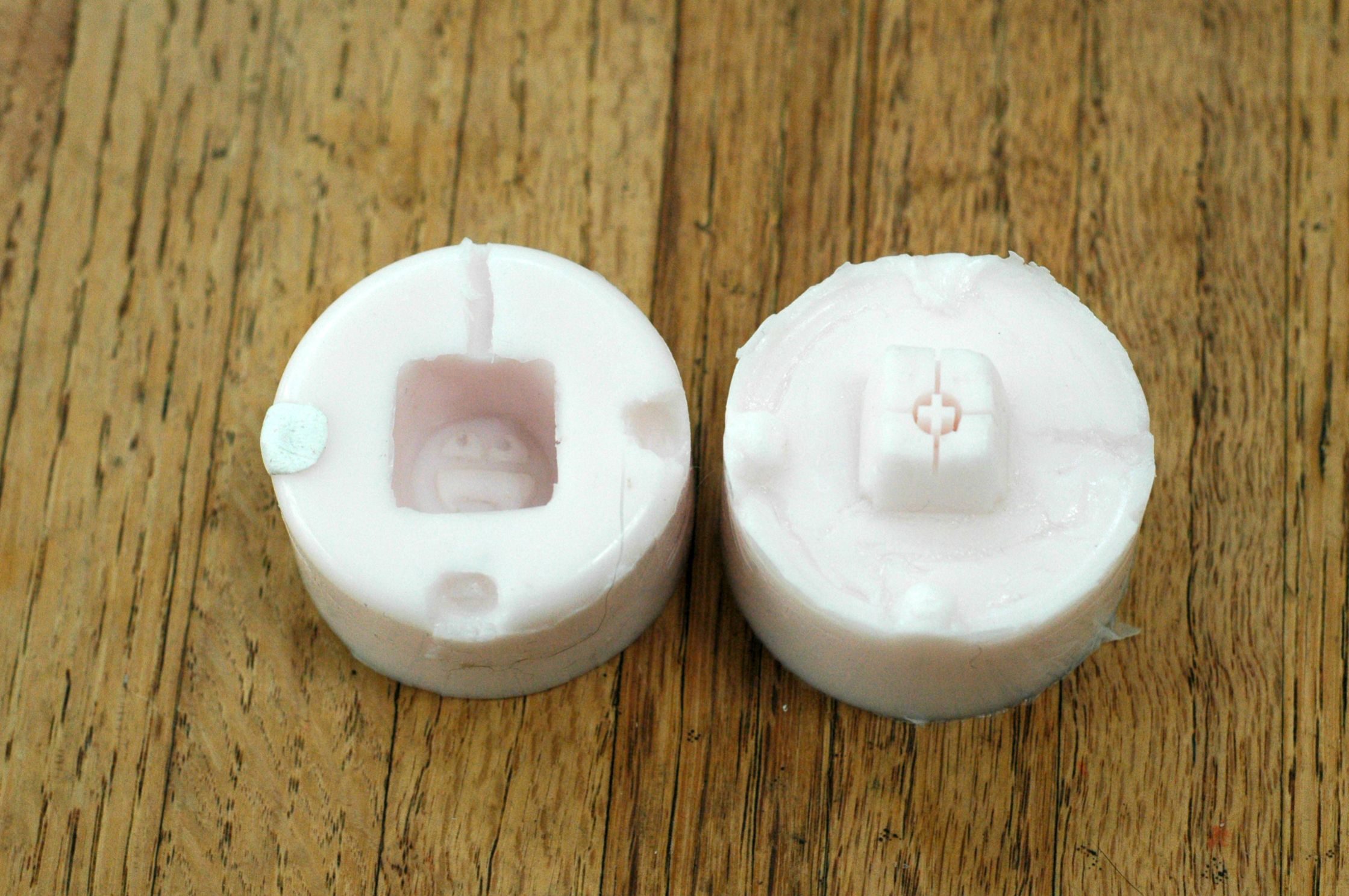

To keep the two halves of the mold from bonding, you'll need some sort of mold release.  I used petroleum jelly for mine.  I just melted some in a spoon and applied it with a Q-tip.
I also cut the base off of the detergent cup so I could slide it over the first half of the mold instead of pushing it to the bottom.
Then just mix and pour the silicon like before and wait till the next day.
16063-16
When you're done, you should get a mold like this.

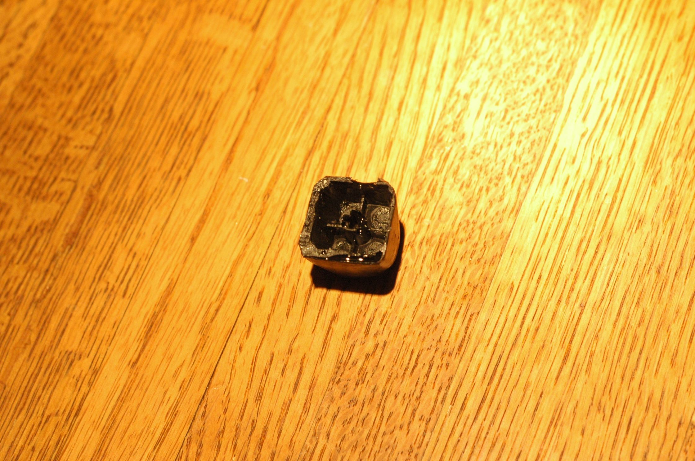

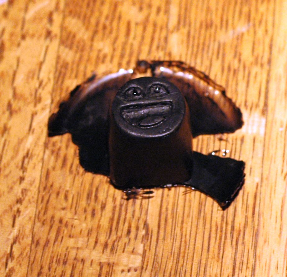

For my first try at a key cap, I used some resin. You'll naturally have some resin that pours out the edges that you'll need to trim up.  When you pour the resin, you'll need to wait 48 hours before attempting to demold the cap.
I'm not really happy with how it turned out.  The top half turned out alright (the eyes are a little messed up)...but there are some issues once you flip it over.
16067-18
16069-19
As you can see, the stem didn't turn out quite right.  It still fits just fine and actually holds it to the Cherry stem, but it has some wobble and play.
16071-20
16073-21
For a first try, it wasn't horrible, but there certainly needs to be more experimentation with materials used to make it right.

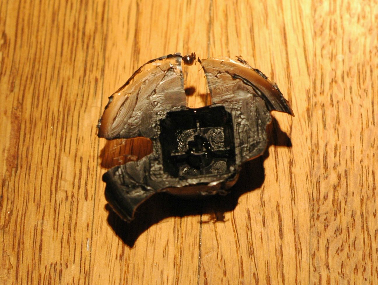

So far I'm at the mold-making stage, already managed to melt several stock keycaps (don't ask).  Wish me luck!

I was trying to make a mold from a stock cap, using Fimo (modeling clay).  This clay is oven-hardening, at 110 Celsius.  I left the key caps in the clay, as it's pretty soft, and found out the hard way that that temperature is plenty hot enough to warp stock Cherry keycaps.  Yeah, I'm a dumbass.  :-[
Interestingly, though, the PBT keycap kept it's shape just fine.
Now I'm letting the second mold harden without heat, see if that works.

I did manage to extricate my sample key from the second mold I'd made.  I used a two-part rubber kind for stuff for the base, that's the yellow.  Once that was set, I sprayed it all down with mold release and poured a two-part epoxy casting over it, brand name is EasyCast.
16334-0
16336-1
16338-2
16340-3
Pretty happy with how it turned out, the details are nice and crisp for the key stem, which is what I was worried about.  Label says the product sets in 24 hours, but fully hardens in 72 hours, so I'm going to let it cure before trying to cast a key cap.
By the way, the epoxy product is clear, I tried my hand at tinting it a light blue.  I also noticed that the two Escape keys I had on hand were different profiles, one was shorter (OEM?) than the PBT unit.  I used the taller cap for the impression in  the rubber mold, and the shorter cap for the epoxy base casting, figuring this will give me an option to cast a thick-topped key, perhaps in a different color-way for the top part of the cap.  Not sure I'm explaining that very clearly, but I'll post samples once I have some.

So making homemade key caps is something that I've been wanting to try for a while.  I'm not what you would call a skilled artist, but I figured that if I can get the technique figured out, I might be able to get a friend who is to assist me.  I figured I'd share my results and my process so that anyone else who wanted to try to do the same could do it.
Next, you'll need to trim the wax to your carving size.  I highly recommend doing this while the wax is still warm and easily pliable.  You'll want to trim and even the base and get as close to the side wall as you can.  If you don't get close enough to the sides, your cap will be too wide for your keyboard, a problem I ran into with this first attempt.  To get the wax close enough to the side walls, you'll likely need to wait until it fully cools, but for the major trimming, it's best to do it while it's still warm.
Next you need to find some sort of form to put your mold in.  For mine, I used an old laundry detergent measuring cup.  You'll also want to put something in the bottom to lock the two halves of the mold together in the proper orientation.  For mine, I used some modeling clay.
In the future, I might try for lost-wax casting with a fine medium like plaster of paris so I can make a metal cap or see if I can find another fairly affordable medium to use that's better than resin, but not as costly as trying to make a homemade plastic injection mold (which would set me back at least $400).

I've been playing around with cap making some more of late.  TO be honest, I haven't really stopped since I've been playing with sand casting, wood, and other mediums.  About two months ago I decided to go back to resin though.  As such, Derp Cap v2 is alive.
I'm sitting here and can't stop laughing at the stupid thing.  For some reason I love it in spite of the flaws.
It's so derpy looking for two reasons.  First, the master got all messed up when I was drying it.  I did some slap dash repairs that, truthfully, didn't help much.  In spite of that, I went ahead and made a mold for it.  Thus comes in part two.  Instead of being a good mold and separating into two parts, it decided I had to cut it in half, messing it up more.  In spite of all the obvious defects (which were clearly present in the original), I love this guy.  I've got a cyclops I should be posting tomorrow or the day after that should look a lot better since there weren't glaring defects with the master.
Hopefully once I get a degassing chamber set up and a find an affordable pressure pot, I'll start to get better results.  I've already gotten good results with more refined models than this special guy, so I have hope.
I love how I can see your thumbprint in it :D
That's the little guys hair!! ;)

I want some derp caps I will name them after some of my favorite people here.
Oh, believe me, I will share the derp.  The bottom turned out fantastic, just the top was all messed up.  I'm just playing around and experimenting more with different designs.  Sadly, one of my favorite ones I did got all messed up when I went to dry it out.  It was just this stupid grin on a cap with no eyes, nose, or any other part of a face.  Kind of like the don't panic face, but oh so much better.  I'm going to try and recreate it because it really was awesome.
That's not a thumb print, it's totally hair :shifty eyes:.
Yeah, that makes it cooler. Awesome work nubbs.  :thumb:
Thanks.  I'm hoping once I get the degasser set up for my silicone molds and figure out an affordable pressure pot, it will start to turn out much better.  I've already done some that turned out pretty awesome, but I'm not showing off that design yet.

And new color for the derp cap:
I'm having too much fun with these.
And for all of those aspiring cap makers out there, my word of advice is to try a bunch of different resins, experiment with different mold making techniques, and find what works best for you.
When it comes to coloring the caps, the only stuff I've had consistently good results with is the resin dyes like Alumilite makes and alcohol inks.  Alcohol inks actually seem to help harden up the resin faster and create an overall harder cap.  I want to try India ink, but it's a bit pricey.  And Jacquard Pearl-Ex doesn't work with the resins I've used, but it may work with some polyester resins based on what I've seen.
