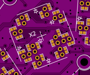

« Reply #150 on: Tue, 26 November 2013, 08:51:35 »
45885-0
everything going well so far. will apply power
after some short circuit testing tonight.

Can you explain a little as to what testing you're doing?
I'm going to go at it with a multimeter and make certain that there are no hidden solder bridges
between pins and under SMD resistors and caps so that I don't fry anything when I apply power.
Everything looks clean, but I want certainty.

My I2C link is working! I have control over the status
LEDs on both the left and right finger PCBs!
Can't express how geeked and satisfied I am right now.
So far I've found only minor errors on the PCB, the
circuit seems to be working, the software has been close,
assembly has gone smooth, my ISR-driven I2C driver is
working, and it is almost a holiday.
I should buy a lotto ticket!
I'll work on mounting up the switches starting the first
week of December.
WooHoo!
some crappy stills of various LEDs all aglow:
45959-0
45961-1
45963-2
« Last Edit: Tue, 26 November 2013, 22:32:23 by OldDataHands »

found my first circuit/PCB error - I
misunderstood the I2C level shifter ASIC
which was then bleeding voltage over into
my 3.3v supply. Some careful trace cutting
and rewiring will solve it, so no major slowdown, but glad to have it understood.

So apparently I don't know how to make a layout for a solder-bridge.
Any guidelines that someone could point me to, or guidance would be
appreciated. Would a simple absence of soldermask be sufficient to
make the bridge easy to establish?  You're going to be in there soldering
the IR components anyhow, it would be easy to drag the iron across
each spot along the way, but it needs to be easy to establish, rather
than the struggle that I've currently got going.
48224-0
In my double-sided footprint for the finger switches I'm relying upon
a set of solder bridges to allow the cathode and anode of each IR LED,
and the collector/emitter of each phototransistor to be connected to
either hole - this allows mounting them from either side of the PCB.
I knew that the layout was going to be small - I made two 0.040x0.040
pads separated by 0.010" naively thinking that it would be hard to
avoid bridging two pads that close together. I am still a bit stunned
that it is a real bugger to get solder to bridge that gap. It turns out
that I also struggle with arithmetic, as I am startled at the number of
these bridges I've made.
Each switch requires that 4 bridges be made (Anode, Cathode,
Emitter, Collector).  There are 40 switches in the finger assembly.
I've 160 of these that need to be made!!!
So, I've ordered a bunch of 0603 bridges from Digikey.  I also invented
a new unit of currency: The millicent; as in: "In bulk, these bridges cost
78 millicents.". I'm going to press forward with the manual placement of
these 0603 components, but I'm not exactly excited about it. If I had
planned on this, I would have a footprint that was a closer match, with
0805 components, and would have had a stencil cut. Now that I have a
bunch of components already populated, manual is the only option.
Oh well. Onward.
In other news, the last of my 3D-printed parts from Shapeways shipped
today, so I should have them by Wednesday. I've got 7 finger-switch
assemblies completely assembled, and have made the metal clips to
complete the last one when the parts arrive.
The last batch of parts I received from Shapeways was a bit different than
the parts I had received from them previously. This batch was on the high
side of their tolerances or maybe a bit beyond, and had a much more solid,
hard surface. The previous batches had a friable surface layer that was not
well attached.
The fact that these parts were a bit larger necessitated more manual re-work.
I had to drill (with a pin-vise and tiny drill bit) open the holes for the IR
component leads. I had to trim off material in several places on all of the
levers for the center switches in order to get the lever to clear the carrier.
I had to trim some of the N/E/S/W keys. It is still an amazing bit of technology...
I just wish it was perfectly consistent!
Saving the best for last: I am able to read switch states! I've got the IR components
for the center switches on the index and middle fingers populated on the I/O
expander side of the board and am able to read switch states through the I2C
link. I'm geeked that it is alive.
It is getting there.  Pics once the parts are all mounted.

Offline OldDataHands
  • Posts: 280
  • Location: Michigan
Re: Re-Create the DataHand - work on finger switches nearly complete
« Reply #185 on: Thu, 19 December 2013, 18:33:18 »
Been thinking about the solderbridge topic:
I will adjust the footprint so that there is no
mask between the pads of the solderbridge
for my next attempt. I would like to have a
design which is as inexpensive as possible
to build a single unit, and an easy solderbridge
is the right answer. That being said, for the
purposes of a group buy two separate layouts
is the clear winner.

About that solder bridge: try making one rectangular pad with a half circle cut out of it, then make the second pad a rectangular pad with a half circle "tacked on". That way, the pads will kind of "flow" into each other. Make the spacing between the two pads 12-20 mil. Someone in my hackerspace designed a PCBs with bridges like that and it is very easy to solder/desolder those bridges.
  • Posts: 280
« Reply #187 on: Thu, 19 December 2013, 18:46:24 »
Interesting idea. What size were the pads?
was there soldermask between them?
The gap in my current design is just 10 mil
and the pads are 40x40 mil.
Offline Darhuuk
« Reply #188 on: Thu, 19 December 2013, 19:08:04 »
I'm not a 100% sure about the size, I would guess around 3mm by 3mm, with a solder mask in between them.

If someone is interested to contribute I need to have some
solder-bridge science done. It would be most convenient for
the existing layout to have a solderbridge which is easy to
bridge with a quick dab of a smallish soldering iron tip,
 and can fit into a 40x90 mil box (not counting keepout
area around it). It needs to be able to be produced by
the usual sorces (OSHPark, PCBWing, seeedstudio, etc.).
Ability to un-bridge seems unimportant to me, as it is only
meant to be set one time, then left permanently.
I could still imagine fitting everything with a 60x130 bridge,
but routing might be more painful, and would have to be
redone.
If someone would step up and create a variety of geometries
and configurations, with/without soldermask to create a test
board, then figure out if any of the options are viable, I'd be
much obliged.
In other news, I've now received the 0603 jumpers I ordered
from Digikey and have them installed. Wasn't as tedious as
I had expected. I think the only trouble came from the
degraded state of my stale, old solder paste. On to mounting
the IR components and switches!

Just a quick pic of the 0-ohm jumpers installed:
48763-0
Offline agodinhost
  • Posts: 766
  • Location: Brazil, RJ
  • Soylent green is people ...
    • Dr Ian O Xaman
« Reply #192 on: Tue, 24 December 2013, 07:38:58 »
it's kinda hard to figure out where the jumper is ...
could you draw a arrow?
There are over 30 of them in that pic.
each of the 0603 SMD components is a
0-Ohm bridge or jumper. If you zoom
in you can even read 000 on them!
Offline regack
  • Posts: 660
  • Location: Thessia
« Reply #194 on: Tue, 24 December 2013, 08:01:08 »
hah, those are cool.  I'll work on a bridge-test thing.  I won't be the fastest though.
