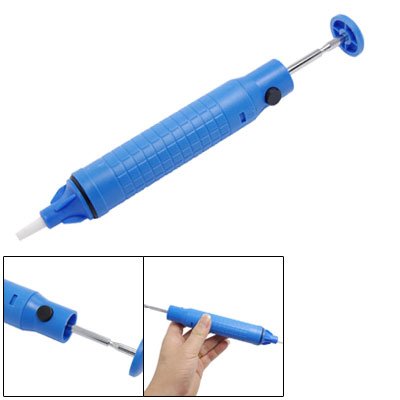

Would something like this be good for soldering switches and whatnot? If so, what size tip(s) should I get?
« Last Edit: Wed, 11 December 2013, 19:38:31 by Mackem »
The Yihua in the OP is on ebay for 5£ more: http://www.ebay.co.uk/itm/Soldering-Station-Best-Quality-YAXUN-936B-whit-UK-3pin-Fused-Plug-/251303485987
JD is a fan of those I think. I don't know what the difference from the B+ to the normal version is though.

Maybe use it for solder, a tip cleaner, a sodapult, etc.? Just some general solder stuff.

I just desoldered the two leds on my filco... It took a good 30 mins to get them to come off, I realized I needed to prop the board up and just pull each side out while I heated the solder because there was no way all the solder was coming out.
What are you using to desolder? I've had success with a cheapo desoldering pump like this:
The LEDs were definitely harder than the switches because the solder points are so small, but it usually didn't take more than 2 tries.

« Reply #1549 on: Wed, 25 December 2013, 11:12:03 »
I am using that exact desolder pump, I always desolder switches first try, but those leds were crazy.
