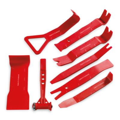

I have a sort of related question to soldering..
Does anyone know what the plastic looking tools are called that pry stuff apart (keyboards so I can solder them?) without breaking the clips?
I've had to use a plastic puddy knife to take a laptop apart, looking for something more professional for the next time.
Do you mean:

take random credit/debit/phone/gift cards.
that would be the cheapest tool you need to open cases.

Maybe.. that wedge in the middle on the right looks like it could work. But I've seen the tools in disassembly videos, they look like some sort of composite plastic rounded wedge tools. No idea what they are called.
Might try that next time.

The middle right one is the one I use for everything keyboard.  The wedge tip does great for popping cases apart and the kinda forked end pops keycaps off faster and safer than anything else.

Alright friends, after some research the tool is called a Spudger.

spudgers are plastic or nylon tools used to pry things apart, push things around without scratching the surface below them, push things together, apply tape without those damned bubbles, anything you can use a plastic, nylon, silicone, etc. tool for. it's a pretty catch-all term. the point is that it's not metal, the goal is not to scratch anything, and ideally it shouldn't melt or conduct electricity.
