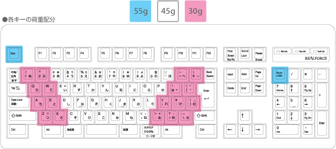

Now I am confused, is the one on Wikipedia the correct one or the Filco one.
@IvanIvanovich, you mentioned JIS, so I'm guessing you might know.
i  think same :-X just on filco no win_r key :)

« Reply #87 on: Thu, 30 January 2014, 18:18:41 »
http://deskthority.net/wiki/JIS
"The specific size and quantity of the Japanese input keys varies between keyboards"
Realforce
« Last Edit: Thu, 30 January 2014, 18:27:29 by pasph »
