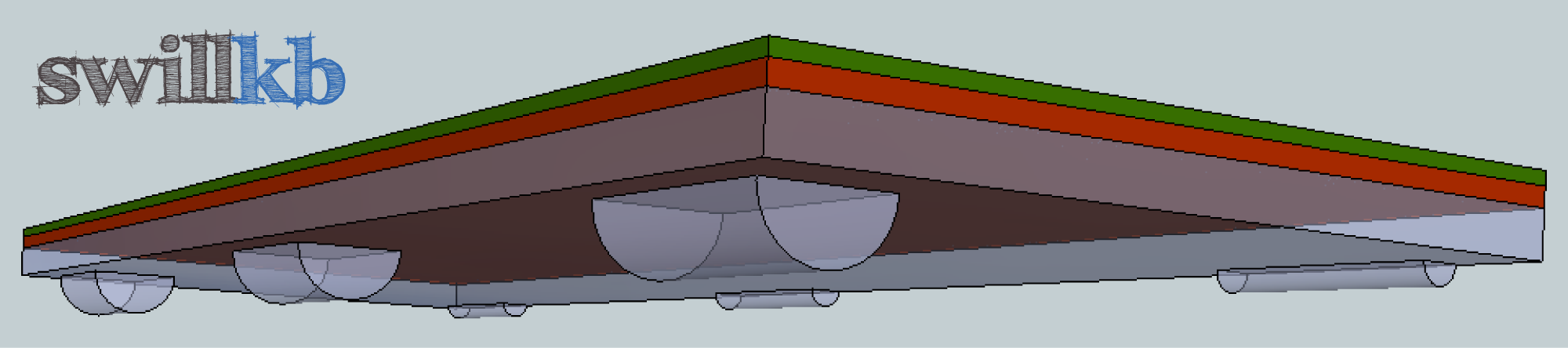

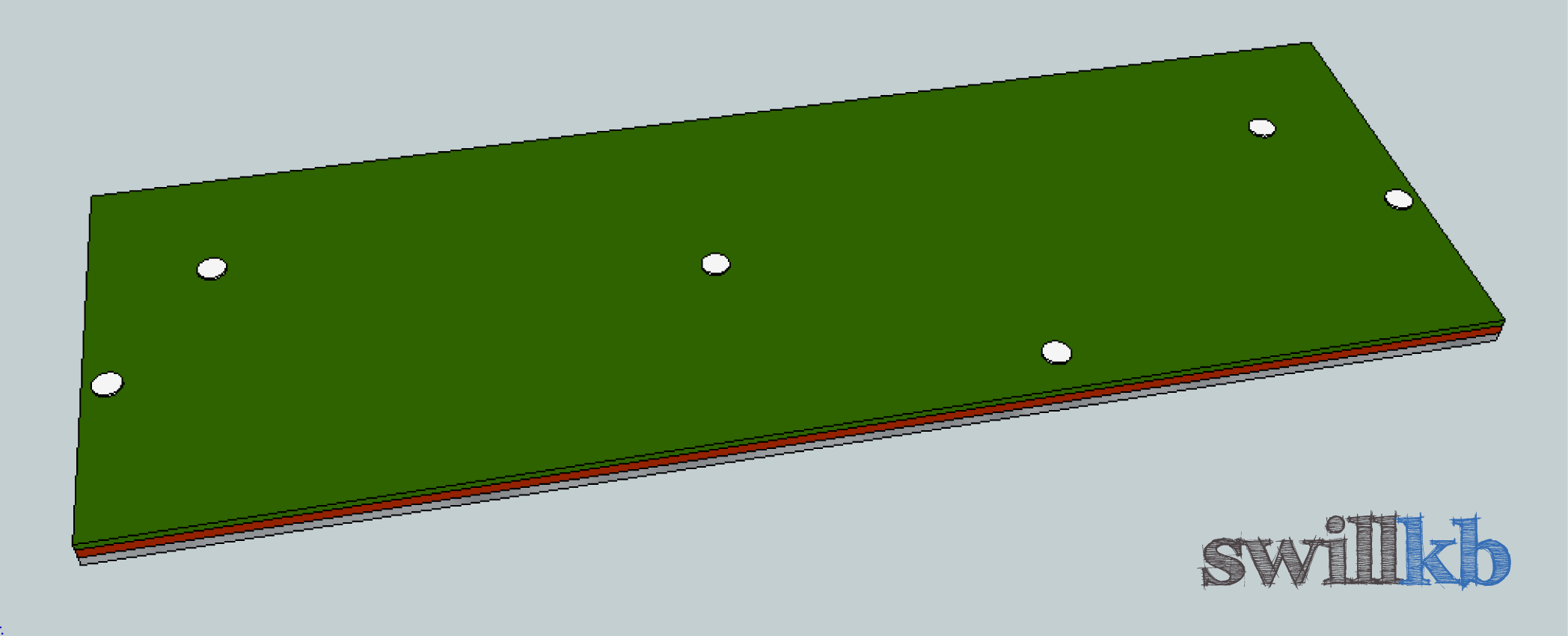

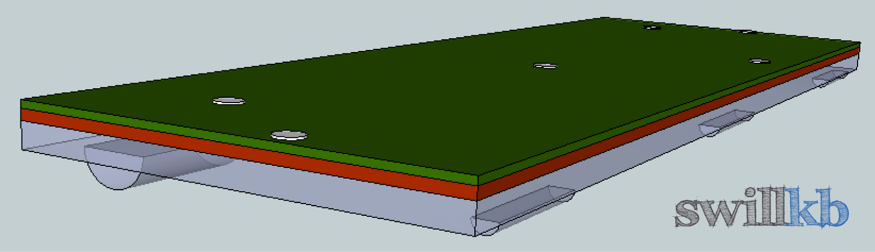

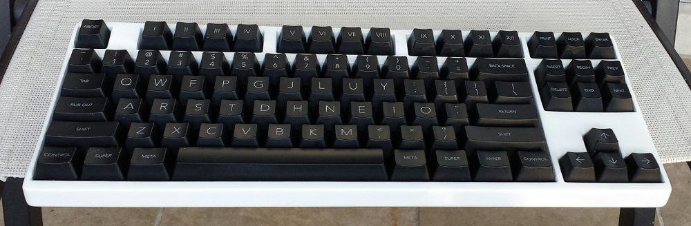

Back to business.  This is the most minimal case I have come up with so far.  It is simply a single sheet of acrylic with holes tapped for mounting the PCB.  I can get away with this because all the components are about the same height and acrylic is not conductive.  I may put a silicon sheet in between the PCB and the back plate, but I will put about 100 hours on this board like this before I decide what I want to do.  I added rubber bumpons on the back to add a little tilt and a strip of no slip tape along the front edge (not pictured).  It is pretty solid and a comfortable typing feel, so I may stick with it like this for a while...
73309-0 73311-1 73313-2

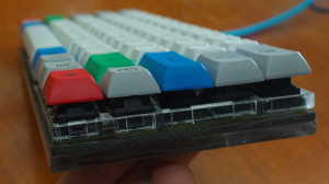

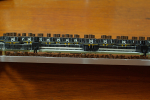

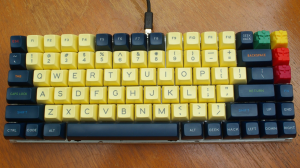

Something for fun.  Here is what I did to my 40% board.  It is basically an all silicon case.  The PCB sits on the inside silicon layer and the PCB is hugged by the top layers.  This is a SUPER stable case because it is a full sheet of silicon making contact with the desk surface.  I was actually planning to put the backplate on, but I got this far and fell in love.  :)
73303-3 73305-4 73307-5

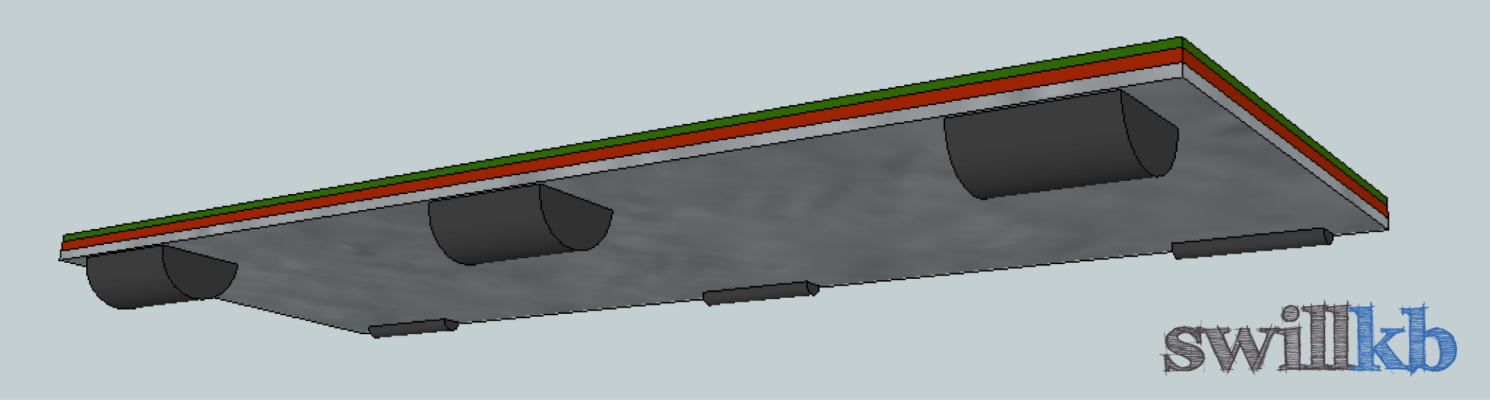

Basic description of my case (images attached):
- 1/8" Aluminium bottom plate || 1/16" Stainless Steel || Wooden wedge
- 1/8"-3/16" Silicon pad; Thickness TBD based on max component height; Cutouts for taller components
- PCB + optional plate
- Rubber stick on adhesive feet to control the prefered keyboard angle.
- Bolts to hold the three layers together.
Motivations for my design:
- I want the solid feel of plate mounted switches, but without having to use a plate (can if you want to).  By having the PCB bolted to the back plate via the silicon pad, I should be able to get a very solid feeling PCB mount.
- I wanted to get some of the benefits of PCB mounted switches.  Easy access to open switches.  I also want the dynamic feel of a PCB mounted switch.

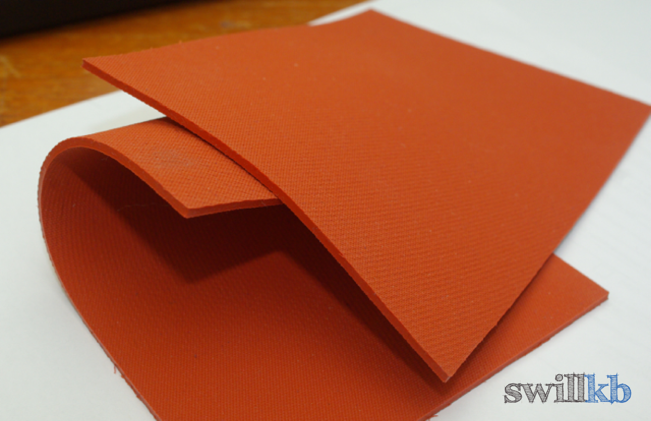

- By using the silicon, I hope to achieve lots of the benefits of the Trampoline Mod.  Basically, it will be quieter than most cases and should have a little bit of a bounce/spring/feedback on bottom out.
- I want a super simple and rugged design that can be easily adapted to different PCB layouts.
- I want a very low cost case that is very accessible for prototyping.  The total for this case should be in the ballpark of around $30.
- I want a relatively low profile, but with the ability to increase it by adding larger feet.  Gotta have a low profile for my new SA caps that are coming.  :)
I am targeting smaller boards with this case.  It could potentially work on a TKL, but I will be focusing on designing for boards in the size range of 40%, 60% and 75%.

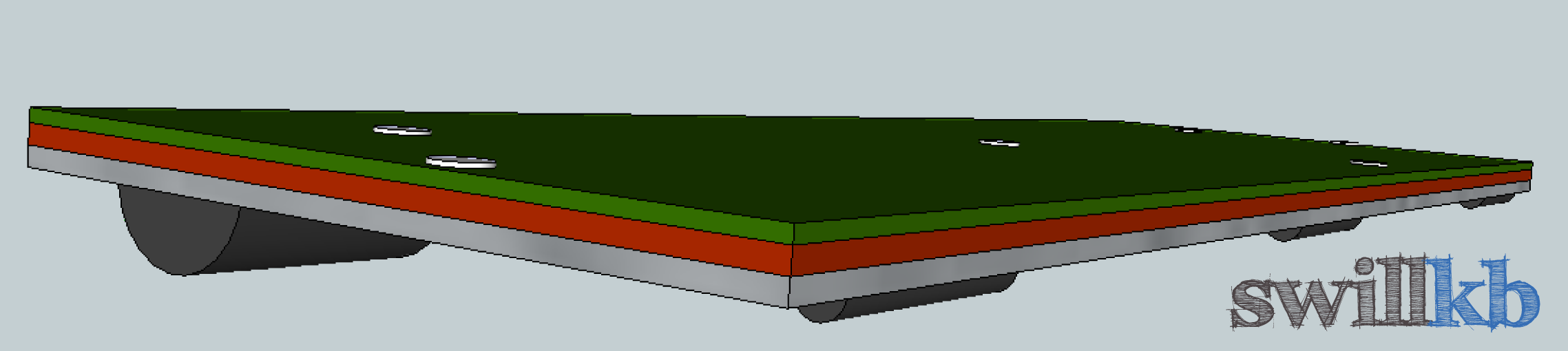

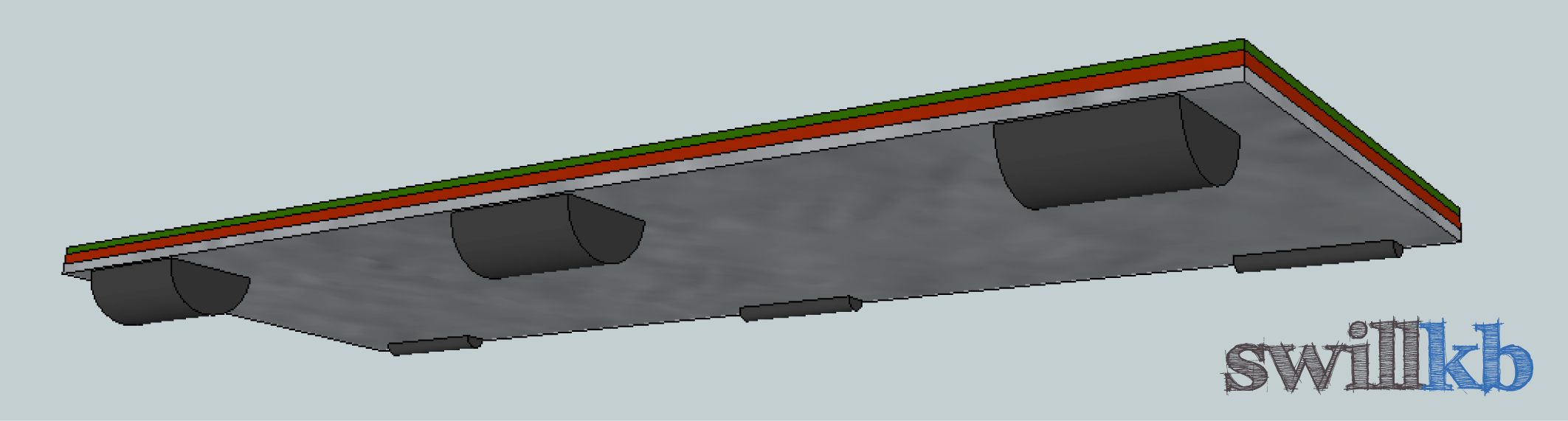

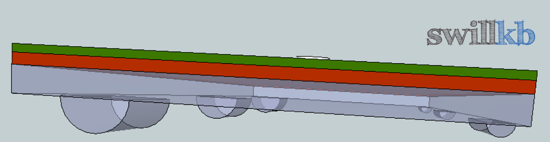

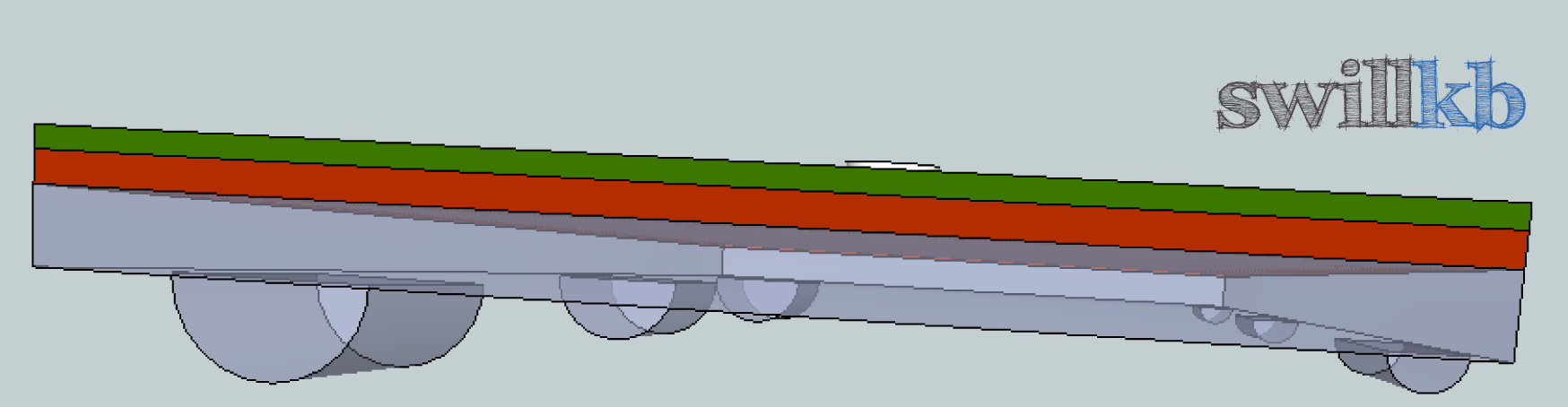

Here are some very basic renderings (I am a noob with CAD so forgive me).  They are still very rough and none of the dimension are final, but I used the GH60 layout for the initial design.

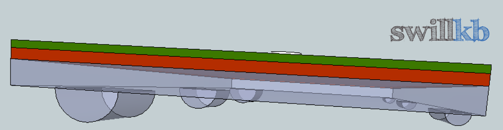

Metal back plate and rubber feet:
(the holes in the metal plate will be threaded so the pcb will be bolted directly to the back plate.)
49488-13
49490-14
49492-15
49494-16

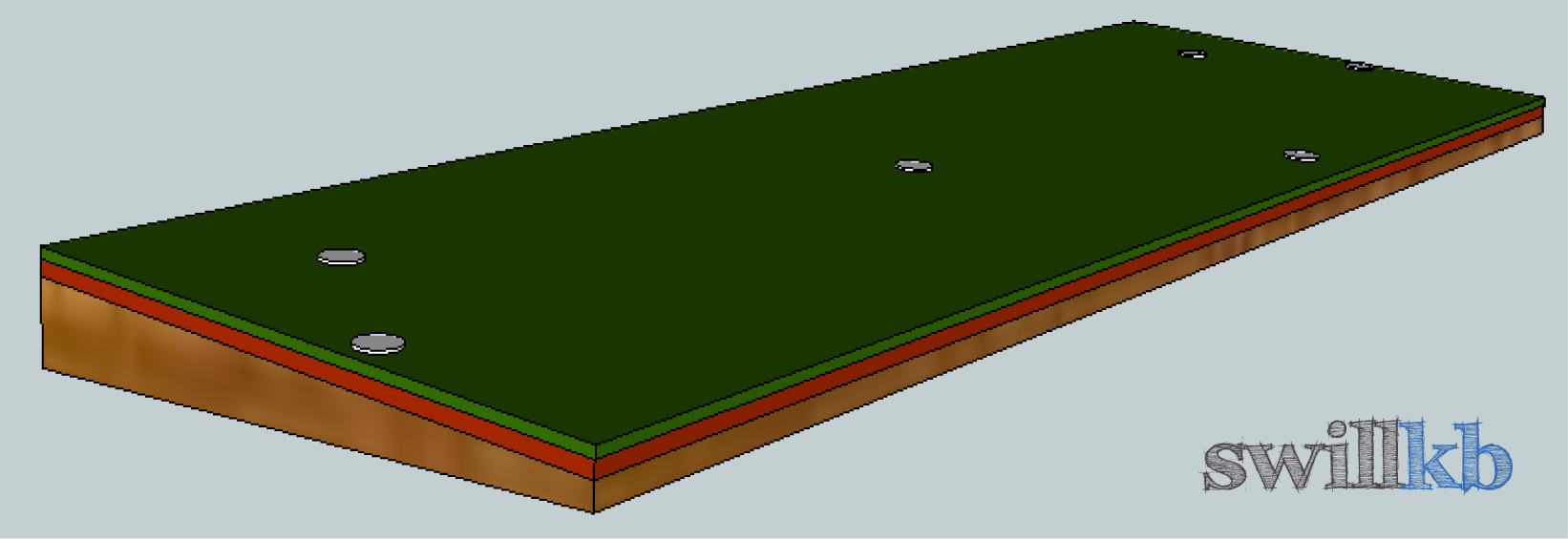

Wood wedge base:
(this would have threaded inserts mounted into the wood, like this)
49498-17
49500-18
49502-19

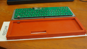

And a shot of the silicon pad.  This is what I currently have, but I have a supplier for this already because we use this at www.kiteaid.com to distribute iron pressure.
49496-23

Added some wood wedge renderings as a potential base material...
Offline akikun
  • Posts: 21
Re: swill's minimal case design
« Reply #32 on: Fri, 20 December 2013, 19:21:28 »
I really like this idea, and I think the wood base would be gorgeous. What do you guys think would be the best way to cut that slant, though? Bandsaw with a tilting table, maybe?
Offline swill
  • Posts: 3365
  • Location: Canada eh
  • builder & enabler
    • swillkb.com
« Reply #33 on: Fri, 20 December 2013, 19:52:36 »
A band saw with a jig is probably the best option.

added plexiglass renderings and launched swillkb.com...
« Reply #35 on: Tue, 31 December 2013, 16:15:43 »
Nice.  I like this idea, trying to figure out how to adapt to to board where I have stuff stuck to the bottom.  Maybe some cutouts in the bottom plate in strategic places.
Offline swill
  • Posts: 3365
  • builder & enabler
    • swillkb.com
« Reply #36 on: Tue, 31 December 2013, 16:19:00 »
This is why I asked you about the profile of the bottom of the board in the GH60 thread.  :)
The great thing is that there is a silicon sheet between the bottom plate and the PCB, so yes, I will be doing cutouts in the silicon sheet for the components that are taller than average.  For example, the USB connector and the reset switch, etc...  For something like the reset switch, I may even do a cutout in the bottom plate as well so it can be accessed without removing the case at all...
Offline regack
  • Posts: 660
  • Location: Thessia
« Reply #37 on: Tue, 31 December 2013, 19:30:01 »
Yes, Komar answered in there with some measurements, but I have some one-offs with daughterboards sticking ~7mm off the bottom, but I'd guess they're unique to me, and not really a problem for anyone else.  I just have this (probably unwise) fascination with the idea.
Offline swill
  • Posts: 3365
  • builder & enabler
    • swillkb.com
« Reply #38 on: Tue, 31 December 2013, 19:36:54 »
 We can definitely do cutouts in the bottom plate, with the non-wedge design, to accommodate for the daughter board.  Probably easiest to prototype with 1/4" acrylic, but if the cutout is large we may want to go with aluminum or steel to make sure we don't lose too much structure...
Offline regack
  • Posts: 660
  • Location: Thessia
« Reply #39 on: Tue, 31 December 2013, 19:48:20 »
They're pretty small: 46mm x 17mm and 38mm x19mm... even with the wedge made of wood, I could just chisel out some space I suppose.  Anyway, I like your ideas!
Offline swill
  • Posts: 3365
  • builder & enabler
    • swillkb.com
« Reply #40 on: Tue, 31 December 2013, 20:08:43 »
I have a couple wood wedge ones being made for me by The Beast and nubbinator.  I am about to start prototyping with 1/4 plexiglass soon.  The metal ones are going to be a bit more expensive, so I will wait till I have PCBs in hand and have tested with plexiglass first before I do any metal ones.
I am basically waiting on getting my first PCB before I start doing real prototyping.  I expect to get Sprit's in probably about a month, so that will probably be the first.
I am stockpiling quite a bit of material for these cases while I wait for the PCBs.  I am going to try a lot of different mediums, so I will be making a bunch right away.  Once I start prototyping I will probably start selling them at cost or giving them away so other people can try them and give me some feedback...

swill? what does pricing look like on those silicone sheets? those are really nice. what dimensions (thickness in particular) can your provider supply? i have a particularly cool application for them
What reference are you referring to in regards to software piracy?  I don't think I have promoted software piracy, at least I never intended to.
I am going to see if I can get away with 1/8th thickness. The height difference between the average and tallest component will be my limiting factor.
For testing I am just getting from eBay cause my supplier likes quantity.  On eBay it is priced in the ballpark of $20/square foot.  I am also getting it with an adhesive backing and with high temp rating.
mod team cleaned up the piracy reference (except for my reference to their reference)...
you should be fine at 1/8". that is pretty thick compared to the average passive component and far thicker than anything but a very large bga IC. people have been using those mesh PU sheets for shelf lining for quite a while now under pcbs here and those are more like 3/32" thick
what kind of quantities does your supplier need?

The shelf liners are not being used as structure to support the board though. They are just used to reduce noise.  We will see once I start bolting pcbs to it. :)
Last time I had to order 100 sheets from my supplier.  I found a new supplier in the US that does not require a minimum which I can send you the details for.
