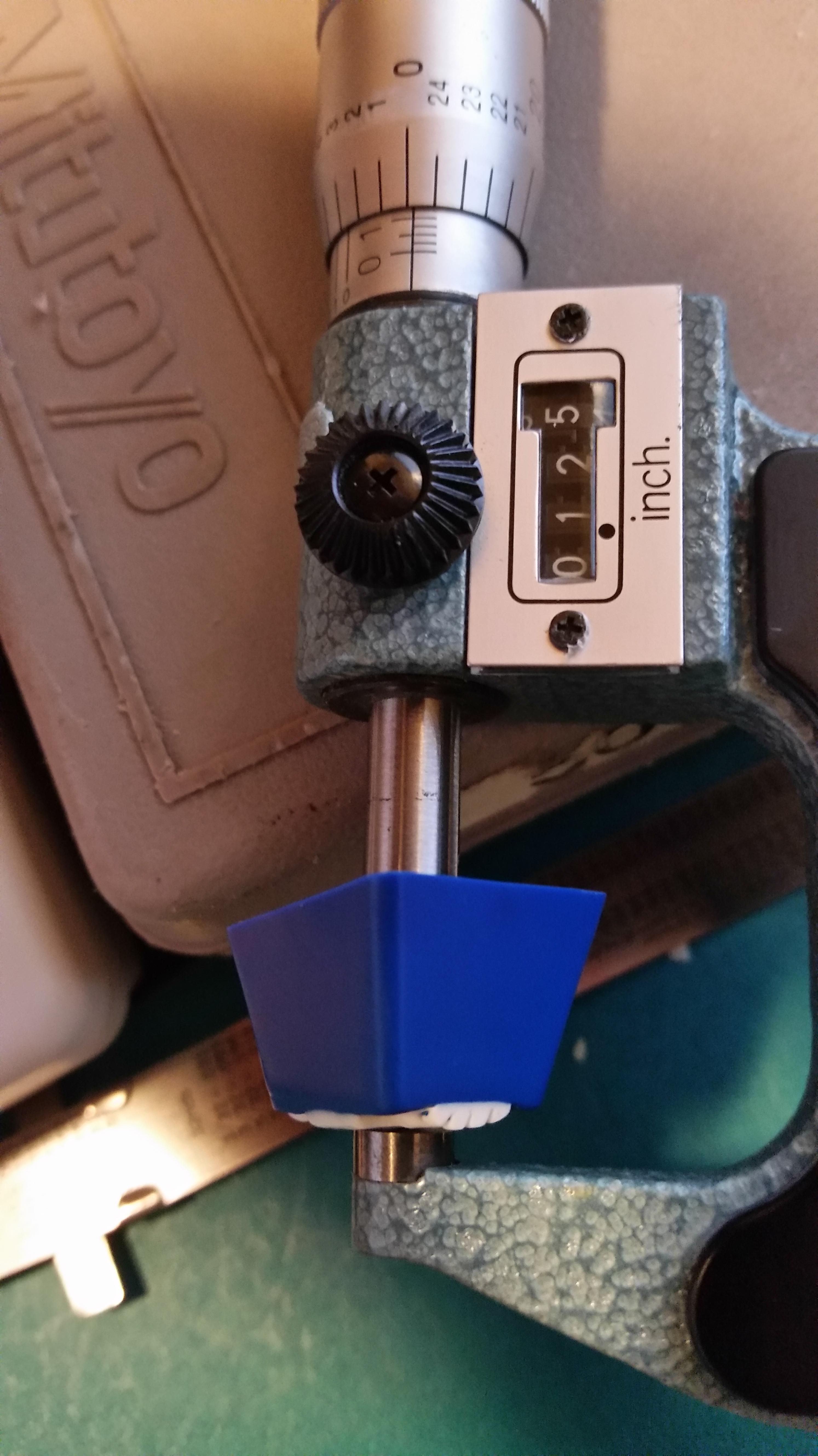

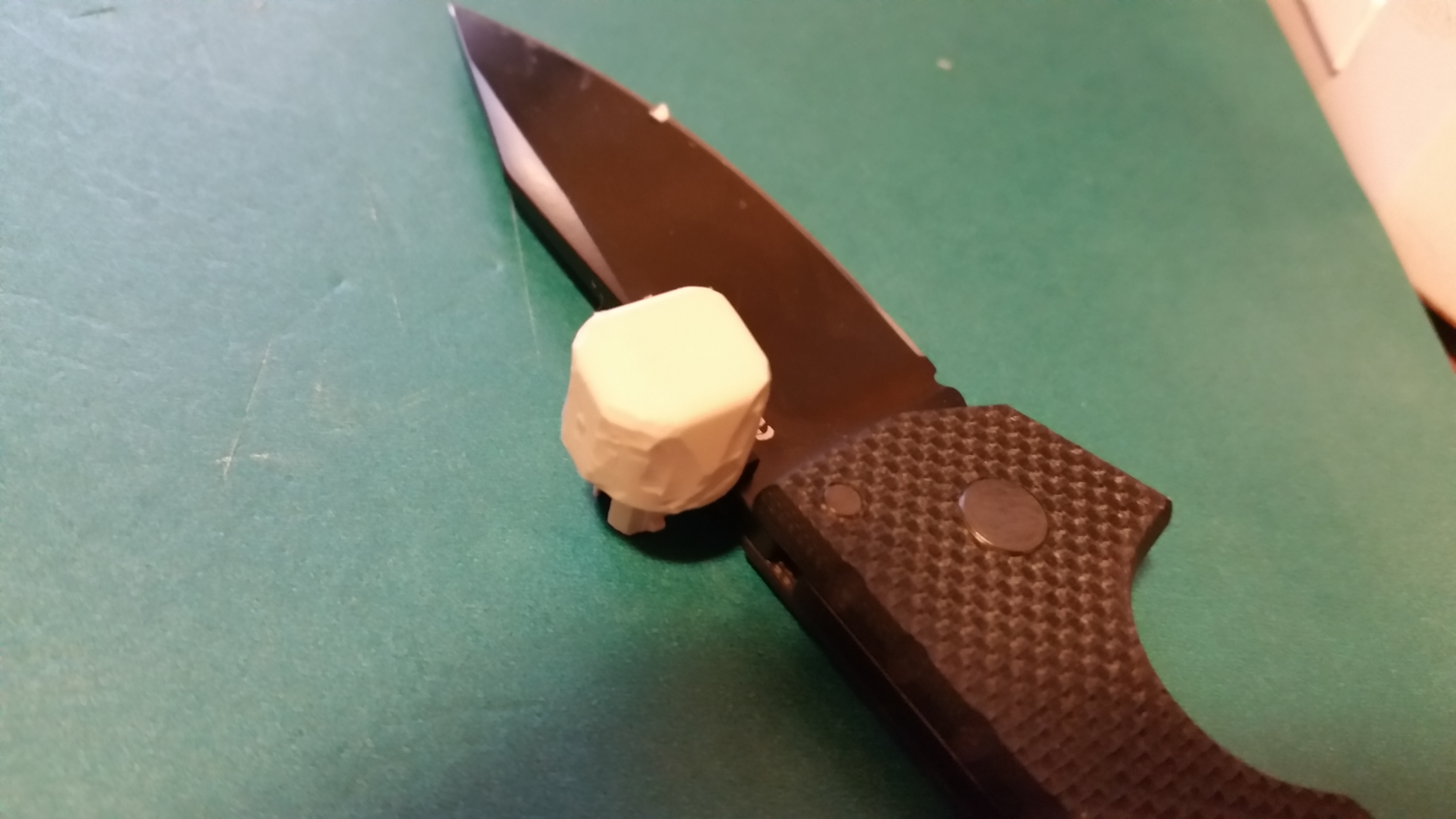

So I had this Topre Jack O Lantern, but it just wasn't flowing with my Topre boards. On my BS board, I have what I consider the original lineup: OG Tricolor, Salute, and Mr. Friday. If only Jack O Lantern existed in BS, I could hope to attain it and complete the original lineup. Well, there was only one thing left to do: make one myself.
First, I tried to modify an inner piece from a two piece cap, but that didn't work out at all:
158931-0
So the next thing to do was to stem mod it:
158933-1
158935-2
Stay tuned! Tomorrow, I'm going to pick up some X-Acto knives, and then the real fun starts!

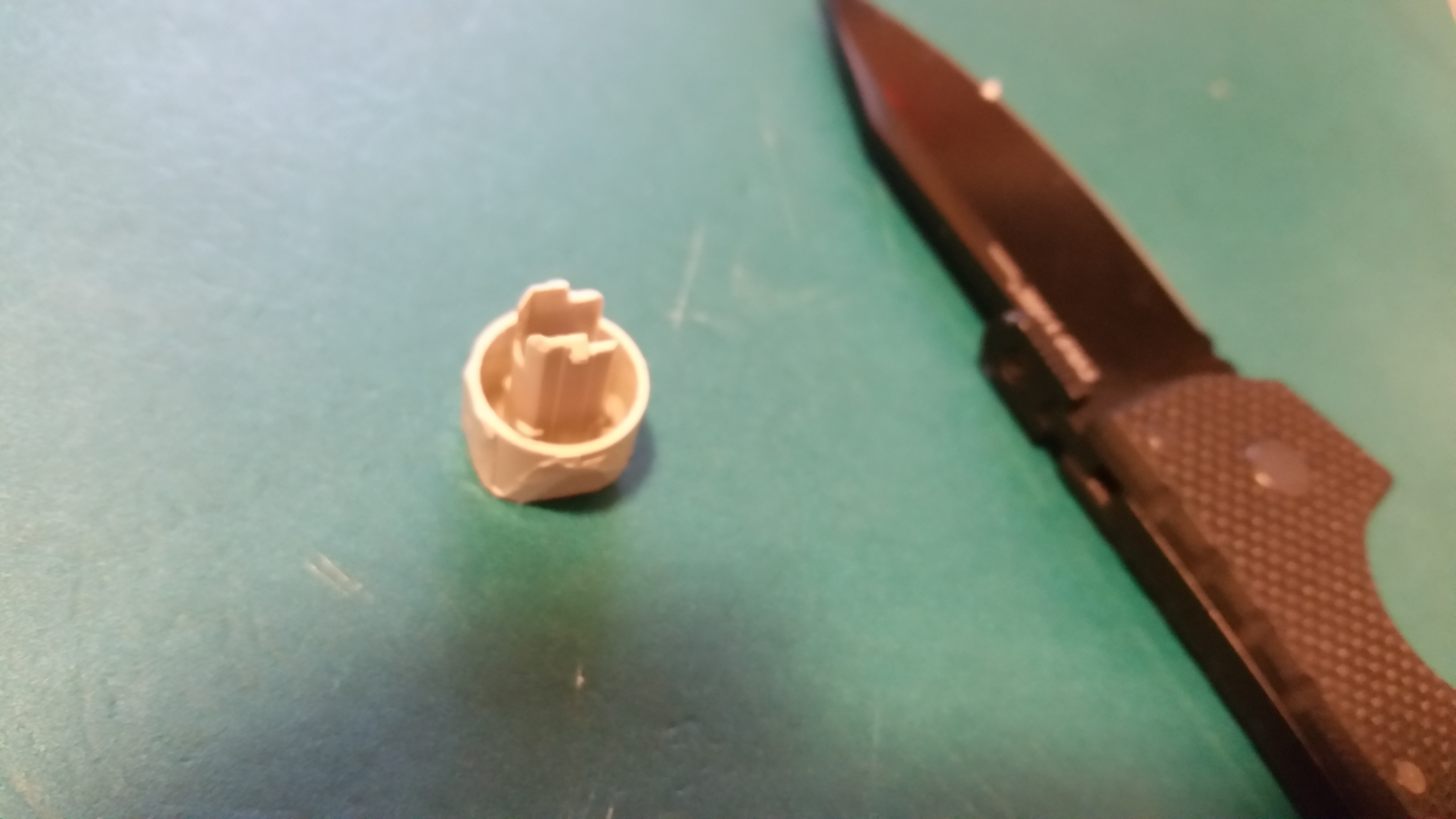

So this is what my BMX Salute looks like inside. This is the goal: hollow out the Jack to this status so I can fit an inner piece inside.
158937-0
« Last Edit: Sun, 29 January 2017, 17:35:16 by ghostjuggernaut »

Okay, so this is what needs to be inserted in the Jack.
158956-0
158958-1
Very rough right now. By my measurement with calipers, this won't fit, so I need to shave it down a lot more. I will work on this more before I start cutting into the CC.
Also, some measurements of the face/wall thicknesses with a micrometer and calipers (as taken from the BMX Salute):
wall - range from .030" to .040" depending on spot; varying wall thickness
inside face, top to bottom - .537"
inside face, side to side - .469"
face, taken on nose - .125"
158960-2
With measuring, it has been noted that the face of a BS CC is wider than a Topre CC, which I did not previously notice. Thus, I will definitely need to shave the BS stem down considerably. More to come later.
« Last Edit: Sun, 29 January 2017, 17:46:25 by ghostjuggernaut »
