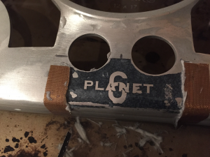

It began early as I tried applying the mask to etch logo onto keyboard shell. Earlier tests with thick aluminum failed, probably because of the mass absorbing too much heat which prevented the toner from melting and transfering to the aluminum. So I preheated the shell in the oven to 350º with clothes iron ready to seal the deal.
Earlier experiences with transferring toner has taught me a few valuable lessons.
1. Thoroughly soak paper before removing or some of the toner may adhere to the paper.
2. The iron has barely enough heat to do the job, even with thinner projects, so don't scrimp on ironing time.
3. Apply generous pressure. After heating, I use the iron's edge to burnish the paper.
4. If you use tape to locate paper, keep it  far enough away from artwork to allow iron to make good contact with transfer.
So what could go wrong?
I'm not sure, but it did.
149006-0
Several attempts, and the results weren't much better than this one. I think that the combination of dealing with the preheated part and the compound curves multiplied the difficulty factor. Resolved to get this thing anodized that day, I choose to just not etch P6 on the shell.

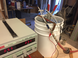

Now to the shop where new 6 gallon buckets, fresh distilled water, and battery acid are waiting alongside my surplus anodizing supplies and equipment.
149008-1
After re-sandblasting the area I prepped for the logo earlier, I carefully cleaned, degreased, and de-smutted the parts in appropriate solutions and at the correct temperatures. I prepped the anodizing tank, hooked up the power supply and set the constant current to 5.5 amps. Being careful not to touch the parts, I dipped the parts into the tank, dividing the pieces into  4 different groups to avoid overcrowding the tank.
I was confused when after 2 hours, the voltage only rose to about 10 from approximately 5. I thought that in the past it rose a quite a bit higher to maintain the current flow as the anodizing process increased resistance. It just seemed to stop at around 10. I removed the pieces after 2.5+ hours because I've read that after a certain time the anodizing process stops but the sulfuric acid continues to corrode. According to the 720 formula, given the surface area and amperage, it should have been complete after 130 minutes.
When I finally dipped the work in the dye, I was disappointed to find that it didn't take. None of the 4 batches took the dye. But why?
So, after about 18 hours of time on it yesterday, all I have is a pile of pieces which aren't black and may or may not be anodized and a bunch of questions about what went wrong. The possible culprits may be old supplies; most of the chemicals and the dye are from when I did the AlumaPlop. Could they have gone bad? I was careful not to contaminate any of the solutions and sealed the containers. I wondered if I didn't have a good electrical connection to the pieces or that my acid solution wasn't properly conducting electricity, but the cathode was bubbling aggressively enough to suggest otherwise– this was also supported by the readings on the rectifier.  I also waited about 1 to 2 hours between de-smutting and anodizing, but I don't think that could cause the issue either. One final possibility is that the aluminum alloy I used doesn't anodize well but it was 6061 which is pretty reliable. The aluminum wire bonding the pieces wouldn't take dye either.
I welcome any thoughts on the matter. I don't want to waste a lot more time stripping and re-doing it again to end up with the same results.
On the positive side, while I'm scratching my head on the anodizing problem I may try the etching process again.

I wonder if that dye looks it's efficacy after a certain amount of time. Or the chemicals in general.
And for some reason that voltage issue is really sticking out to me. But I don't know enough to comment on that part of the process....or much on anodizing in general.
Thanks for the thoughts. I've wondered about the dye. I ran a felt pen over the aluminum after the failed dyeing attempt to see if it would absorb the ink. It didn't but the surface was still wet so that may have affected it. I'll check again today. I was exhausted and frustrated last night.
I wish I knew how to test the quality of the chemicals. Both the degreaser and the de-smut appeared to work, based upon the water sheeting test after the degreaser and the color change after the de-smut.
Based on my observations, I've ruled out failure from the power supply because it seemed to respond properly. I know it was properly polarized, both by tracing the leads from the anode to the positive and the cathode to the negative and also the more plentiful hydrogen bubbling coming from the lead cathode. I varied the constant current from 4.5 to 6.5 amps treating approximately 1sq. ft. of area at a time for between 1.5 to almost 3 hours. The voltage began at about 4 volts and raised to roughly 10 when I removed the pieces. If the acid bath was bad I don't think I would have gotten as good continuity. I very briefly contaminated the acid when a steel clamp accidentally touched the surface for 1-2 seconds but other than that I took precautions to keep the bath pure. A weak link may be the attachments, aluminum wire tightly wound around the parts, but it's hard to believe at least some would not have worked. With the caps there were 62 pieces.
I could try the same thing again, buy new chemicals and try again, give up and Ceracote it, or really give up and use some old house paint I have laying around. I think it's green.

I don't know anything about anodizing, but I found a PDF for troubleshooting that might be useful: http://www.nmfrc.org/pdf/sf2005/sf051502.pdf. And here is a very short thread that touches on the problem of the dye not sticking: http://www.finishing.com/3600-3799/3679.shtml.

Working backwards from what you've said
The dye wouldn't take.
This implies either you have no / very thin anodize, the dye is bad, or the anodize came out of the bath already sealed (not sure if this can happen but if you got the process wrong somehow...)
As you say a pen wouldn't take on the surface either, we can probably discount the "bad dye" option.  Still, test the dye on something that definitely will take dye, to be sure, maybe?
That leaves the question "are the pieces anodized at all?".  Run a multimeter over it, the anodised layer should be non-conductive, and thick enough that your probe tips pushed against the surface can't penetrate through to the raw alu below.
If it's (properly) anodised, it could be that your process fouled up and the parts came out already sealed, which means you're into "strip and dip" time.  Or cerakote, you quitter you.  My money's on "it's not anodised".  If that's the case, "why not?".
You were getting at least some current through, the bubbling shows that.  Maybe a check with the same solution would be worthwhile, a piece of planet 6 scrap, and a multimeter inline, in 10A ammeter mode (*quick* test, no more than 5/10 seconds at a time).
Otherwise, chemicals.  You say you used the same chemicals as for the alumaplop, I'll discount them "going bad", or even getting contaminated, but are you sure you haven't just diluted an already diluted acid?
Here's to hoping. :thumb:
Thanks for sharing the resources, it's good to see that you're still around. I hadn't seen either article and they were good checklists. The one article applied to architectural finishes which use a different method for coloring because of the need for protection from the sun but still offered good reminders. A few things stood out as possibilities and in the end I think it had to be either the old materials or waiting too long between steps. I think that I'm going to go ahead and Ceracote the shell and other body parts. If I'm happy with the finish, I'll do the same to the caps. My biggest concern is the potential wear on the caps. I'm amazed how well the black anodize is holding up on the AlumaPlop, although the shell doesn't get the abuse the caps would get.
I may not have got the acid concentration perfect but I suspect it was pretty close. You've got me fired up to try more tests (after your callous comments) but I don't want to do them on the actual pieces themselves. I'm concerned that the tapped holes may become compromised if I do much more.
I appreciate your logical troubleshooting sequence, I just wish you would offered them sooner.    Sleeping on the job?

One other thing. If the concentration wasn't conducive to anodizing, I don't think I would have gotten so much bubbling. I inhaled enough hydrogen fumes to make me as high a a Graf Zeppelin.

I think you probably ought to see if it's anodised anyway.  Not sure how cerakote will stick to raw aluminium, and if it's still raw it will still be soft...

I will. I'm guessing that it's slightly anodized based on the fact that it did absorb some color and that the resistance did double. If my memory serves me well, I think the voltage got to about 17 on the AlumaPlop compared to 10, given the same current. I don't mind getting new chemicals and re dipping, I just don't want to re-wire 68 caps again. That was very tedious.
The Ceracote is supposed to adhere well to raw aluminum as long as it's prepped properly.

I re-anodized the keyring and it did take the dye this time , but it was not perfectly consistent. I did learn a few things along the way. I used sodium hydroxide to strip the anodize and whether or not it fully stripped it, it sure did clean it up. I re-sandblasted it, degreased and de-smutted it. Before dipping it I added a little more acid for good measure fired up the DC and was getting better results. I dipped it in the dye and it partially took– kind of a very dark grey. I decided it wasn't worth it and decided to go with the Ceracote which came today. I think that  didn't fully strip the anodize and that led to the sub-par results.
Gave a final try at the logo etch. It was going well but at about half depth the mask started to dissolve.
149317-0
I sanded it out and discovered that the anodize did take after all. The skin was very hard and it took a lot of effort to cut through it. I may try to re-anodize the caps but I think the rest will be good without it.

Yeah, go ceracote.  I wouldn't even bother with trying the anodize again on the keys, just ceracote the lot.
After doing a test piece, obviously.

I did anodize the Alumaplop and it turned out incredible. That is why the decision to not continue pursuing anodization was such a hard one to make. I will probably never know for sure what went wrong and will try again on other projects but I just don't have it in me to start from scratch again, especially when I'd have to strip everything before I could even start from scratch.
I rely heavily on the comments of my friends here to help me sort through the many decisions that inherently come with a project like this. In the end, it is me that makes the decision and lives with the consequences, but in so many ways you have influenced that decision. Because of that, at the risk of sounding codependent, thanks for giving me "permission" to Cerakote rather than anodize. Without your approval I would forever wonder if I was compromising the project even though the coating may be, in some ways, superior.
Getting rigging set up for spraying. I still have to re-prep the caps– degrease, sandblast, heat to 400º to draw out latent moisture and oils, degrease, then spray.
149378-0
Everything is getting black, but the ring caps look kinda nice natural. Although, maybe just a little too much.
149380-1
You can see the inconsistent texture and color from the anodize on the ring.
