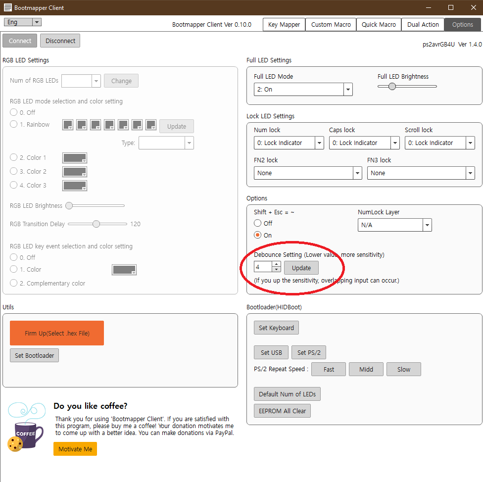

« Reply #171 on: Sat, 08 December 2018, 17:04:12 »
I have one and have never noticed any lag. Though I top out at like 70/80 WPM.
Could you experiment with the debounce, as others have reported, and see if that produces lag?
I don't know what debounce is, I don't know that I want to introduce something that would create lag though
It's a configurable delay built into most firmware to deal with potential ghost keypresses if the keyboard matrix is scanned to often/rapidly.
The theory is that the lag is caused by the debounce delay being set too high and that lowering it will resolve the issue.
208594-0
Set it to 1.
If you run into issues with keys being registered multiple times keep bumping it up by 1 until it stops.
