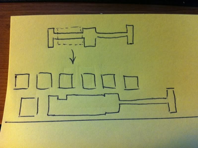

what does the costar stab's look like? I've only got a working template for the cherry PCB mounted stabs (I'm actually typing on it right now) if you can find me a schematic or something from costar's manufacturer I may be able to get something made.... though I would have no way to test it.

Quote from: ishtob;453771
As far as what they look like the only examples I have (at the moment) are from the wiki which have nice resolution pictures. Each one should line up perfectly under the stems as long as the keys are compatible with Filco's/WASD. I am trying to find the schematic data and I will update this post if I find it, but for tonight (it is late) I am heading to bed.
http://geekhack.org/showwiki.php?title=Island:12649#vw-head-4

« Reply #207 on: Thu, 17 November 2011, 01:25:56 »
ok, so it looks like something we need to do on the plate, not the PCB

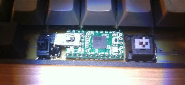

oh, and those who wants to use this PCB, know that you will need to but and solder a miniusb to fit right next to the space bar switch stabilizer so taht the teensy's usb port will be connect to the one in the back, you will also need this for mounting the USB to the back of the board
[ Attachment Invalid Or Does Not Exist ] 32274[/ATTACH]

« Reply #210 on: Thu, 17 November 2011, 01:51:36 »
Quote from: ishtob;453809
(Attachment Link) 32274[/ATTACH]
The Teensy is soldered to the underside of the PCB right? This picture is just confusing me a bit I guess I just do not see how you would gain access to the Teensy button under neath a metal plate if it is mounted to the top side of the PCB, and couldn't that cause problems to the key travel for the spacebar or risk a short under the metal plate?

« Reply #211 on: Thu, 17 November 2011, 01:54:00 »
Quote from: bloodygood;453825
I am currently without a plate, everything is just PCB mounted... haven't had time to learn to work CAD to get a plate drawn up, but if I were to draw a plate, this section would not have a plate over, and hte button can be accessed by removing the space bar keycap

Quote from: ishtob;453827
Could you wire the switch off-board so you can access the switch without removing the spacebar?

« Reply #213 on: Thu, 17 November 2011, 01:59:16 »
I think it would be possible to move the Teensy to the underside and still have a USB mount port to the top of the PCB. Give me some time and I will go over the layout in my head tomorrow and see what I can come up with. Working with multiple layers really does take a lot of getting used to visually. Since I wasn't originally planning on working with the LED leads though I am not sure I am qualified to adjust for that.
Quote from: litster;453831
I could see that being possible, but it would take modifying the Teensy and that is such tiny hardware that I wouldn't personally want to make that adjustment.

« Reply #214 on: Thu, 17 November 2011, 02:00:17 »
so the plate would look kind of like this:
Offline bloodygood
  • Posts: 310

« Reply #215 on: Thu, 17 November 2011, 02:04:58 »
Quote from: ishtob;453833
*snip*
Although that is assuming the Costar stabilizer would still be balanced and hold properly given the gap right next to it. Like I said, I will think it over tonight and work on moving the Teensy to the underside of the PCB in the morning. I think it is a much better idea to just open up the case and press the button on the underside, then trying to deal with desoldering or having a metal plate with gaps. Also ensures that both types of stabilizers would be unaffected by the Teensy's shape

« Reply #222 on: Thu, 17 November 2011, 02:22:59 »
Quote from: TheProfosist;453844
couldnt you desolder the usb port on the teensy and wire directly to it would that be easier?
is removing the spacebar that big of deal to get at the switch?
For the sake of everyone who plans on making this mod, doing as little modifying to components really would be favorable because it would make it more accessible to the public and those who are just getting started.
1. solder teensy
2. solder mx switches
3. solder usb hub
I know that isn't necessarily the actual order of course, but that isn't my point. Promoting simplicity boosts confidence. Makes the project truly user friendly and intrigues more members to try it.
No removing the spacebar is not that big of a deal, but it also looks cleaner when switching out keycaps later, or not worrying about bottoming out and hitting the micro controller. And the idea of not placing something there you won't be using all the time.

Offline ishtob
  • Posts: 514
  • Location: Boston,MA
Dox KB, Build your own!
« Reply #223 on: Thu, 17 November 2011, 02:29:05 »
what are the specs of the 2 different resistors that we would need also have you been able to track down and white leds that fall into the specification that we need to work with the DOX?
No, all the white I've came by are using 2.9-3.4V, if you can find anything =<2.5V it would work, but we'll need to calculate new vales for those resisters (prob 1ohm)
as for the current layout, baed on the 2.2V LED's im using, it should be 100ohm for the seried LED and 470 for the lone LED, this would provide 6mA of power to every LED, which you've seen in my pics
Yes, that would work, but is it easier?
First of all: I hate desoldering :P
secondly, those pads are tiny, and with the soldering I have I don't think I would be able to accurately solder wires to thsoe pads even after I remove the
you only really use it until you find the layout that you like which for me has already been determined and tested
I believe you just answered your own question

I tested and retested before ordering the board as I have a metal space bar (which mean contact of any short = bad) I've already assembled the board, using it for the past week and half and i yet to have any issues with shorting out.
I planned it to sit at the same height as the plate (if there will be any) and the USB section would be under the switch.
There is going to be an issue for those who are going to be using the filco/leo hybrid space bar, as the USB will be directly under the leo-MX switch thingy.

steps for my build: (in order)
1. solder diodes (and resisters if your using LED)
2. Solder wires to a cut mini usb's back end
3. solder other end of those wire to PCB
4. plug in and solder teensy
5. solder USB
6. solder MX switches
optional: add LED
that's basically it, takes about 2 hours to solder (most of it spent on the diodes and resisters)

what if I were to get cherry stabilizers which would take a leopold spacebar would that work?
Offline ishtob
  • Posts: 514
« Reply #227 on: Thu, 17 November 2011, 02:51:04 »
no, the filco sized stabilizers gives just enough room for a cut-usb and teensy to fit with the teensy board to just touch the space bar switch (in the groove where the plate should be if i had one)
leo stabs would not leave enough room for the usb, it would still be possible for you to do the desolder usb head trick, but I would also need to move the hole where the wires from the usb goes.... since it will be directly under the stab.
