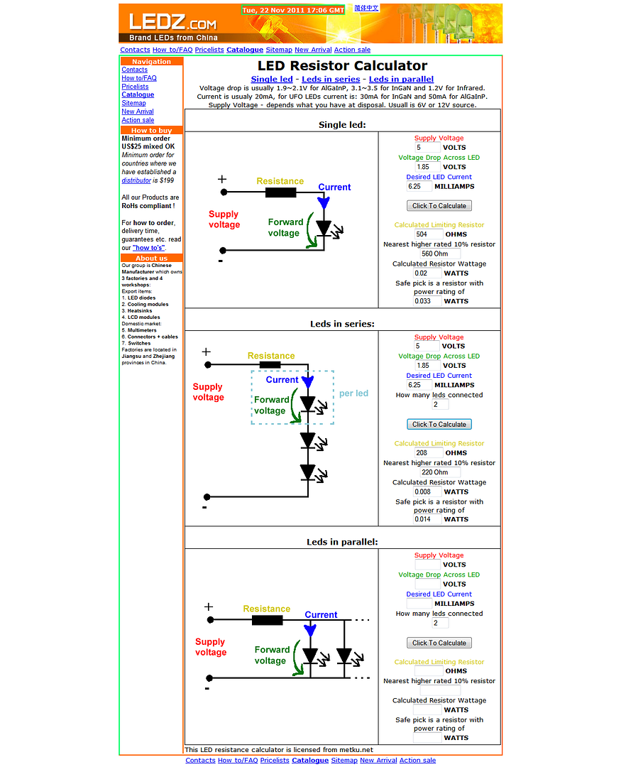

theres a typo for the 1st slot, your using 1.85, not 1.58
also if your running it at that current, your USB won't be able to support it... that would add up to about 650mA roughly without calculating it

Quote from: ishtob;457452
Alright so the mA is going to have change then right? The teensy takes up 100mA right? So, 400/64=6.25mA. So that changes the resistor alot 504 and 560 recommended for the single led and 208 and 220 recommended to the 2 LEDs in series. Calculator Screenshot

i actually dont know how much current the teensy draws :P so iono, i try to keep the total current under 350 because i saw an article somewhere saying most keybaord uses 100-200mA i took the average 150mA use

Quote from: ishtob;457476
Ive have read everything on their website I cannot figure out power draw for the teensy.
