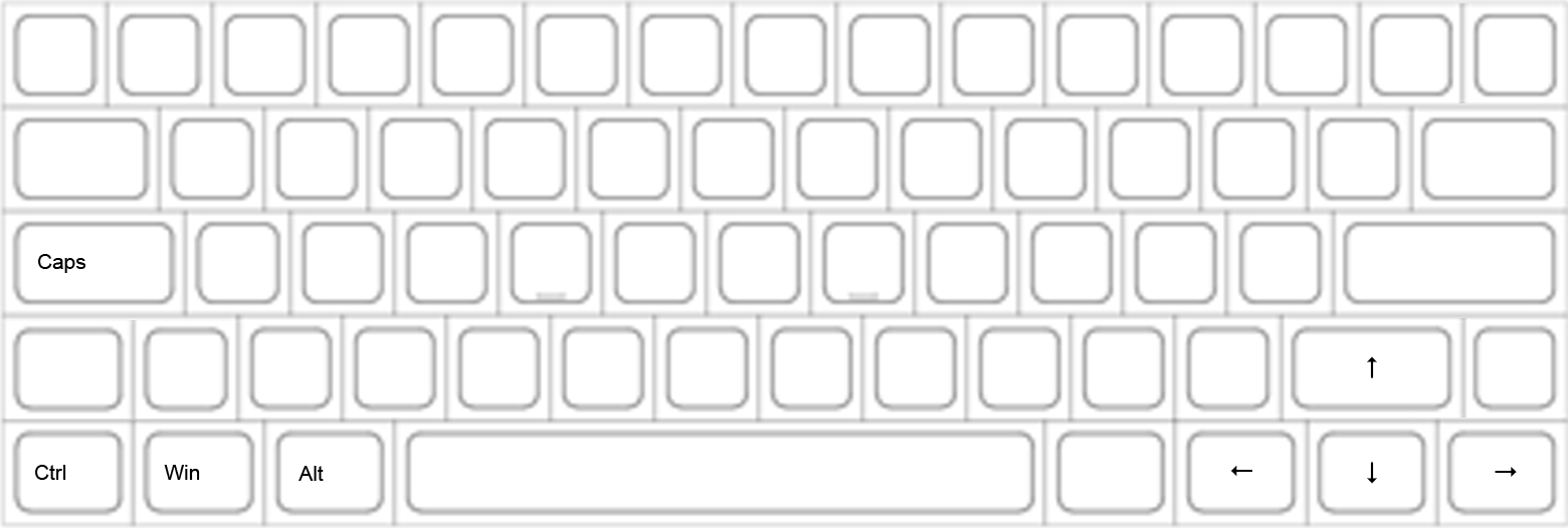

« Reply #569 on: Mon, 05 December 2011, 07:07:28 »
Here is my revised layout:
Default Layer
Layer 1
Layer 2
Template for WASD

« Reply #570 on: Mon, 05 December 2011, 09:18:19 »
Quote from: TheProfosist;464385
Default Layer
You have a dedicated caps lock key on your default layer where the Ctrl key usually is? I am kind of surprised since I know personally I rarely use it which is why I don't have it on the default layer at all. But maybe that is just me, since I am used to only holding shift to type 3-4 cap letters when necessary. Based on your layout I thought you would want a second Fn key there so that you could one hand change your audio levels / media.

his FN is next to the left shift, so he has that key free

« Reply #572 on: Mon, 05 December 2011, 09:25:14 »
Quote from: bloodygood;464432
I dont use caps that often but I do often remap it to do things like press to talk in vent also I already have a Fn key on the left side.

« Reply #573 on: Mon, 05 December 2011, 10:04:18 »
You can always throw in a random F13 or something in its spot, makes it more hotkey friendly

« Reply #575 on: Mon, 05 December 2011, 10:18:44 »
Quote from: ishtob;464473
I still kinda want it as Caps also though so no worries plus the layout is not only for me.

« Reply #582 on: Mon, 05 December 2011, 11:53:22 »
your just differs from mine in the right shift, where you only have 1 key. I'm trying to get a universal PCB done so you can do that and I still need to pull up my old poker pCB to measure out he right shift location

aite, made some progress during study breaks on the dox... i got the offset caps and the modifier row done, problem at the moment is that I cant do a lon oval shape with the PCB software i'm doing, so all the offset modifiers would need to have the centerpost drilled by the user, good news is all LED should still work, even the caps (I setup a second LED spot there so that the LED would still be roughly centered. it also incorporates all the stuff you guys want except for 2 things:
- 7x space bar that the 1.5x modifiers row uses
- the ISO short shift that profosist requested
currently it will work with either plate mount or PCB mount, again holes would need to be drilled for the 1.5 modifier row
