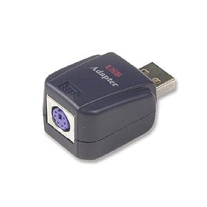

Will this keyboard work with a PS/2 adapter?
The USB code is from PJRC for now, and conforms to the keyboard USB Boot Spec - i.e. the computer sees it as a regular, normal USB keyboard.  Real PS/2 adaptors should work, as far as I know.
Do u have any proof that these "real PS/2 adaptors" actually exist and where could I buy one?
Ppl keep talking about them but its like the Loch Ness Monster, everyone "knows" they exist but there is no proof.
I have already wasted many hours looking and I found lots and lots and lots of cheap adaptors to adapt a PS/2 keyboard to work on USB.  They are really cheap.  But trying to adapt a USB keyboard that is hostile to PS/2 seems like it is impossible. I am not saying it is electrically impossible, just saying that AFAICT nobody sells such adaptors.  Either they never existed or they sold out long ago.
  Passthrough adaptors (what the cheap ones usually are) almost certainly won't.  I haven't tested either.
I was already told they won't work.
When the teensy controller gets upgraded to work on both USB and PS/2 like the controller in WASD, Rosewill, Filco, etc. etc. ad nauseum then I will happily buy 3 Ergodox and pay someone to put them together for me.
I might buy a 4th one to give to one of my friends who have hand pain.
Thanx  :)
How about the famous blue cube adaptor? Works great with both my Model M and Kinesis Classic.
You are saying exactly what I have been saying over and over and over and over and over and over and over and over again for 10 years.
You can easily connect a PS/2 keyboard to ANY computer using a simple cheap adapter.
But you cannot connect a USB-only keyboard like Ergodox to a PS/2 computer.
So if you are only going to support one standard in your keyboard controller it only makes sense to support PS/2.  Because as you showed, your blue cube adapter will allow it to connect to a computer that has its PS/2 ports amputated.
Of course, supporting both adds zero to the manufacturing costs so there is no reason not to support both.  You downloaded your free opensource USB controller software and you can download some free opensource PS/2 controller software too.

@TC:
There are both layer shift and layer lock keys on the default QWERTY layout.  And if you don't like where something is, you can always reassign it anywhere you like.  Please read the documentation, it took a long time to write.
As far as footpedals go, they're entirely possible - but they'd be DIY.
As for PS/2 support:  The USB portion of the code is from PJRC.  I haven't had time to rewrite it myself (though, I think the original author did a pretty good job).  I know of one or two other libraries I could have used, but they looked harder to work with, and none of them supported PS/2.  The rest of the code I wrote myself, in my free time, for free (and fun :) ).  Please don't ever tell a developer that (to paraphrase) they downloaded their free open source code, and they really should go downloaded a different one.  It's quite a bit insulting.

I apologize if I did not word things well.  I'm dying.  I'm on hardcore drugz. I am wiped out tired.  My POS Rosewill keyboard keeps flashing lights at me and doing freaky things (like eating my keys or making the alt key get stuck even though I never pressed the Alt key in the first place, etc.)  Its hard for me to concentrate tbh.  I am really sorry.  I didn't mean to be insulting.  :-[
Thanks...  I'm sorry too.  I guess I'm a bit touchy at the moment, probably because of some of the more heated discussions that happened over on DT a little bit ago.  I should have been more patient :/
I didn't mean u should replace the code you have.  Your code obviously works so no need to change it AFAICT.  I just meant that there surely must be free PS/2 controller code floating around somewhere that could be added in, in addition to the USB code, given that PS/2 has been around for 30 years (or however long, I think PS/2 is actually just a shrunken DIN5 which has been around way longer than 30 years).
I have a vague memory that I saw a PS/2 controller somewhere... it was probably on opencores.org
I will offer you a $200.00 bribe  :)  but u can call it a bounty :) to add PS/2 support to the controller.   I am sorry that I cannot offer more but I don't have an ergodox, and there is no guarantee that I will ever get one, or that   it will really and truly allow me to begin coding again.  Also if I get an Ergodox it might cost a really HUGE amount of money to pay someone to put it together for me.  Nobody has actually offered to put it together for me at any price.  I absolutely cannot ever build one myself.  I can barely sit in a chair and shove the mouse around.  No way I can do anything more complicated than that.  But I can send $$$ with AmazonPay.
Your bribe (*cough* bounty, lol) is very generous :) .  And if it really means that much to you, I'd be very tempted to do it for free, if I could.  Unfortunately, my main problem is that I don't have *time* :/ or enough domain knowledge to do it quickly.  This weekend I have work, the next two weeks I'm visiting my grandparents (who I can't very well neglect, lol), and for most of the next few months after that I'll be back in school...  And as I've never dealt with PS/2 before (or USB, for that matter, which is why I'm still using a library), or many of the Teensy functions a PS/2 library would be using (interrupts and timers come to mind), I don't think my chances of success in any reasonable amount of time would be good.  In fact, I had an experience not that long ago trying to integrate code I didn't have time to understand when I tried to get mousekeys into the firmware.  There's a nice library for making the Teensy emulate a mouse, and lots of other people have done it - but I couldn't figure it out at the time, and I still haven't had time to go back and make it work.  So, I'm sorry... but I'm sure you can understand.
That being said, if anyone else wants to try, my code is up on github (though the unstable branch is in the middle of somewhat of a rewrite), and I'll do my best to help you out where I can.  I also found this project, which might be worth checking out.  More searching might turn up something better.
In the meantime, I was able to find an active USB -> PS/2 converter :) .  It's crazy expensive, and it only has one (very bad...) review... but lol, at least it's proof they exist :) .
If it doesn't even work then it doesn't exist. :)
I like how it says my brand new Intel core i5 is a legacy system  :))
I don't really know how the USB protocol messages work but reading some msgs from guys who do know, they said it would be really complicated to make a working active adapter like that.  It is really just better to buy a keyboard that is compatible with USB and PS/2, like Filco, WASD, CoolerMaster, Rosewill, etc.
