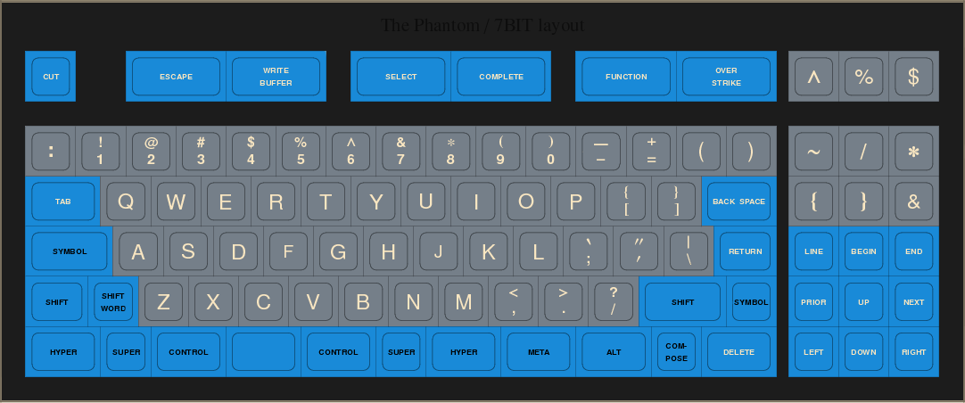

Just looked at something
This is 7bits original layout
and this is the one after the pcb update
Can I still align the left shift like the original. I should be able to as this is how it is on ISO layouts but I want to confirm this.

Any word on this or is the PLU case will match up?

We will need someone with a Filco and a PLU to confirm that they are exactly the same.  Otherwise treat them as different and incompatible.

I sent a pm to dux about the dimensions your requested any idea on my 7bit layout question?

Phantom supports normal ANSI and ISO layouts and 7bit's layout.  We currently only have 5 layout designs for plates: ANSI and ISO with 1.25x modifiers, ANSI and ISO with 1.5x modifiers, and 7bit's layout.  If your layout can't be done with one of these 5 plates, it is not going to work.  So if you want 7bit's front row but a different configuration than 7bit's layout for the other rows, I don't they it is going work.

« Reply #438 on: Fri, 25 November 2011, 10:36:55 »
Quote from: TheProfosist;458795
You can put a 1.25 units key on the key left of (left-)Shift and a 1 unit key on the Shift key. But there will be gaps and yur Shift key will exceed to the left a bit (1/8-th of a key).
Quote from: 7bit;458922
Then how does the ISO layout still work? as that row should be the same as that minus right shift
I have ben told the plate is the problem. Why did you choose to not put the Left Shift where it is on a ISO layout?

Quote from: TheProfosist;458938
7BIT layout is not ISO (1.25 Shift followed by 1 unit < >) and not ANSI (2.25 units Shift).
One way would be to make a long hole to have the opprtunity to mount the 2 switches at nay position you like. The clips whoich hold them on the mount plate are on top and bottom, so this should not be too much of a problem, but I'm only a layout expert, no mountplate expert.
Quote from: TheProfosist;458954
Because I prefer to have a larger Shift key. The other key serves as Shift Word which in emacs just holds shift until I hit space or return. Also, the whole thing becomes a little bit more symmetric.

Plate layouts added to the second post in this thread.

« Reply #443 on: Fri, 25 November 2011, 15:37:54 »
Quote from: litster;459014
^^^ This is not 7BIT layout!!!

« Reply #444 on: Fri, 25 November 2011, 16:12:15 »
Please ask PrinsValium to update the 7bit plate.

« Reply #445 on: Fri, 25 November 2011, 20:31:30 »
PH7BIT updated in 2nd post.
