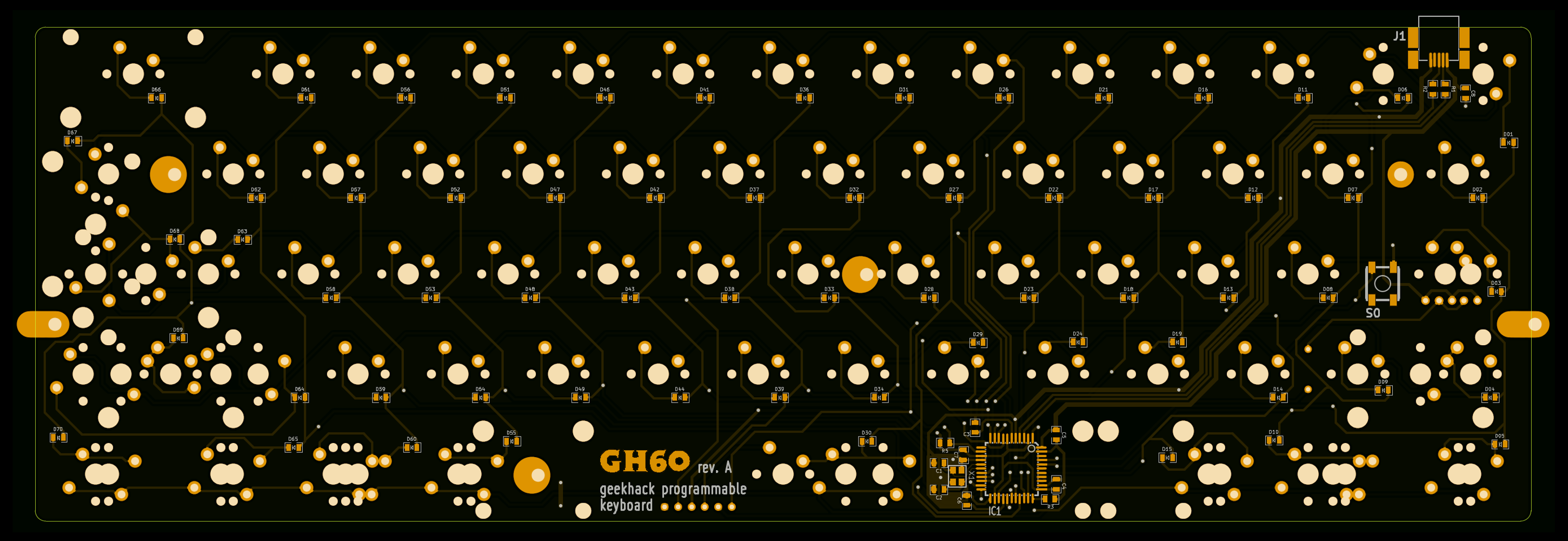

1. Komar007 designed the PCB and is having them printed. He has had a prototype run done, which is being distributed for testing. Once that is tested, and the final revisions made, the GB will proceed.

Ever wanted your Poker/Pure to have a programmable controller? Did you love the different layout options of the Phantom, but wanted it in a smaller form factor? This is a 60% form-factor Geekhack custom keyboard that will be somewhat similar to the Phantom, but it will not include the function row, cursor arrows, or insert key group.
- Includes support for programmable layers.
- PCB populated from factory with all electronics, including diodes and ATmega32u4 programmable controller chip. Only switches will need to be sourced and mounted. Support for PCB-mount switches.
- Support for Poker/Pure cases, including aluminum cases from imsto, oneproduct, or treble318.

The ATmega32u4 controller chip
This is the same chip as on the Teensy2.0. It is a 16MHz 8-bit AVR from Atmel.

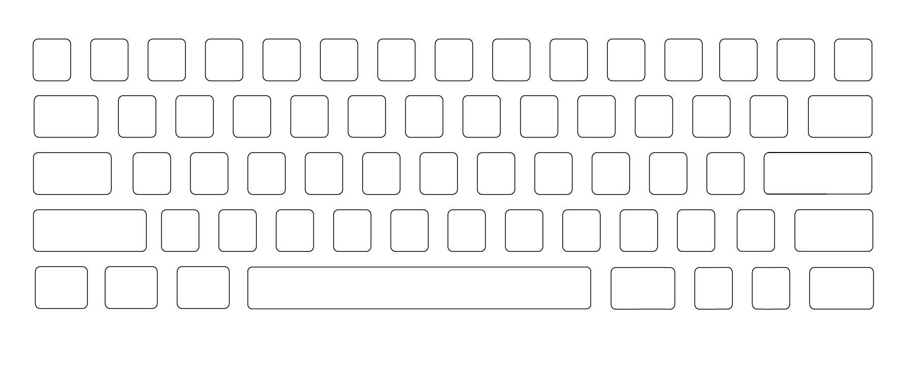

Images of some possible key layouts:
ANSI ("KBC Poker"-style)
ANSI w/1.50 mods
ANSI winkeyless
ISO
ISO w/1.50 mods
ISO winkeyless
"HHKB"-style
ISO "HHKB"-style
"KBT Pure"-style
IvanIvanovich's custom
TheProfosist's custom
samwisekoi's custom

Where are you going to fit the teensy?  It will NOT fit between the PCB and the plate... and then there's the cable routing issue.
Filco w/ Imsto thick PBT
Re: [Final Prototyping] GH60 Keyboard
« Reply #4 on: Fri, 24 August 2012, 21:53:43 »
Underneath? Is that where the Teensy resides on the Dox?
I don't think it will be too hard to route the USB cable. We could get treble to make a hole for the Teeny reset switch instead of the DIP switches, and design some kind of channel for the USB cable.
« Last Edit: Fri, 24 August 2012, 21:55:49 by jdcarpe »

If I recall correctly it was top-side under the space bar, no plate.

We could, of course, forgo the Teensy and go with an onboard controller. But I like the idea of using a Teensy, if possible, since we know quite a bit about the programming.

Well, the obvious answer is just do it SMD w/ integrated controller and have the fab take care of it  :)

« Reply #17 on: Sat, 25 August 2012, 03:25:16 »
What software is people using to generate those layout schematics?

« Reply #20 on: Sat, 25 August 2012, 06:15:21 »
If you mean the plate design, it was originally done with CAD software. That plate image is a screenshot, I think, of the PHANSI plate that I grabbed from another thread, then modified in Paint.
For the key layout, I used Hazeluff's Dox template image, again grabbed from another thread, and modified it to my needs using Paint. I don't know how Hazel made the original.

« Reply #21 on: Sat, 25 August 2012, 06:42:20 »
My layout thing came from WASD. Its derived from the template you use to submit custom legends.

KiCAD is the most common choice here to do the  PCB layout, and bpiphany was kind enough to put together a library of keyboard footprints that include a drawing layer that has the proper measurements for plate cutouts.  KiCAD is capable of rendering this layer as a DXF file.

So does this sound like a sensible plan? Produce a Phantom 60% board with layout options for ISO/ANSI and 1.5/1.25 mods on the PCB. Only one plate, which would reflect the design I posted in the OP for ANSI with 1.5 mods.

Offline komar007
  • Posts: 712
  • Location: Poland
    • komar's blog
« Reply #44 on: Sun, 26 August 2012, 13:16:22 »
I'm interested!
In fact this is exactly what I've planned on doing for a long time, but couldn't quite get down to it.
I'll contribute whatever is necessary: electrical design, programming, etc if someone makes this happen.
I can also contribute my controller software (teensy-compatible) with nkro support. It basically needs good layer support and PC-side layout designer, not much work to be done.
And I support the 1.25 modifier idea. I was thinking about putting 2 Cherry MX locks between alt and ctrl on the right side which would enable choice between 4 different layers or settings, etc. which you could change by pressing/depressing the keys.
