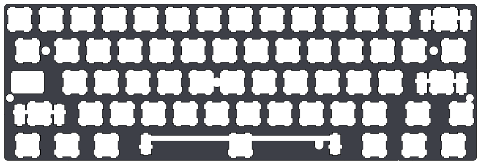

Offline IvanIvanovich
  • Mr. Silk Underwear
  • Posts: 8196
Re: [Final Prototyping] GH60 Keyboard
« Reply #1523 on: Thu, 21 February 2013, 14:57:24 »
I have still yet to assemble mine, because there was delay from miscommunication with what needed to be assembled smd wise for me. But I should have it soon and my plans are to test my ideal layout with it of course:
sorry for the awful mock up, I made it with mspaint while I was at work one day.
Black is default layer, red is layer 2 and blue is layer 3 embedded numpad activated by fn+n on layer 2 hopefully I can manage to figure it out to work that way.
« Last Edit: Thu, 21 February 2013, 15:00:03 by IvanIvanovich »

Ok it took me a lot of time to draw these up, so here are the 9 possible plates so far. It's possible to have hybrids of any of these, but I don't imagine those would be as popular. The PCB currently does not support split backspace, but if komar confirms with me he's added 2 more switch locations for the backspace, then I'll adjust the plates accordingly or add on more. Only poker and pure layout will need 1 more additional hole for the capslock LED.
ANSI 125 (standard poker layout)
ANSI 125 - Pure (standard PURE layout)
ANSI 150
ANSI 150 - Pure
ISO 125
ISO 125 - Pure
ISO 150
lysol's layout
samwisekoi's layout

Nice!!  :D :D :D
ISO 125 Pure is looking all kinds of perfect!!

Hmm, will no plate support a 1u key to the left of a 1.75u right shift?
Is it possible to modify for example the ISO 125 Pure plate to support both, the 1u key to the right or to the left of a 1.75 right shift?
Maybe instead of the two 1u holes, expanding them each to the left, like the caps lock hole could work? I'm nowhere near being an expert at this like you are, wfd, just throwing in ideas :D But like that it would perhaps be possible to support both layouts?
Or maybe even a very big hole, beginning right behind the ?/ key, and ending at the right edge of the plate?
The other ones look nice, though!
« Last Edit: Sat, 23 February 2013, 06:09:25 by multipla »
Offline WhiteFireDragon
  • Posts: 2276
    • youtube
« Reply #1535 on: Sat, 23 February 2013, 06:36:54 »
That 1x key left (instead of right like pure) of the small 1.75x shift actually is possible, I just haven't made a plate for it yet. If I make all plate possibilities, including hybrid plates, that's just too many options. I can still add in a plate with what you requested, but not sure how many people are interested in it. The reason being for that layout is that majority of people will not have long enough R-pinky to stretch that far. You must have long pinkies haha.
I've already considered the solution you proposed, but making it long like that capslock will come at a compromise. All 4 switch holes in the PCB at that area have 90degree rotated switches there, so if there is a stretched hole on the plate, one of the plastic locking clips on each of the switch won't be able to clamp down the switch securely onto the plate. That's not a problem on the capslock because the capslock is not a rotated switch, so both top and bottom plastic clip can lock onto the plate. It's possible, but just won't be a fully supported switch by the plate. It won't be that big of deal if you use PCB-mounted switches, so I might add this back on there.
Hopefully that makes sense.

Okay, I understand. And yes, I use PCB mounted switches, so that really shouldn't be a big deal, if there's enough interest in plates like this.
If there would not be enough interest, I could also buy a normal ISO 125 Pure plate and cut the piece between those two holes out, and also cut a bit to the left, couldn't I? Those two switches then would not be plate mounted then, but if I use PCB mounted switches even that shouldn't be a problem I think. Well, we'll see what will happen.
Thanks for doing the plates!

multipla, I didn't post this plate at first but here is a "universal" ANSI plate that supports what you wanted. ISO can be done in the same way. This  plate allows you to change the whole keyboard layout by desoldering/soldering of only a few switches, rather than desoldering everything and swapping plates.
Requirements for this plate
  • Backspace, R-shift, and 7x spacebar must use PCB-mounted cherry stabilizers, no other option. All other stabilizers (Enter, L-shift, and 6.25x spacebar) still has the option of using all 3 stabilizer types (costar, PCB-mounted and plate-mounted cherry)
  • You must understand layout and spacing well enough to mount the switches during soldering since the whole bottom row and a few other keys don't provide 100% specificity in switch locations.

Wow wfd, that plate looks cool. Want!
And it really looks a bit complicated, but it even would support the split backspace if the PCB will support it, perfect.
I'm looking forward to buying one of these in ISO Layout.

That's a really versatile plate design!  I would recommend using PCB mount switches in any of those siamese holes to make sure the switch is square to the rest.
