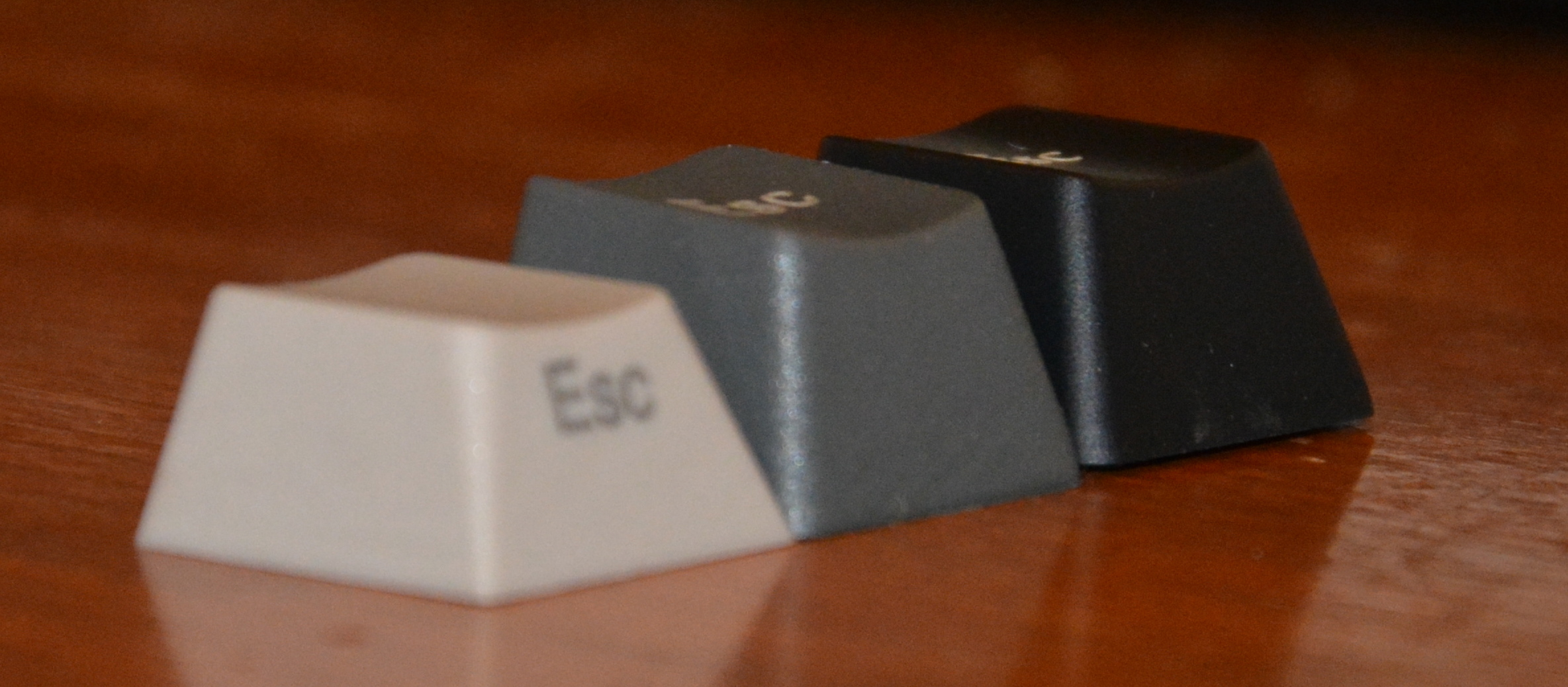

Materials:
ABS and PBT (and POM) are different types of plastic.
ABS - smooth and dry feeling
PBT - textured and dry feeling
POM - smooth and wet feeling
(correct me if I am wrong on anything)

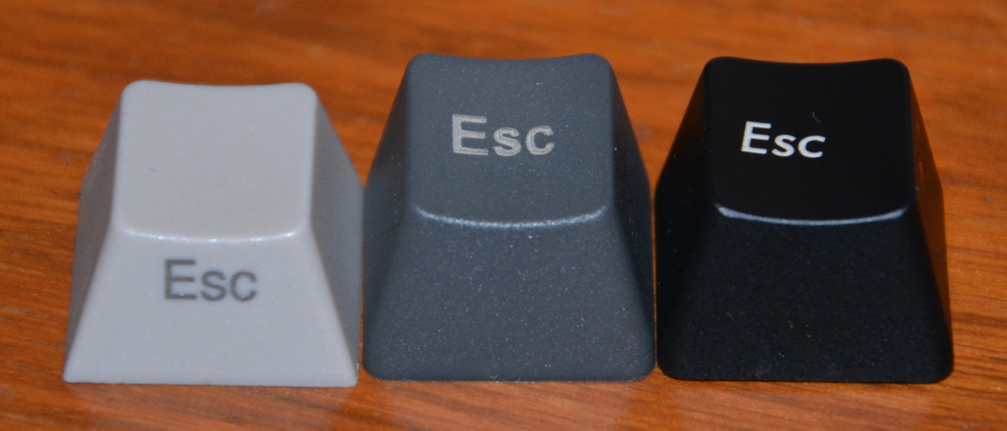

Standard Profiles:
OEM - Stands a little taller (Filco stock keycaps for example)
Cherry - Is more low profile than OEM
Cherry, OEM, OEM
50592-0

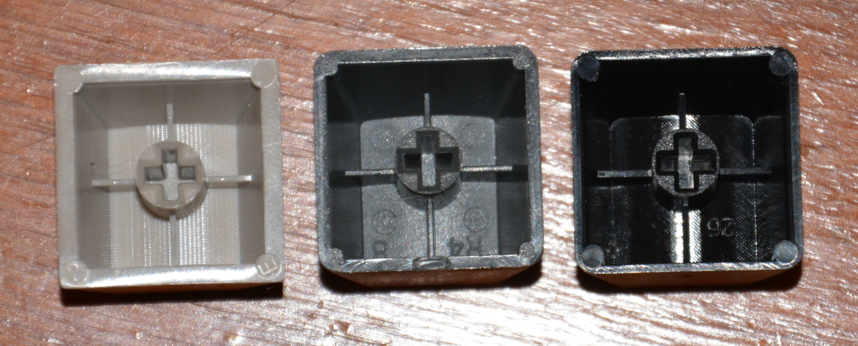

Thicknesses:
Thick - Some DS and Thick PBT
Medium - Some DS and Medium PBT
Thin - Some DS and standard caps
Thick PBT, Medium PBT, Stock Filco
50594-1
Legends:
Doubleshot (DS) - Legends are one shot and rest of the keycap is another (basically), so the legends will never wear out.
Dye sublimation (Dyesub) - I believe it is done by masking and dying the keycap or something like that.  it wears pretty well.
Pad Printed - Printed on top of the cap, it wears off pretty easily.
Laser Etched - The legends are etched out out of the cap, you can feel the legends under your finger.  Can fade, but relatively permanent.
Engraved - Material is removed to create the legends and there is usually not another color introduced.  Permanent, but can fill with finger oil.
DyeSub, Laser Etched, Pad Printed
50596-2
« Last Edit: Sat, 11 January 2014, 10:34:43 by swill »
