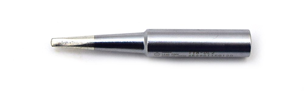

And one more question. Last time I used my soldering iron to solder (I've been having the same issue with de-soldering), it didn't want to melt solder quickly whether I set the iron to 350, 400, or 700. I would have to hold the iron to the solder point and pin for ten seconds or so before I could melt the solder. Did I manage to oxidize my tip? It looks fine, nice and silvery.
I'm using a Hakko FX888D, but I'm a soldering noob. I've been rather discouraged about using it, because so far all I've managed to do is lift a couple pads when I tried to de-solder my Filco numpad (which had the same bent pins as Berserk is dealing with). I also had trouble de-soldering a couple switches on my JD40.. my solder never wants to completely de-solder. There's always a little bit left no matter how much I try to get it all with my Soldapullt.
With Hakko FX888D, it should be melting fast. You can try to figure the tip if it was oxidized? If it is, you can fix it with sanding and re-tinning it. If it is not, you can also consider to use a Hakko Chisel tip 2-3.2mm if you want the best heating. The default Hakko conical tip is very bad on soldering Cherry MX switch because it is too small.
http://www.amazon.com/Hakko-T18-DL2-Chisel-22-5mm-FX-8801/dp/B00762AHHQ

Going to be doing my first ever SMD soldering (diodes and resistors). I need some advice:
1. I have an Edsyn 951sxe with the standard medium tip. Do I need to purchase a different tip or will the medium one work well?
2. I currently have 63/37 .031" solder. Do I need .020"?
3. Flux. Do I need some (outside of what's in the solder)? I am not going to be soldering a controller from my understand, and I believe this is where flux is needed most.
4. There seem to be about 1000x ways to smd solder on youtube. Does anyone have a video they would recommend?
Offline mkawa
  •  No Marketplace Access
  • Posts: 6562
  • (ツ)@@@. crankypants
Re: The Living Soldering Thread
« Reply #2675 on: Fri, 05 June 2015, 15:05:15 »
copying my response from pm:
for resistors and diodes, the included 1.6mm chisel tip is a good choice. what you want to focus on is making sure the pad is wet before you place the component onto the board. for example, for an SMD resistor, you will put a tiny tiny solder ball onto one of the pads, then in one hand use a pair of tweezers to position the resistor onto the board and the other to re-melt the ball onto both the solder pad and the resistor. with the resistor now held in place by the one joint, solder the other joint as usual.
1.6mm is especially nice for this because ~1mm tips tend to be conical instead of spades. you want to use the spade part of the tip to apply heat to the solder ball, pcb pad and resistor simultaneously.
there are lots of good solder videos on line, but i haven't watched most of them. check out eevblog's videos though; he is always 100% dead on with his suggestions and howtos.
the biggest part though is don't be afraid. enjoy!! :)
2. 0.03" is fine.
3. pick up a small bottle of MG chemical liquid RA flux #835. use a dropper bottle to dispense it.
youtube slide soldering for the controller.
remember to enjoy! if you're worried, practice and then don't worry :)
