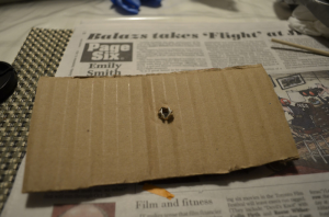

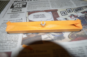

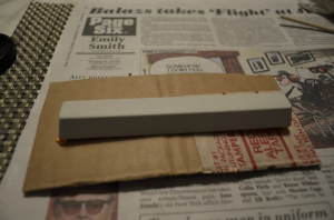

UPDATE: I flocked four keycaps today using the electrostatic method tonight.
I did a DCS keycap and spacebar, and a BS spacebar and keycap. Here's what's different from my last two experiments:
1. Masked the bottoms of the keys to protect against excess coating. (Actually did this for second round, but clumsily.)
2. Primed! (Using the Duplicolor Adhesion Promoter suggested by Photoelectric)
3. Electrostatically flocked.
4. Full coverage on keycaps, no partial flocking this time around. (I'm not flocking around.)
Each keycap had to be on its own cardboard skid because the electrostatic method requires that the grounding pin be inserted in the coating itself. I couldn't coat them all at once because I couldn't ground all the keycap coatings simultaneously. (Although I may commandeer my wife's cookie drying rack, maybe I can rig it up as a larger grounding surface?) So each keycap had it's own little cardboard carrier. I used a pencil to mount the pin, so I could manipulate it better when touching it against the keycap. When I was flocking, it didn't really look very different from the 'puffing' method, but when I 'dusted' the flocking fibers from a decent height (8") they did seem to land on the keycaps with more accuracy than I would attribute to chance, so I think it worked. When I was done, I got a nice spark afterwards, so I know there was a potential being created.
 I hope:
1. The primer will work.
2. The coverage will be more even (no more shallow spots, or less frequent) - electrostatic should help in this area.
3. Deeper penetration (shut up) since instead of the fibers just being 'thrown' at the coating (puffing method) they are now drawn to it.
4. Better coverage on the edges, again, having the fibers drawn to all surfaces electrostatically should improve edge coverage.
If it all works out, then I'll be flocking a case very soon! Boiler and Ray should be getting their keycaps sometime tomorrow -- I'm excited to get a second opinion.

Here are my four 'skids' 24 hours post-flocking. I've very lightly shaken off any excess flock and brought them indoors to cure more completely.

I spent last night taping and sanding and priming this next batch. It's not my largest batch to date (that was the first, flawed "bathmat" batch) but it's a lot of work, and think these are better. First, everything gets a wash, then when dry I tape the spacebars, then sand the exposed areas, then mount them on their cardboard skids. The single units get sanded on all sides (surface is textured already, so not needed) along with the edges and corners, very lightly.
37404-037406-137408-2
After sanding everything gets a rubdown with a moistened paper towel, then a quick dry, and then I mount them to their skids. The spacebars all get their own skid, but I put multiple single units on a skid. This makes priming and flocking them a lot easier, because you don't have to touch the keycaps, you can just manipulate the cardboard.
I notice some other people paint keycaps -- how do you make the keycap stationary while painting?
When it's time for flocking, the spacebars stay on their skids, but the singletons I cut apart. I do one at a time; coat it with the adhesive, and then electrostatically flock, then set aside. That's for tonight. My breakdown is going to be two black spacebars, one sage green, and two in the magenta color, then six BS singletons of each color, and the four DCS will all be the magenta.
« Last Edit: Tue, 01 October 2013, 07:21:17 by Krogenar »
