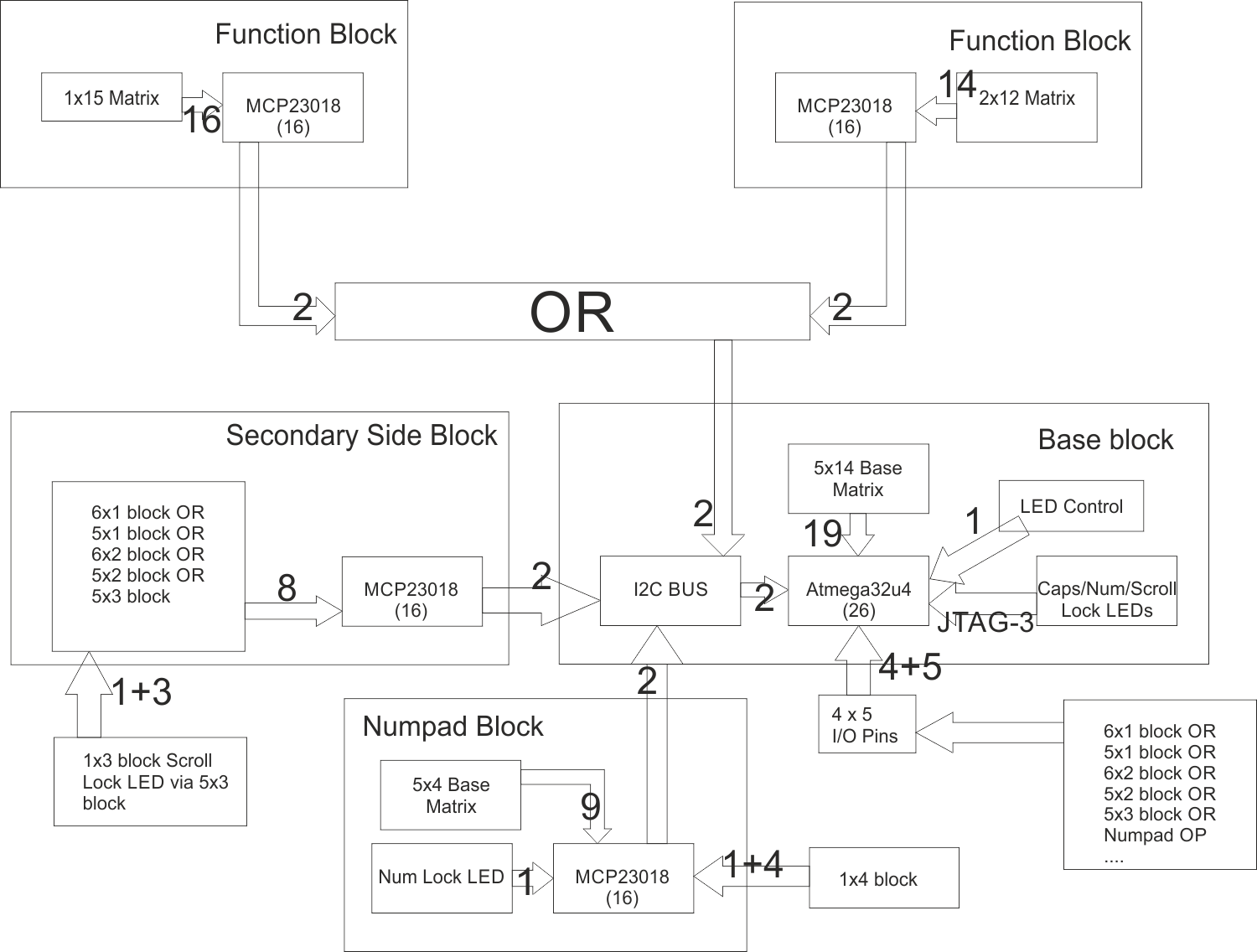

Interaction between blox
This is simple schematic of how things would connect
51924-0
I've started off easy with designing the 3x5, 2x5, 1x5 modules first, I will then move onto the other ones.

Still a lot to do. The two ideas are:
1. Separate controller on each module and some way to have them connected to a base module and recognize each module with a unique ID
2. Base module and then using I2C and I/O controller like the Ergodox.

Hi MOZ,
Before you go too far down this road you should evaluate
the scan rate you'll be able to achieve over I2C. With the
I2C I/O eXpander (IOX) @100kHz in my 5-row switch
matrix I'm only able to complete a scan every ~5.2ms.
If you have 3 IOXs and end up at a 15ms scan rate...
well I don't think that's fast enough. You'll have to see
if you've added too much capacitance with 6 connectors
, 3 cables, and 3 slaves to run at 400kHz - which is the
max that the 32U4 supports.
Maybe you'll end up deciding that the 32u4 isn't an option,
instead opting for a micro with more I2C busses, or more
I/O pins so that you can have one matrix and connect your
blox with ribbons rather than I2C...
Regarding lighting:  The reason to stack 3 LEDs in series
with one resistor is that you might be able to drive all 3
with the same 10mA rather than using 30mA to do the job.
no big deal either way if you only have 3 total, but if you
have 60, then you've used too much current for normal
USB if each is driven individually.
