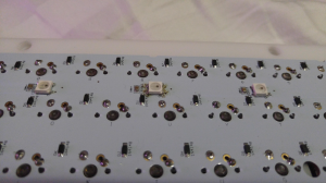

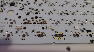

Hey skully, no issues getting that hex on the board, but it seems I've got some issues with my LED soldering.
Here's my current results, mind you LED 2 and 3 were blinking while all others were solid. 136098-0
Close up of LEDs 1, 2, and 3:
136100-1
Close up of LED 11 where the chain stops, I think I fried this spot on the board or something? Not sure, occasionally when I plug in the board this one will blink once very dimly and then nothing.
136102-2
Any advice on what I need to do as far as jumping these guys to work correctly? Or has that ship sailed? Or if you need better pics to diagnose, let me know!

I tried to post a vid from my phone, but it crashed and burned. Anyhoo, I'm running a v2.0 PCB, with Skully's latest hex and I initially had orange LEDs racing back and forth in a marquee effect. Cycling through the modes Fn+S+Spacebar gave me all of the LEDs cycling through the rainbow together. That seems to be the only effect programmed at present, perhaps due to a memory limitation.
Based on your vid, I'd guess that you have either a bad solder joint, or a faulty LED, since these work like old Christmas lights ... when one goes out, it affects its neighbors. Sorry, but the resolution of my laptop screen isn't good enough for me to spot the trouble area.
Best of luck!

If the LED's are flashing when you plug in you can ignore the pin at the corner with a line. You can also ignore the pin kitty corner from that.
Of the two remaining pins there is one that is on the same side as the "previous" LED. That one is the DIN (Data In) pin, and is where the control signal comes in at. Kitty corner from that pin is the DOUT (Data Out) pin. The DOUT on the last working LED should connect to the DIN of the first non-working LED, so check both of those first. If you really have lifted the pad in an unrecoverable way those are the two pins to jumper.
Good luck! You're getting closer to having it all working.

Thanks so much for the info, hopefully I can try to work on it soon.
Darn work is keeping me from putting together my board for work.  :))

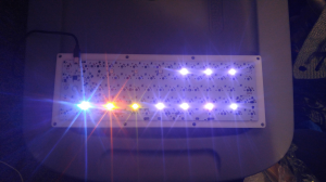

Finally had the time to look at my board, touched up a few of the LEDs and we have light!
Any advice on what to do from here? This is single color mode.

I'm not sure why that's happening. It's possible that you heated them up too high or too long. What temperature is your iron at?
I'm pretty confident they're otherwise soldered correctly, as the rest of the string are lighting up properly.
