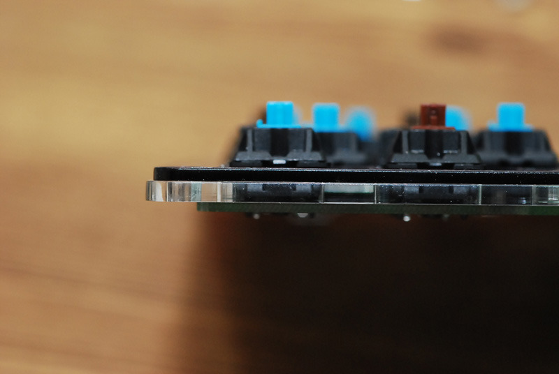

If it is a 5mm polycarb plate with stabilizer cutouts on the underside I would also be interested in a PC and alum plate. But if its a 1.5mm PC plate that will be pretty flimsy.

5mm polycarb plate would likely need to have some bits CNC'd to 1.5mm, which would probably make that a weak stress point.
Look at how the plate mounts to the middle piece:
https://geekhack.org/index.php?action=dlattach;topic=83590.0;attach=143238;image

Trade off I guess, flimsy plate or plate with weak points... actually dont think I would want a PC plate after you pointing that out.

I think the PC plate should be a 1.5mm~~ (not 5mm) partial plate.  This is to allow for the PCB switch feel while allowing the mods stability.

You cant just have your PCB hanging off a 1.5mm PC plate with an air-gap, especially a partial plate. Its not strong enough.
Theres a reason why WKL and GON have another layer between the 1.5mm plate and the PCB..

I assembled an octagon with just a 1.5mm polycarb full plate.
I agree with the other layer thing though, was planning to make one of those actually.

Guys, it will be a 1.5mm pc plate. Because it have to be the same thickness with the alu plate. Or just make something in between the plate and pcb.
The cost will be 15 usd. moq still 10.
