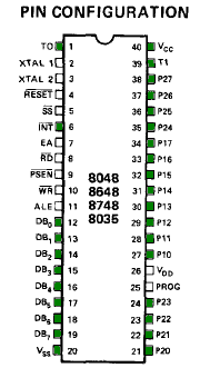

« Reply #494 on: Fri, 21 September 2012, 09:00:31 »
Well I'm not sure that you have totally wrecked them, unless you think you might have applied power backwards at some point.
The keyboard's output buffer chip is available, cheap, and only 14 pins so relatively easy to desolder. Testing it is tricky without either removing it or using an oscilloscope though, so we should try to eliminate other possibilities first.
Measuring the current seems to be a reliable way to tell if the board is wrecked from backwards power being applied. Normally the keyboard would draw a little over 100mA, but significantly less when dead.
(I say seems to be, because it's only been measured once on a dead board, and there were other factors perplexing me about that situation, as you'll see in the conversation there with Paranoid. However, reduced current draw is logical for a dead board).
Of course, it's still worth doing the sanity check on power and ground first, which will confirm that they are correct all the way through the chain of connections.

« Reply #496 on: Sat, 22 September 2012, 08:43:40 »
OK. I'm sorry that this hasn't gone as smoothly for you as it did last time.
Trouble is, we don't know how much gets damaged by reverse power. Almost certainly the CPU - they are available, but would need programming, and it's quite a task to desolder. If I get round to writing the code, replacing the CPU with a Teensy could be an option.
The big worry is that it damages the square silver capacitive sensing chip, which isn't available (except in old IBM keyboards). I'd like to get hold of a damaged controller to be able to find out whether it dies or not.
