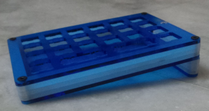

Blue and white case:
38076-0
38078-1
Notes:
- This post in general: http://geekhack.org/index.php?topic=48007.msg1068449#msg1068449
- So, yeah, I am not happy with how some of the engraving turned out for the bolt holes, and in the final version, when we do it, I will replace it with the method described in the post linked above. I will have a sample for that before we get to that stage.
- Red top and bottom were virtually unusable and will be cut again, this is also described int he above post.
- Due to some technical issues, the smoke case's feet came out with misaligned engraving, sorry about that ray. I ran out of acrylic in that color, otherwise I would have worked something out.
- In the final version, I need to increase the thickness of then thin acrylic wall on either sides of the usb cutout depending on how the PCB fits the case, as it is too thin and flimsy at the moment.
EDIT: the misalignment of the feet in the image above is due to me, not having aligned the feet correctly before tightening the screws.
« Last Edit: Mon, 07 October 2013, 13:34:39 by MOZ »

That "stand" is totally going to break off.  I prefer a simple bumpon.
Offline MOZ
  • KING OF THE NEWBIES
  • Posts: 3977
  • Location: Jo'burg
  • Busy making stuff
Re: GHpad FTW (10-Key Pad for GH60)
« Reply #459 on: Mon, 07 October 2013, 14:09:08 »
Any reason, you think it will break off. It is 5 layers of ~3mm acrylic bolted, I don't think it will break.
I any case, I have 8 of each color (So total of 16, so you can make the pattern of your choice and have extra just in case any snaps), such "feet-strips" packaged with every case.

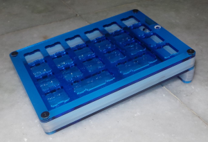

Slight problem with the engraving for the holes, mainly the depth, otherwise, great.

Yeah, not deep enough and some had some misalignment of .5mm due to the slight warpage when acrylic is cut, and I should have mentioned earlier, if you have a drill you can use a 5mm drill bit to create a bigger hole and you should be set for a much cleaner look.

The holes are aligned correctly, so the layers align well; the etched part around the holes on the top and bottom layer is not etched correctly, so the flat head screw doesn't sit in properly.
To fix this, what you need to do is take a drill or dremel with a 5mm bit, and align it so the bit's center is on the center of the screw hole and just drill through or drill half way, as that is all that is required for the screw to sit in.

So in other words the flat screw needs to be countersunk and there is a slight size difference between the top of the flat screw and the hole in the acrylic.

Yes, the etching was to provide the countersinck, but it misaligned slightly and/or was not deep enough.

so the blue case you posted above the screw tops are just slightly raised above the acrylic, is that what your saying is wrong?
Pretty much.

Is there a reason that a normal countersinking drill bit could not be used? In my mind, it seems it would be pretty simple to chase the hole with a countersinking bit if the screw doesn't fit quite right.
Either way, I am pumped about getting the acrylic. Thanks MOZ!
  • Posts: 14427
« Reply #480 on: Tue, 08 October 2013, 09:49:23 »
I'm with ray, I'm not really bothered by those screws. I actually kinda like the look of exposed screw heads.
And I'm sure you could just countersink it whiskytango.

So I'm confused. The problem is that the screw heads don't sit flash with the acrylic, yes? So the proposed fix is to take a 5mm still bit, center it on the hole and drill through/halfway through? If I'm understanding correctly, isn't the problem because the countersunk hole isn't deep enough? How does making the hole wider help?

I can't believe people are freaking out about the countersink not being PERFECT on a prototype
I've had professionally made equipment with elevated bolts due to the same thing and I never cried myself to sleep over it
Besides, increasing the size of the countersink at home is a very simple mod

Yeah, you could just countersink it whiskytango.
My ultimate goal from the beginning was to have the case ready once it was done on the laser cutter, so no other mechanical work needs to be done on it, like countersinking. If I had gone for post-laser countersinking hoels on the top and bottom, we would not have to bother about the exposed screw heads from the beginning and I might not have received the hate mail as well :P

And this is how I wanted it to look all along.

That's amazing.
Can't wait for GB!
