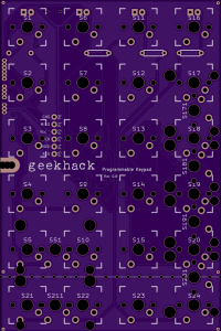

Aww, it looks so plain and unassuming... it needs more holes and stuff... like this one:
39649-0
- 1.27mm headers on left-board edge for ROWS, COLUMNS, Vcc, Gnd and FN/NumLock LED control line (silkscreen on back)
- Adjusted spacing of 'breakway' drills - it's still hardly breakaway, you'll really need to cut it or score it a lot or something
- geekhack silkscreen
- I think I did something else, but I forget what it was
*still need to fix pad interference in the lower left there on S5 and S21... I keep forgetting about that
*might ditch that one mounting slot on the left, I just left it for alignment vs other boards
Offline MOZ

Nice regack. Did you add the I/O expander so we can it hook with the GH60 or something of that kind?
Regaridng the mounting slot, we do need someway for PCB-mounted GHPad, there would be some users that prefer them over plate mounted.
« Last Edit: Thu, 17 October 2013, 14:13:32 by MOZ »

Nice regack. Did you add the I/O expander so we can it with the 60% or something of that kind?
I haven't tried working with the IO expander yet.  Getting that to work will probably be interesting.
I'll add some nicely spaced mounting holes around, but I don't know if we need that slot on the board-edge.
that is beautiful
Re: GHpad FTW (10-Key Pad for GH60)
« Reply #532 on: Thu, 17 October 2013, 14:27:37 »
Awesome job, as always. I would just get rid of the slotted hole on the left and put 4 mounting holes in the obvious locations. And S5 and S21 may just need to be rotated 180-degrees.
Looks like a winner!
:cool:
