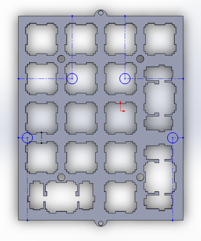

I did this based on standard key spacings, so it should match up with the PCB. I just need USB location and standoff locations if there are any. I suppose it doesn't need standoffs, but then you're forced to use plate-mounted PCB to mount it into the case. Here are some pics of just the bottom case, and one with the bottom piece + plate + brass weight (but without top cover).
This should be able to be placed side-by-side with the other GH60 case and everything should line up. I'll post a pic of what it looks like with both cases together.
http://geekhack.org/index.php?topic=39599.0
Re: GHpad FTW (10-Key Pad for GH60)
« Reply #83 on: Tue, 29 January 2013, 22:31:03 »
May I make a suggestion, WFD? I would love it if you could place the standoffs in the exact positions they are in the stock Poker case. That is, four standoffs, designed to be in the same positions as the two leftmost standoffs and two rightmost standoffs in the Poker case. Theoretically, one could then take a saw to a plastic Poker case, cut out the middle portion, and epoxy the left and right bits together to form a plastic case for the GHpad. That also gives you the location of the USB connector.
Edit: I'm also hoping this design principle will serve as a guide to komar007 when designing the PCB for the GHpad.
Edit 2: Where are my manners? That case is freaking AWESOME! Thanks, WFD!

« Reply #85 on: Tue, 29 January 2013, 23:26:50 »
This wouldn't work. The standoffs can only be at certain theoretical positions because you can't have a standoff hole in any position on the PCB. There will be switches in the way. They keypad has switches that are all aligned, while every row in the stock poker is offset by 0.25x key size. I haven't tried it, but I'm assuming it won't work based on this. Even if it were to somehow align properly, the standoffs won't be symmetrical. You'll have two standoffs on top, two in the middle, and none on the bottom.

Ah I see... so not the final revision PCB that the switches are mounted on. When you get to routing traces, refer to the standoff hole location in the pic below if possible.
Here is my proposed standoff locations, shown by the cut holes. They are exactly between the switches, and symmetric to the PCB/case. jdcarpe, I also drew in your proposed standoff location in blue to show why it wouldn't work. Those are the exact location of the poker standoff locations if you chop out the center of the case. You can see the hole location of the two top standoffs are where switches would be mounted.
